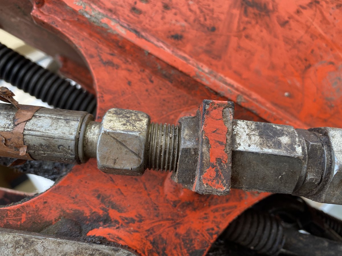

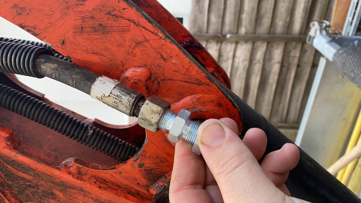

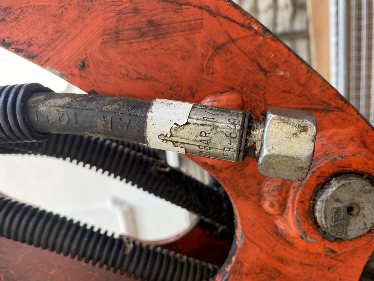

Kubota kx016-4 aux hydraulic fitting size
Anyone know the size of this, ordered 3/4, 1/2,3/8,1/4 none of them metric size?
slightly smaller than 1/2 but bigger than 3/8s

What is the sealing mechanism of the fitting? Cone, O Ring etc?
Mick-the-fitter
Mick-the-fitter
It’s what I do!
Metric 18mm as I remember, the Oring is on a coned end inside the female nut and the male tube has a chamfered inside edge. The KX015-4 uses 12mm, 15mm, 18mm and some I think 21mm fittings.
