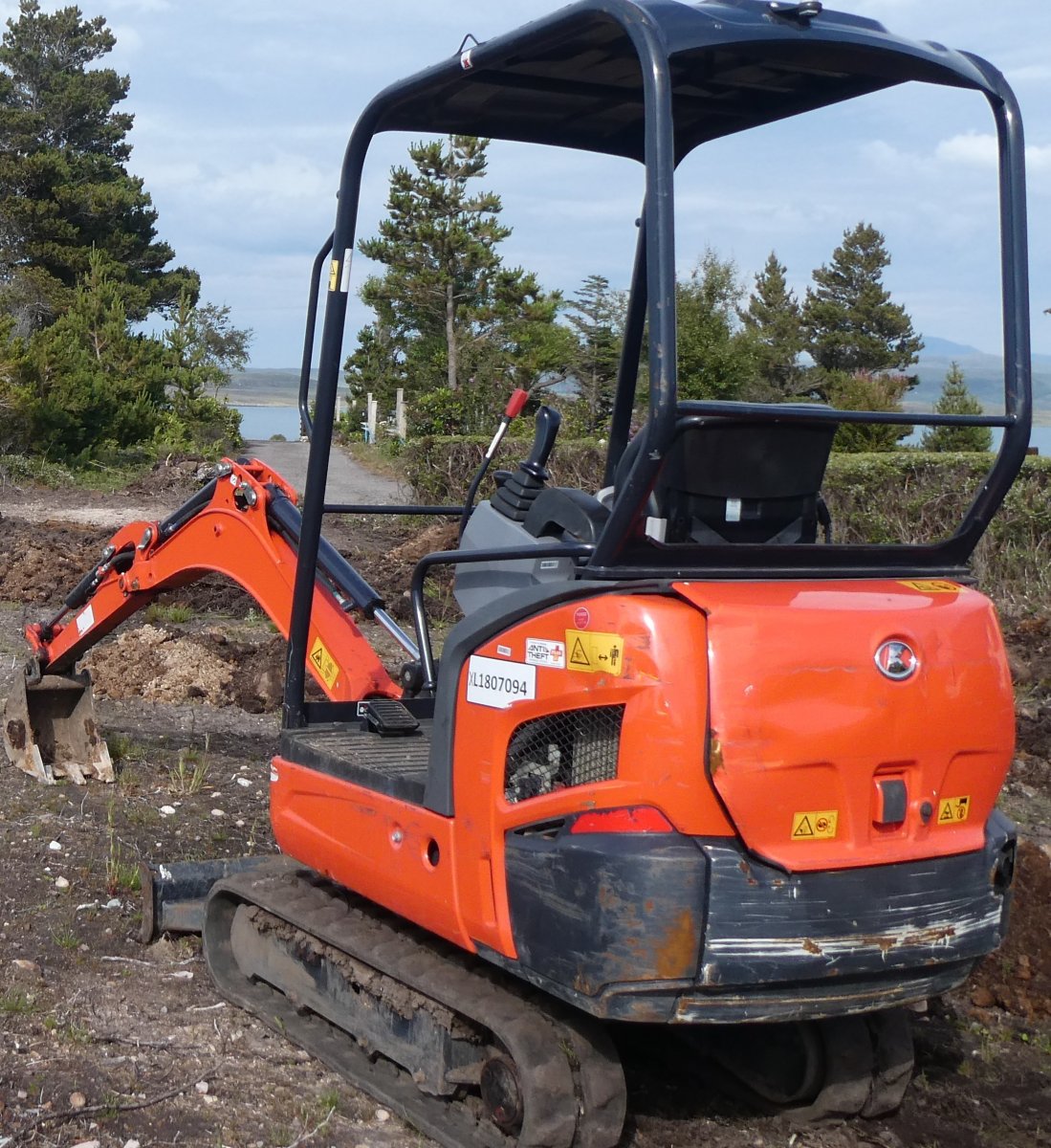

Hi,
I recently purchased a 2018 Kubota KX015-4, 1.5t mini digger which is in need of some paint/TLC.
What is the best way to apply the paint – brush or spray?
Do I need to sand down first – primer needed?
Any ideas on how to get the dent out?
I have attached a photo which may help?
Would appreciate any help/advice.
Would be nice to get the digger back to, ‘looking good’.
Take care.
take the panels off and gently/carefully beat them back out with a planishing hammer on a stake or dolly ... with care you'll get it damned near as good as new (y)

Many thanks for the advice – much appreciated. I am guessing that spraying is better than roller or brush?
T whiting
T whiting
Spraying is best you'll get brush marks if you brush paint it.
Nearly all the panels come off which makes painting and dent beating a lot easier
Get a good coat or 3 of primer on the panels it hides plenty of sins.

Spraying it is then. Good place to buy the paint - https://www.htsspares.com/ ?
Any recommendations on, ‘planishing hammer / stake or dolly’? There appears to be quite a few different ones available for sale.

Never thought of that... considering my skill at panel beating & painting (zero) that might be a good idea.
Pascal
Pascal
I live about 2 hours drive from Inverness. Going there next week – will make enquiries…
I'm guessing taking the panels off is not too difficult?
