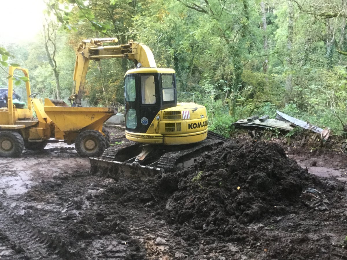

Many thanks for your replies guys. Well yes, it is an old machine - must be somewhere around late 1990's ? We reckon it's definitely the solenoid, as after checking/repairing loads of loom, we realised we'd lost the positive feed to the solenoid. We introduced a new feed from a separate battery & hey presto we had boom up. Unfortunately that was obviously enough to finish off the solenoid - when we took it out, it was soaked in oil & dirt + both wires were bare at exactly the point they pass into the metal body of the thing, so must have shorted out. I've now managed to buy one with the right part no. from Lithuania - aftermarket of course, but a fraction of Komatsu's ridiculous quote ! Even if by a stroke of bad luck, it doesn't fix the problem, we couldn't have left it like that. In answer to the height restrictor question, I assume those are the potentiometers ? They don't work & appear to have been disconnected long ago. According to my friend (the operator) the moniter has been showing error 51 or 42 for the whole time we've had the machine, but it doesn't stop it from functioning. The wiring loom is in a mess, we've tidied it up a lot, but would probably benefit from a complete rewire - just not cost effective on an old machine like ours though I guess. I've got a full workshop manual for the machine & that seemed to indicate that the ECU controller behind the seat would shut down the function indicated by the error code ? but that doesn't appeared to have happened in our case, so I'm a bit confused. The wiring appears to have been messed around with a lot over the years, so I expect some stuff has been bypassed. We won't be back over at the machine until later in the week, but I'll take a few pics & let you know how things went (well hopefully !) & it may just be useful to someone in the future.

Our old Komatsu PC75
