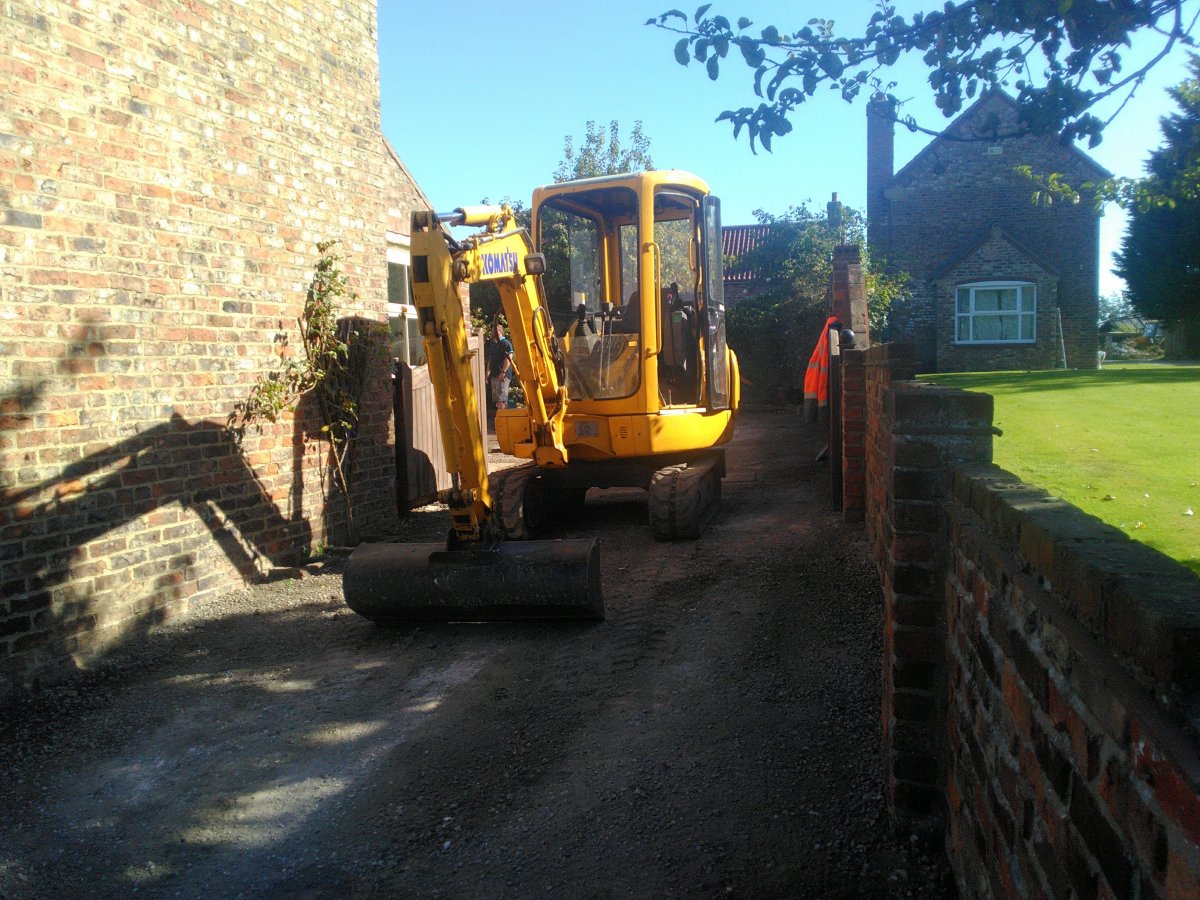

I've got quite a bit of movement on the kingpost pin on the little kommie.
Does anyone know if there's a kingpost bush on a Komatsu pc-20 before I strip it down? And if so where I could get them and a new pin from?

Thanks hopefully it looks like the movement is in the boom base casting and not in the frame but I'll keep you informed when I get time to strip it
evans and reid for bushes and pins Thomas ;)
