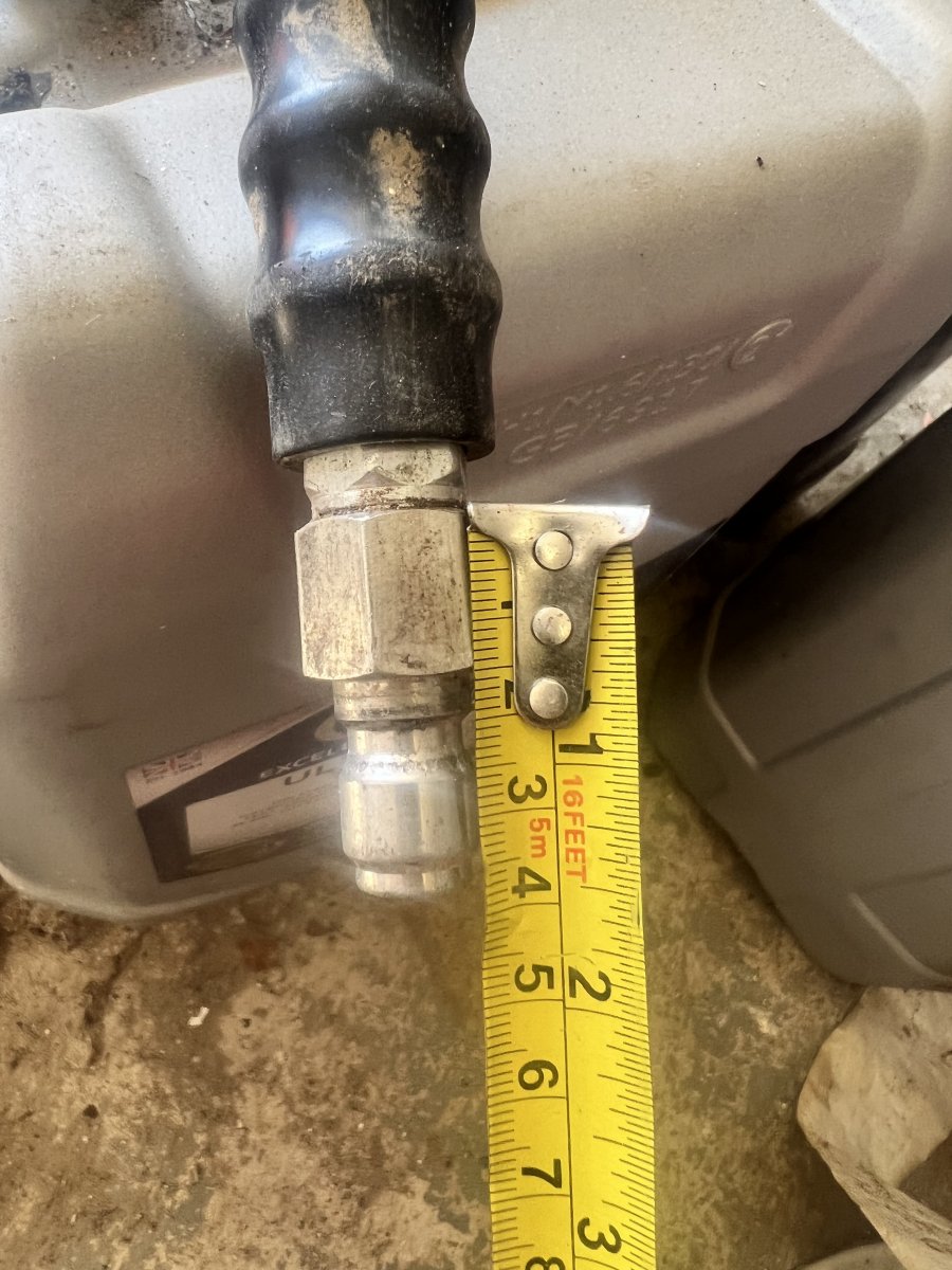

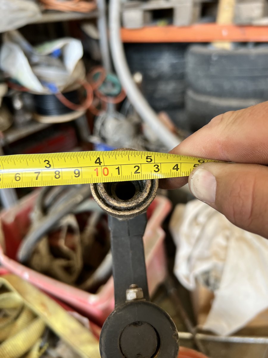

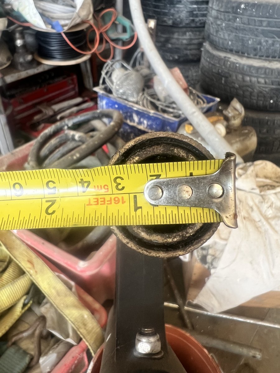

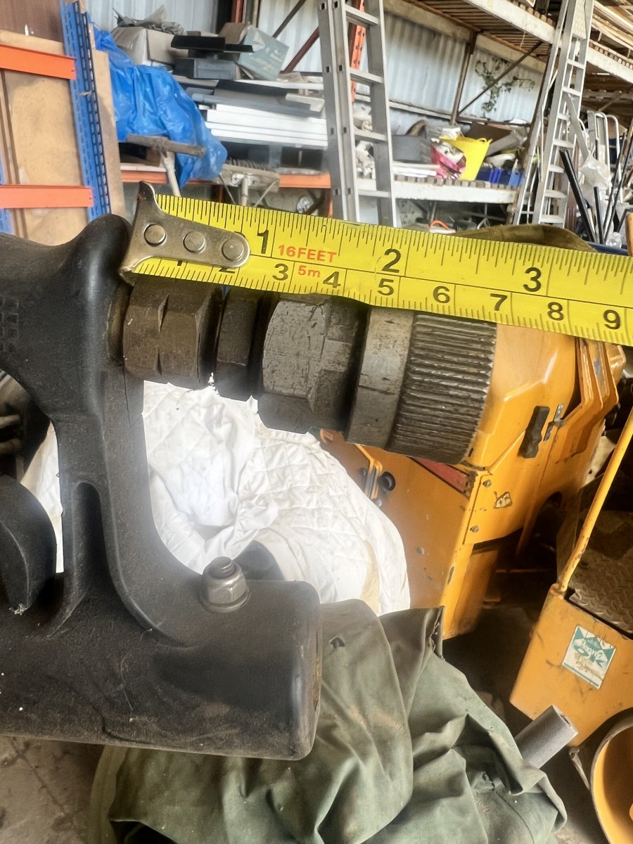

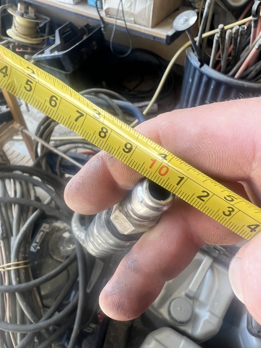

Jet washer quick connect fittings
Bought this rotary patio cleaner out of an auction need to connect it to my petrol washer which is male male on hose
Cleaner head has bigger quick connect
Anyone point me in the right direction

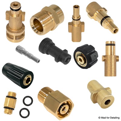

I just can`t remember the name of that style of coupling, but while having a google trying to jog me memory seen these,
Dont know if that helps you :unsure:
There’s two types of bayonet commonly used. 11.6mm and 14.8mm. Any reference to 1/4 or 3/8 generally refers to the thread but Chinese sellers label anything and everything 1/4. Confused yet? You should be 🤣
Search for qwashers on eBay. All good gear, Damon knows his stuff.
I would change your oddball rotary head fitting to 14.8mm and maybe fit a 11.8mm on the lance end to make it easy to swap nozzles.
I would change your oddball lance fitting to 14.8mm and fit a 11.8mm on the lance end to make it easy to swap nozzles.

There is afew places on eBay listing all the connection types. Yours looks like a short Nilfisk type 1/4
