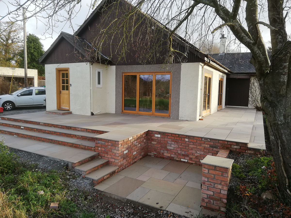

You're absolutely right Gecko - used it for building my patio so its prob only done about 20 - 30 hours in the 9 months that I've had it. One of the tracks came off a while ago so I got my hands on a grease gun to sort that out - maybe the manual will tell me I should be greasing other things too. Thanks again for your help.

:cool: :love:(y) NICE ... did something similar on a house I owned back in the '90s - terraced the patio down to the lower garden level - worked well
