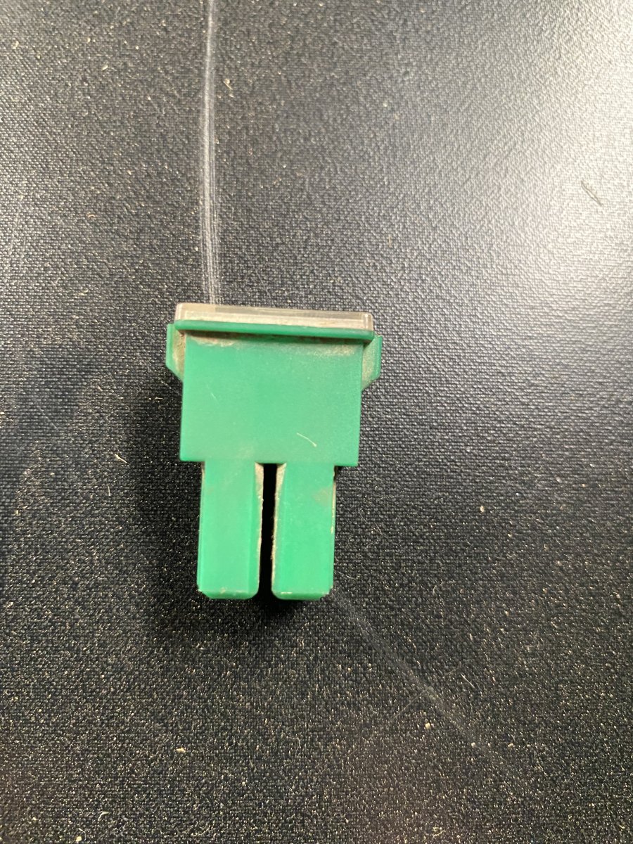

Hello folks. I have a jcb js130
And there's no dash lights or buzzer or monitor screen when I turn the key to the first position
Please help
Steve
As above, start by checking the battery then check supply to ignition which probably comes from the solenoid. Also worth looking for an inline fuse but they are unlikely to blow unless you have a much bigger issue as they are usually the sort of amperage you could weld with.
