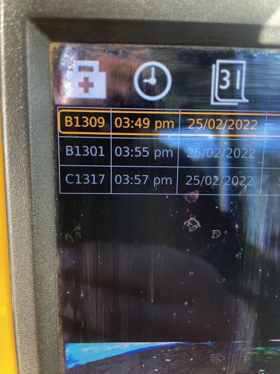

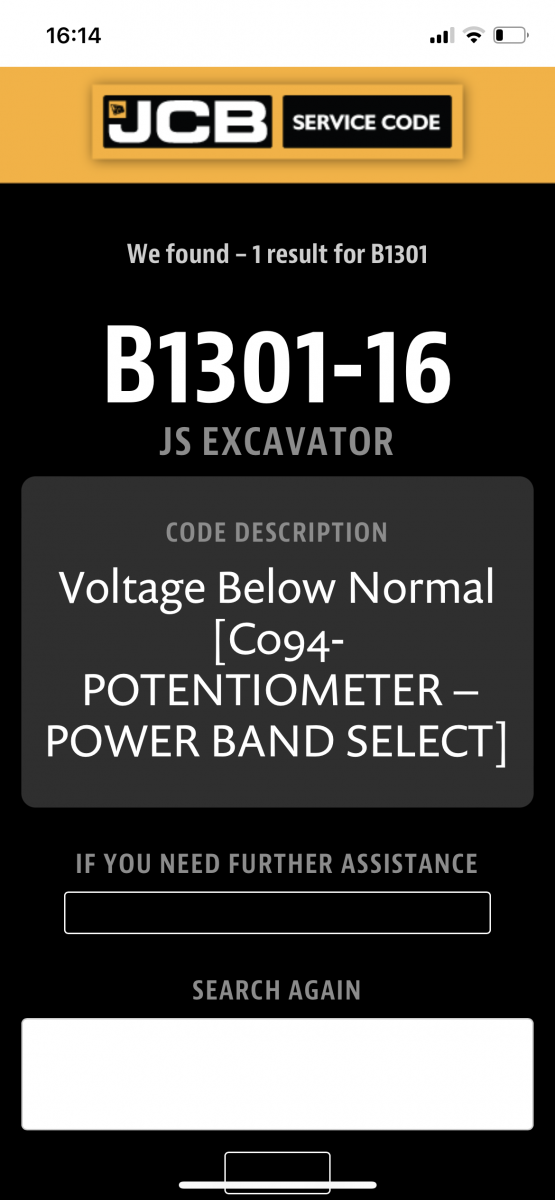

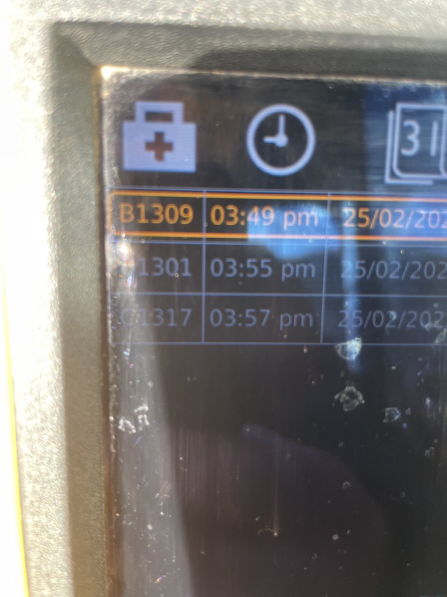

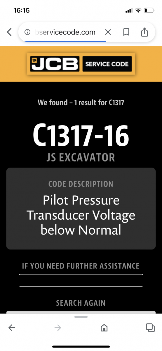

Can anyone help we have a jcb js130 and the hydraulics are dead.. and showing these codes..!!

Check alternator belt! Does it screech when you turn it off?
was my first thought .... battery on the way out or alternator not charging fully ... loose fanny belt'd do it too .... lot of things just won't work below 12+V
