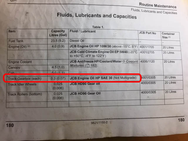

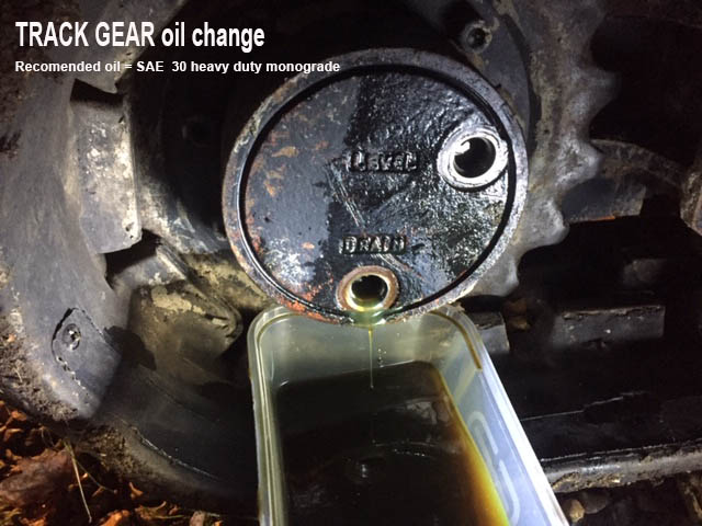

I am struggling with servicing my JCB 8014 and I need some advice. I changed oil in Track Gearbox (both sides) and put Hypoid Gear Oil EP90 GL-5 API, but later reading JCB User Book I learned that they recommend SAE 30 HD Mineral Engine Oil Heavy Duty Engine Oil ??? This is strange, because I always thought that any gear mechanism would prefer Gear Oil not Engine Oil. Anyway, following the book I replaced gear oil with recommended engine oil.
The Service Book does not show how to grease Track Idler Wheels and Track Rollers ? Both need Gear Oil HD90 GL-5. I tried to search the Net hoping to get some info regarding the above, but no joy. JBC web site is complete rubbish ! No technical support what so ever. They don’t even have service manual for download. So, I am hoping that someone here will be willing to share his knowledge. Especially on greasing procedures : Track Idler and Track Rollers, Slew Ring Bearing, Slew Ring Gear Teeth (this need “Special Slew Pinion Grease” but there is not technical spec of the product?)

I've always put sae 30 in my track motors on my jcb. Not expensive and as far as im concerned its what it says in the book so no come backs.

SAE30 oil in the hubs is normal now, even up to 100c models.
Having said that, I think I’ve probably put 80-90 in my 803 it’s entire life, without even questioning it.
End of the day any oil is better than no oil!
