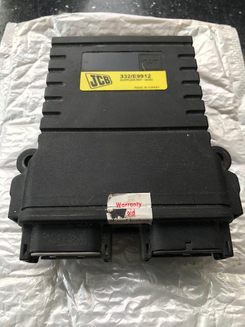

Hello again. I am still struggling with my JCB mini digger. I tested the starter motor ( by short connect) and it is working OK. The ignition barrel is OK , too. So, I suspected ECU/immobilizer, as there was no voltage to the barrel. I removed the ECU module (not easy job). I looked inside. All looks good, no water damage, no burned parts. Now I need to find someone who can test the unit or repair if faulty. Do you people know anyone? According to the net this part 332/E9912 was replaced with newer 728/E9493. Thanks for your help, so far.

If your on facebook look up francis charles at FCS spares and Dale Hinds, both dedecated JCB parts suppliers
