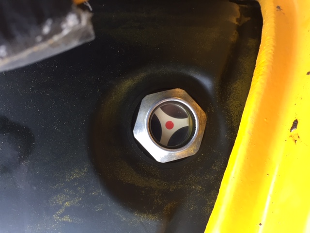

Hello, recently I purchased used mini digger JCB 8014 (2014). I checked engine oil and coolant level and noticed that hydraulic oil is low (see photo). I searched the net on the subjects, but there is nothing about hydraulic fluid. I only learn about the fluid spec. However, I would like to learn how to top up or change the oil in hydraulic system. What is the procedure? Does it need to be de-pressurized? or bleed? Where is the fluid filter? This is my first machine of this type and I have no experience these matters. Hence, I am looking here for some help from experienced owners or JCB technicians. JCB Internet support is complete rubbish. They don’t even have User manual available on line. Shame !!! Please help. Thanks for reading.

Boom outstretched (so the Rams are all "In") will give you the Datum point for the machine.
Take top off tank, fill to mark.

and therein lies the nub of the problem ..... as Rory says..... dipper fully extended, bucket ram closed to full dump and boom as low as it'll go on a flat surface ..... if you fill to this point, you will never have more oil in the tank than at this level ..... unless you're in a very deep hole with the bucket ;)

all rams closed, including offset, bucket and dozer blade. We was taught at JCB with all them closed so long as its on the gauge then your all good.
I don't know if your picture has been rotated?
If it is rotated 90deg clockwise, it would look to have some oil at the very bottom of the glass, with all the rams closed as much as possible it may not need much oil.
edit, wrong person quote 1st time 🙄
agreed ... does look to be showing slightly ....
