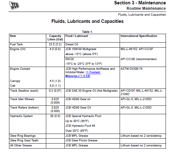

Can anyone please recommend what gear oil I can use in my j c b 8014
Gecko
Gecko
"The Book" just specifies a modern (GL-5) HD90 gear oil.
This means no EP additives like you'd put in a diff.
(just a good honest gear oil)
Shovelhands
Shovelhands
But the only part that the op is likely to be filling is the track hubs/final drives, which is straight 30 engine oil. We’ve discussed this on here before, EP90 would most likely be ok, in a track hub any oil is most definitely better than very old oil or no oil!
