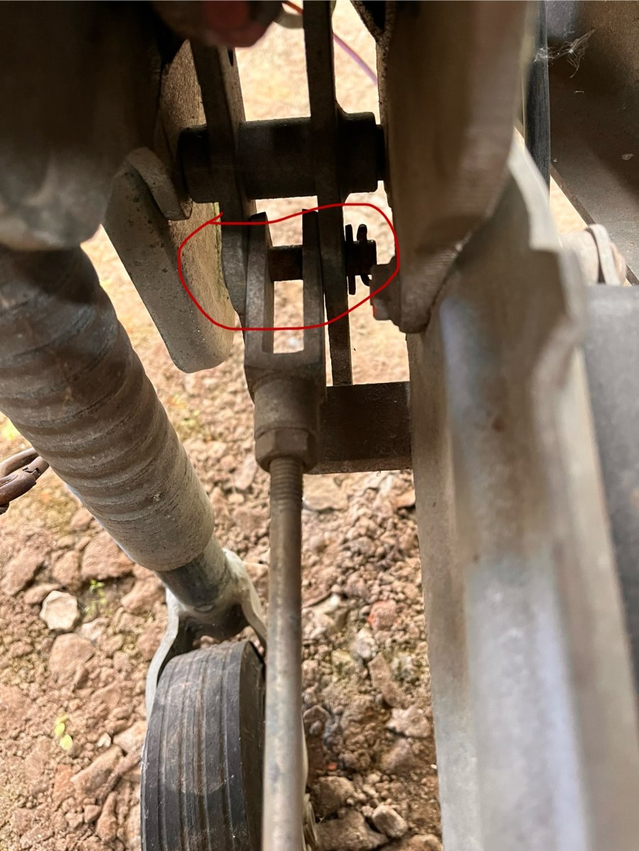

Fitted new handbrake lever to trailer now can’t get spring back on? Any ideas guys
Cheers Dave,Got it fitted nowJust had a look at mine… and I assume you need to release the brakes from the lever too so it lets the handle pull all the way back, thus letting you get the spring back on?
This pin in red?

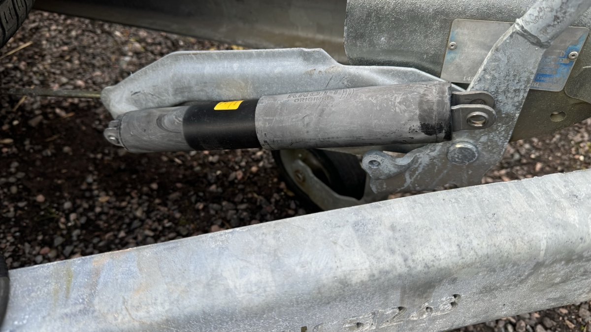

I try’d the baler twine idea first,6 loops and it just snapped them all! Also try’d big heavy duty zip tie with no joy.But got it with dave's ideaCompress the spring with whatever you have to hand (high lift jack etc) , wrap baler twine (or similar) through the clevis's, fit to trailer , cut string ....job done![]()
Thought that myself at first , but they are bloody strong things!Compress the spring with whatever you have to hand (high lift jack etc) , wrap baler twine (or similar) through the clevis's, fit to trailer , cut string ....job done![]()

and either carry at arm's length .... or get someone else to carry itCompress the spring with whatever you have to hand (high lift jack etc) , wrap baler twine (or similar) through the clevis's, fit to trailer , cut string ....job done![]()
