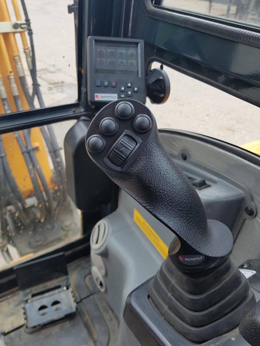

Recent installation carried out a couple of months ago for A F Theobald & Son Ltd over near Chelmsford, Essex. Invested in our Rototilt R1. The Hyundai has servo valve assisted foot pedal which made the installation a whole lot easier and possible. Customer opted for direct mount, with no integral grapple but beauty of this he can always add integral grapple as a retro fit at a later date. We supplied out Rototilt bucket package to include Grading bucket. Customer very pleased with the purchase and is really pleased how the concept has changed his way of thinking and how he looks at jobs.
