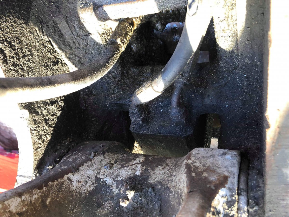

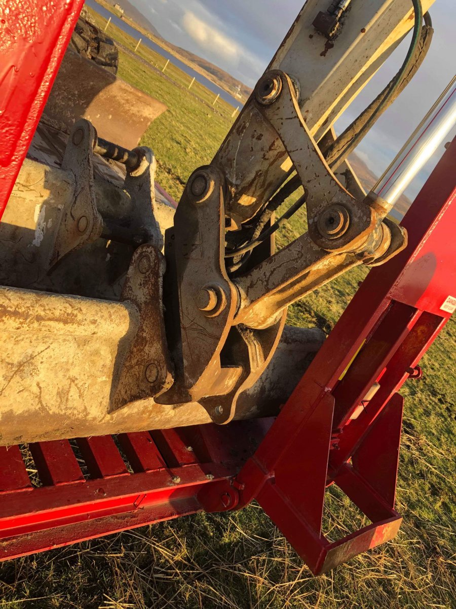

Gents, been to a machine today with a hydraulic quick hitch, customer wants a new one that’s double locking, I am going to supply a new Geith hitch.
Now his old hitch has 3 hoses, I’ve never seen this set up before?
I am guessing, one to open hitch, one to close and one to keep a constant pressure on hitch to keep closed.
Would I be able just to blank the 3rd hose off or better replace the hitch solenoid block

It could well be, I’ve not seen the machine for a long time. And as usual it’s no handy to get at.
Do you recognise the brand of hitch?
Pretty sure its an american make looking at the symbol.... not sure which though
looks like an old Hill .... is the third pipe feeding to a secondary ram and returning through it ? are there actually three pipes up the boom to the valve ?
think I'd be putting a new QH valve block on to suit the new hitch
