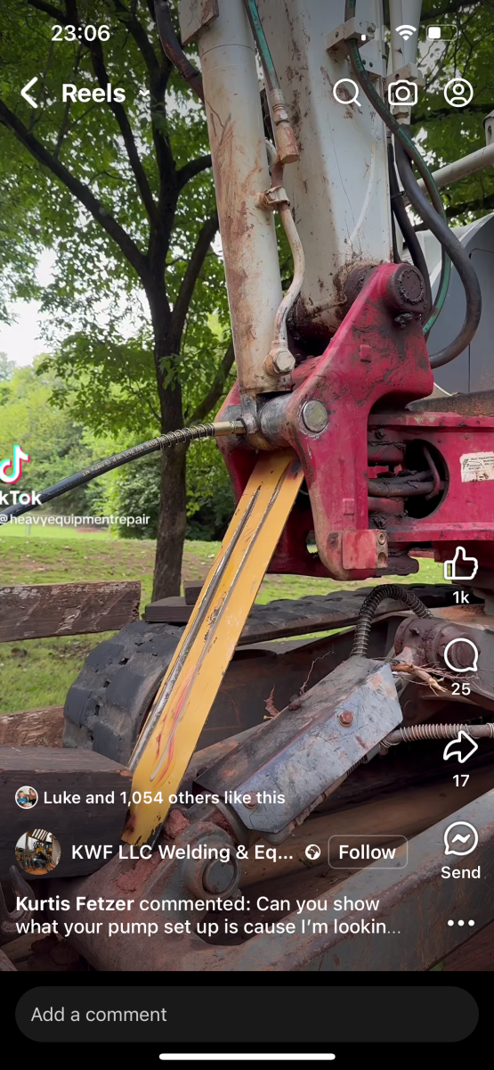

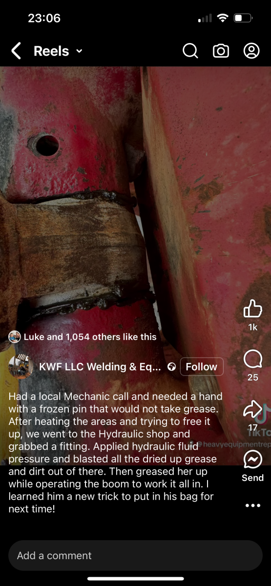

Saw this on the tok, what fitting would you need to connect up to a grease nipple thread?

I've seen folk connecting up a porta-pak to a grease port to put a bit extra force down the gallery.
Takeuchi will be BSP nipples I'd have thought, probably 1/8" you'll need a 1/8" BSP taper to 1/4" NPT adaptor
bang on I'd say ... or a 10mm to BSP if metric ...... and a portapack hand pump ;)
