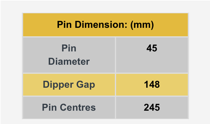

Ive recently bought a Kubota u48 and want to buy some 2nd hand buckets, but its not been delivered yet. Ive been told i need 45mm pins and 150mm wide to fit between the quick coupler lugs. Does that sound right? Think i need to confirm the dipper gap, hes saying 150mm to fit between the coupler lugs so does that mean the coupler lugs are 160mm for example?
I’ve found this on a bucket manufacturers page if it helps?
I’d wait and see what condition the quick hitch is on your new mount before you order buckets. May be as well to buy a new hitch and set of buckets.
