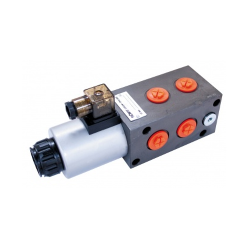

I got this diverter valve from Approved hydraulics for just over £100 a lot cheeper than flowfit they seem to have gone dear as said
that was a good price @Davedb ... 1/2" ports?? ... what're you doing for case drain? looks to be ported for it ... some you can get away with, with low flow/pressure, others are an absolute must have.
got a link to the sellers?
as said Flowfit have become very dear ... it is a LOT cheaper to find the item you want on their ebay shop and buy that way .... VAT and shipping are all inclusive for very little more than their bare ex-VAT/shipping prices
Davedb
I’ve no case drain atm seems to be working fine so far the diverted service ain’t used much as it’s just a hydraulic top link

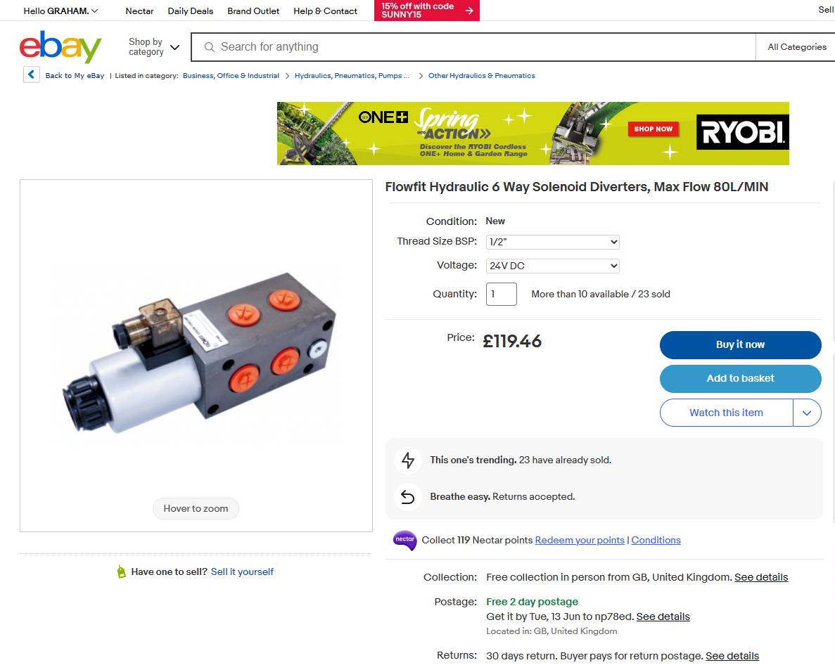

Just bought a handle for the log splitter through flowfits ebay as the price was reasonable, came with a flyer offering 20% off my next order on their Website. That would imply to me the Website is 20% over priced...
and their shipping charges are off the planet, whether you're buying a pack of dowty washers, a few adaptors, or a ram -- £17 odd plus VAT
