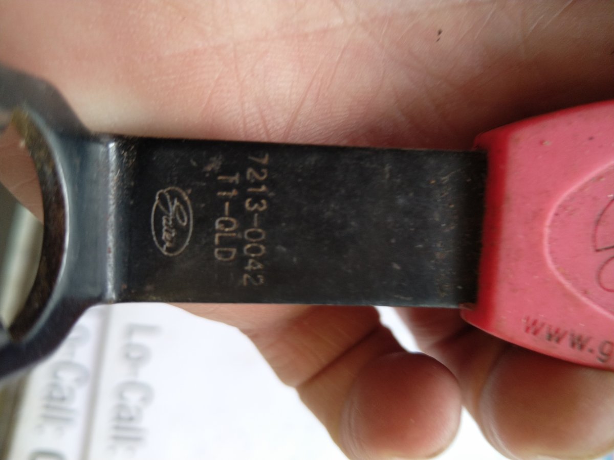

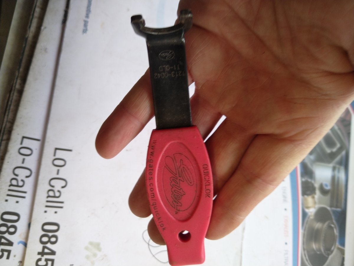

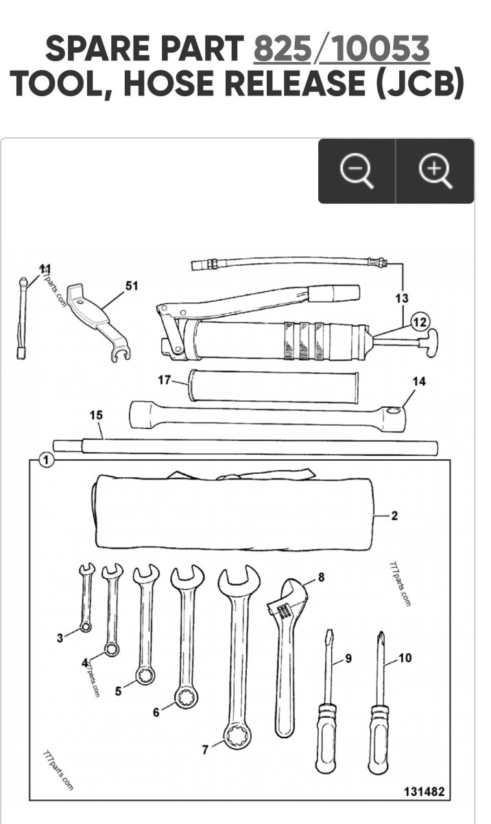

Product # 7378-02108
Product # 7378-02109

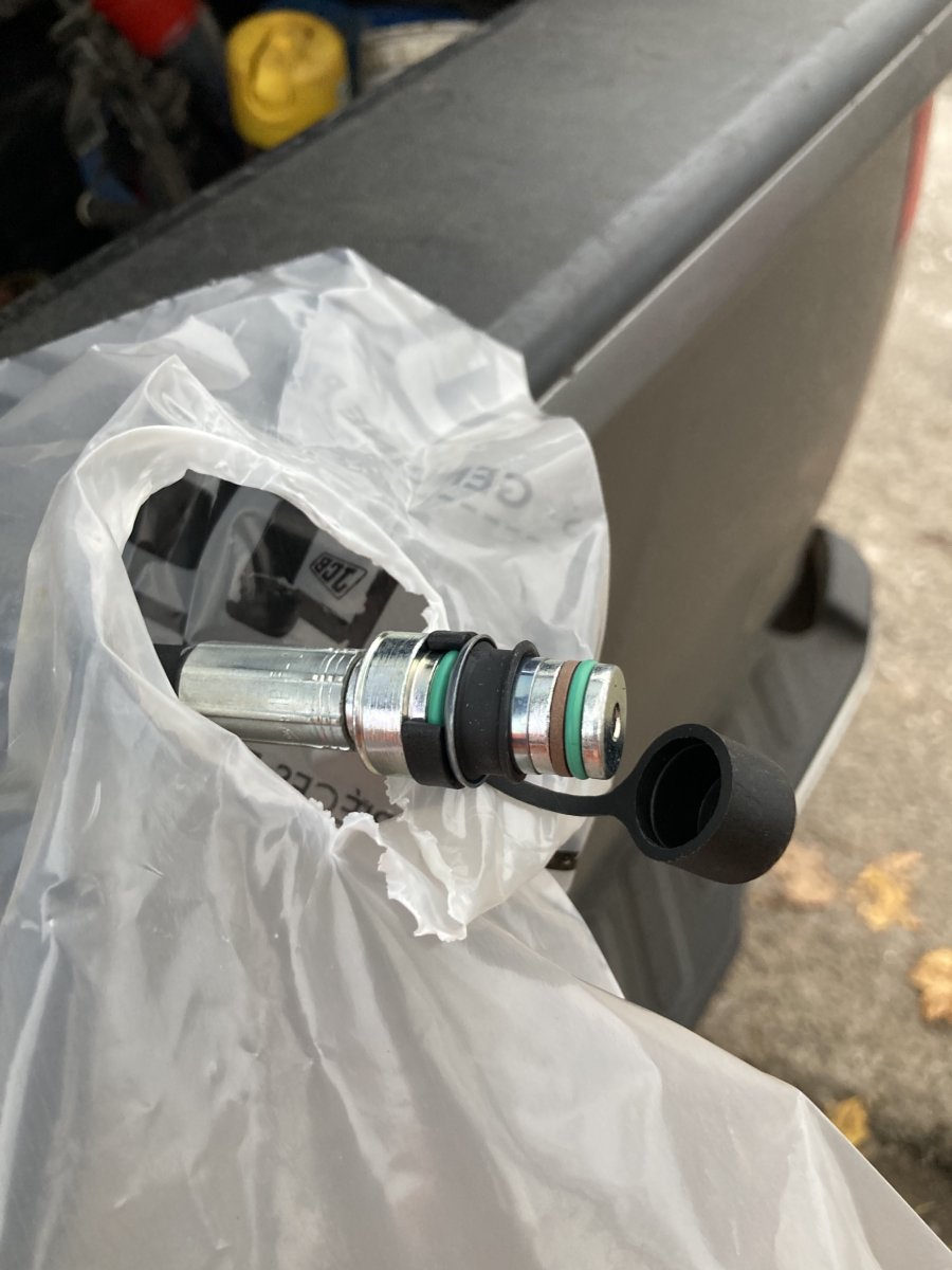

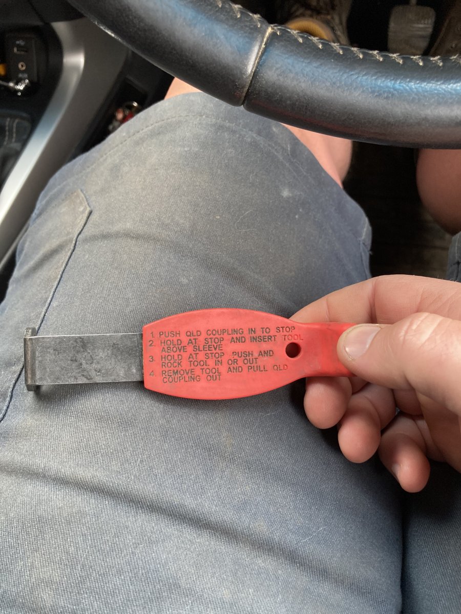

Thanks all for your help, especially Jonathan from Quin plant hire who helped massively with how to go about the job. Knowing how it works is half the battle, so in the interests on sharing knowledge, this is how it went.
When you buy them new they come with a nice cap to protect the end - see photo below. DO NOT TAKE THE CLIP OFF AND FIDDLE WITH THE SLIDING COLLAR!! It releases a spring clip held under the collar and its not good times. Only take that cap and its little clip off once you are ready to put the hose in place.

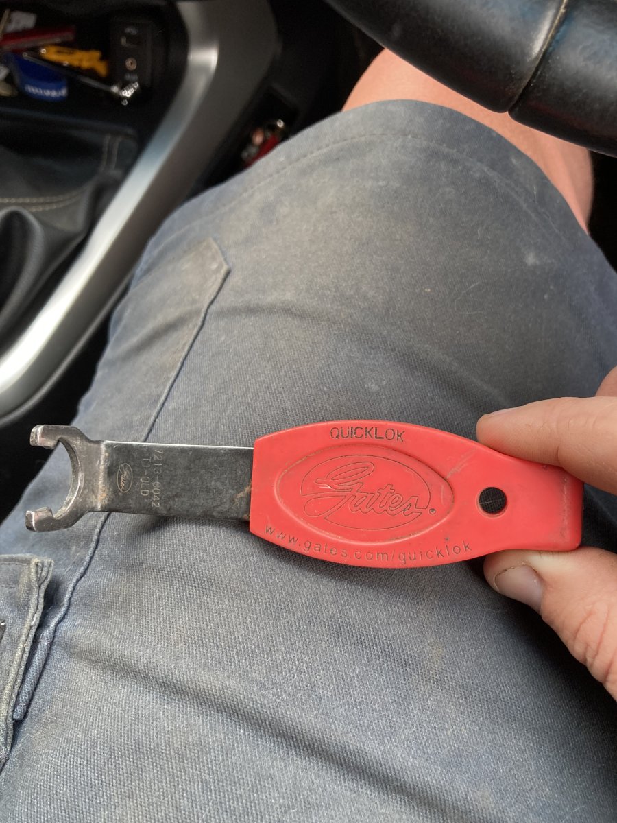

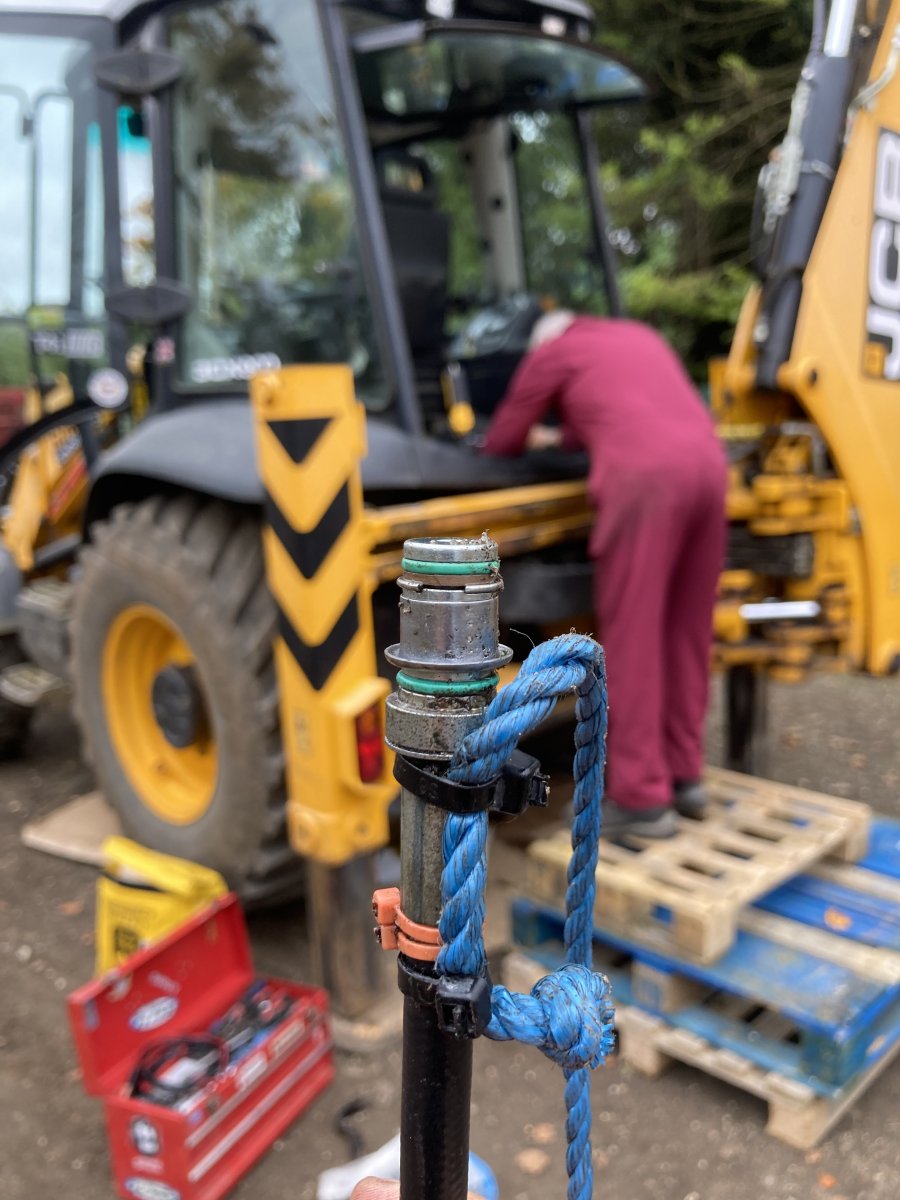

The tool which we now know the part number for does describe how to get the old hose off but the key I found is to push it fully home first which must close the spring clip down inside the fitting. The collar then slides up using the tool pretty easily, a bit of wiggling helps and you can then pull back on the hose and the whole thing pops out. Actually not too bad - if you can get access to it!
Brought my Dad out of retirement today to help - its definitely a 2 person job. Routing the hose back through the seat isn't easy.
I look forward to doing the other ones of these in time, they all look ready to perish sadly.
Managed to borrow the tool this time from a helpful contact but will be investing the £10 for one myself now I know what it is!

They are a bitch to remove on top of the valve block as up against the underside of the cab floor we found undoing the rear cab mount bolts and jacking the cab up to give us some more room
