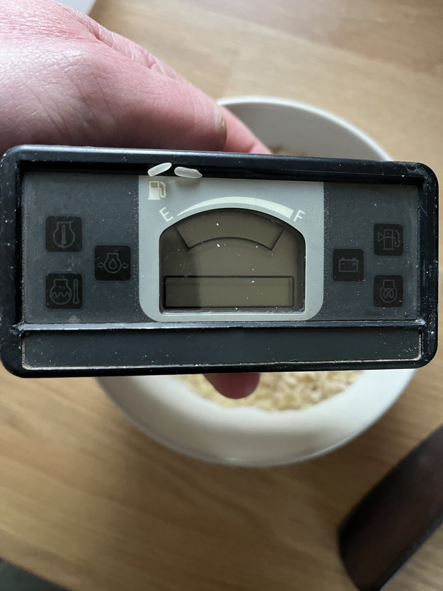

One of my mini diggers is suffering from a misty hour clock, it doesn't phase me but its doubles up as the fuel gauge and I send it out on self-drive.
I have removed it from the digger and left it in a bowl of rice all the condensation has now gone :cool: how can i stop this from occurring some sort of tape over the top and heat gun it in place?
Looks to be a tiny spilt on the fuel decal which could be letting in water

Seriously though you need to vent it, once you've got an in and out vent it'll stay clear.
If it's sealed try a Desiccant bag, but you may need to change them after a while.

I'd guess the water is penetrating at the corners, so I'd be looking to keep the water out as a first stage solution.
Just some clear silicone around the edges might be enough.
