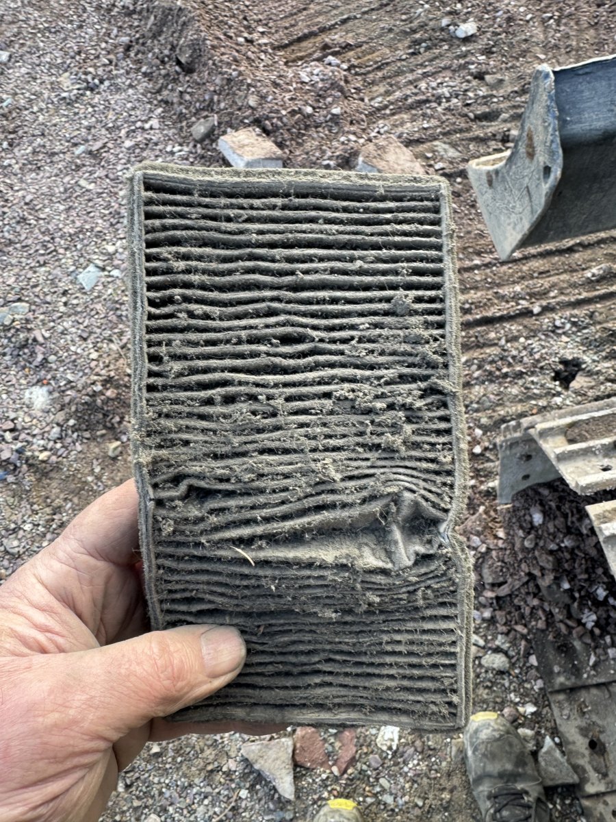

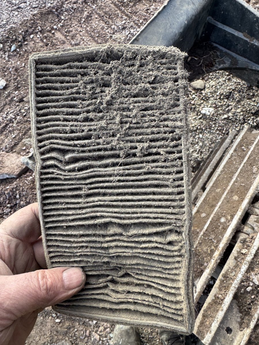

those filters may need entering into the Guinness Book ... for longevity Vin .... :oops: ... deffo not gonna cut it on extended performance life though :ROFLMAO:
I’m all for skipping an odd pollen filter replacement now and then but I’m reckoning they are a couple of hours past needing done !

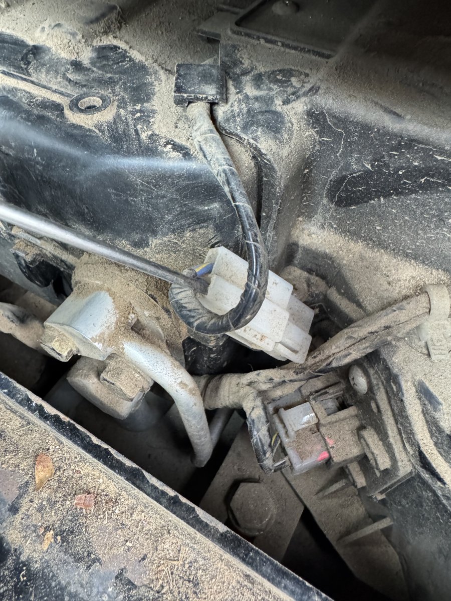

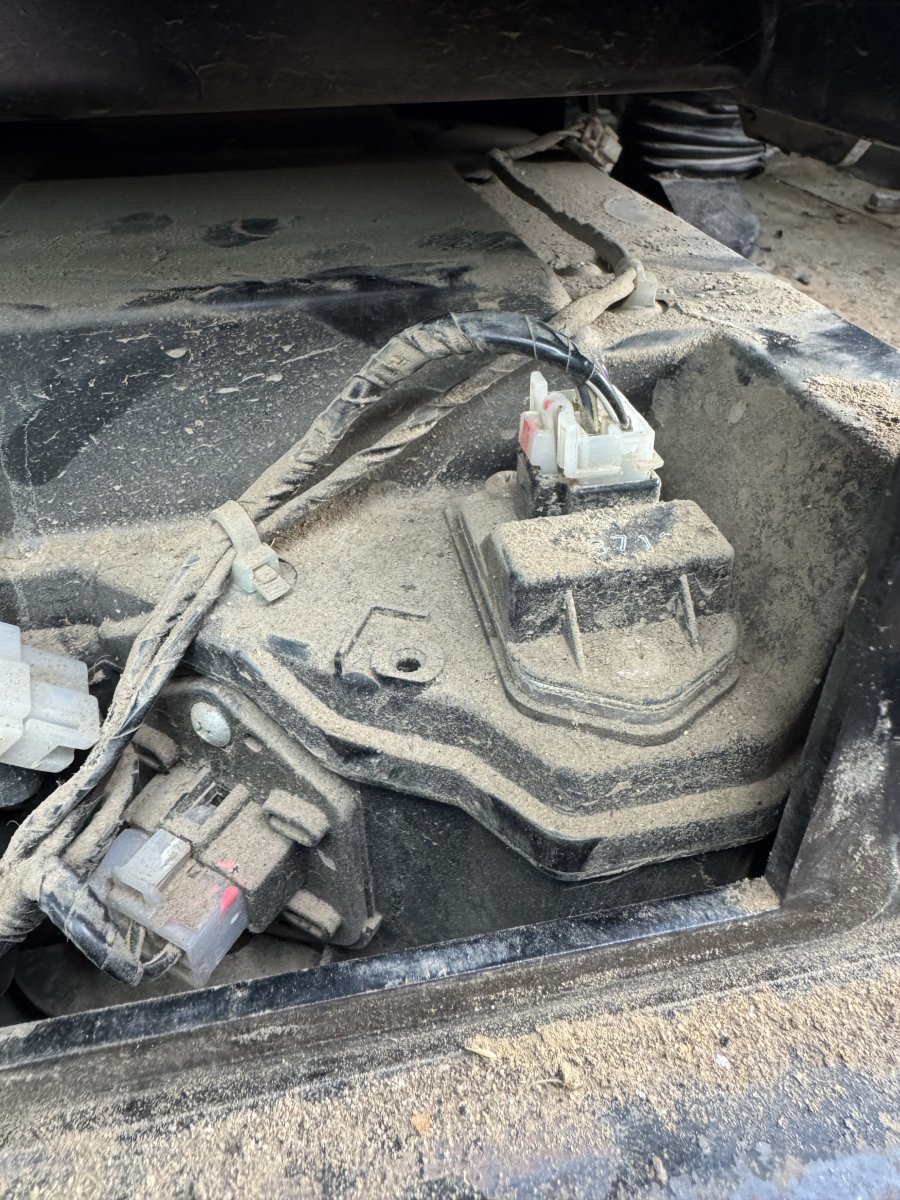

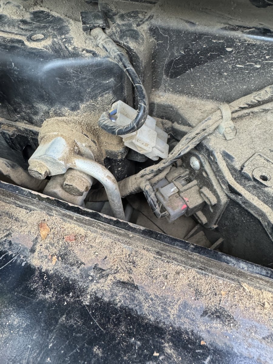

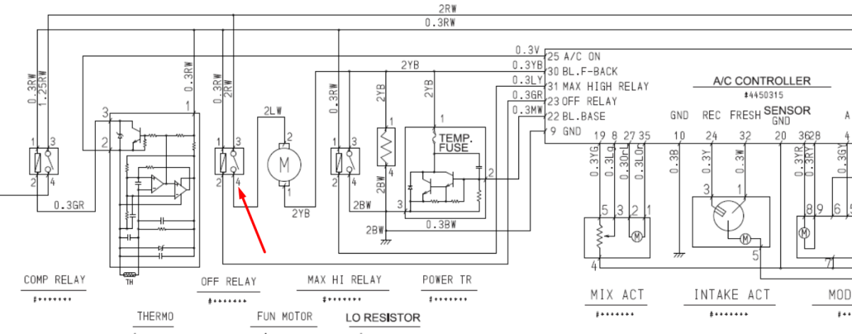

Does my theory sound feasible re motor cut out or is a bad connection more likely sorted by me disconnecting everything and connecting back up again ?
Gecko
Gecko
A motor temp. cutout normally operates like a self-resetting fuse. That is, it allows the motor to run until the fuse heats up each time.
Yours sounds more like a dodgy connection that has been fixed by wiping the contacts against each other.
could also be down to total lack of air flow - might even stall the motor if the enclosure is well enough sealed, as you'd expect with filtered inlets
