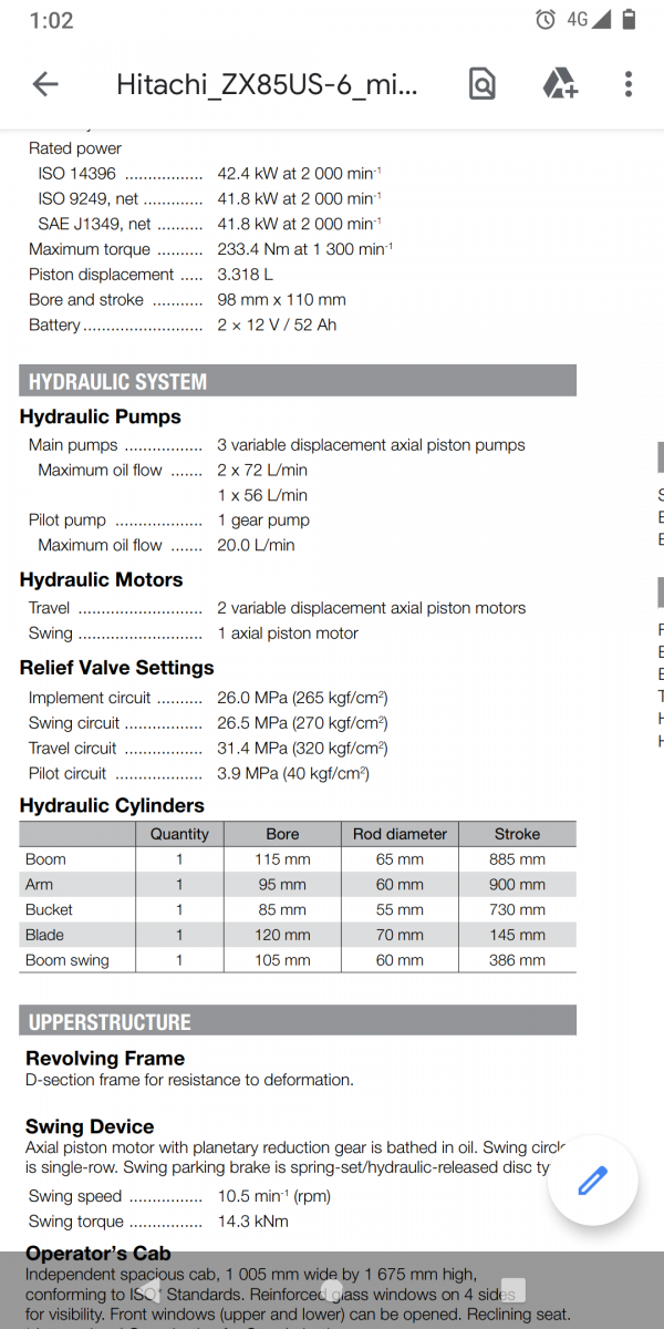

Hi , Its been a long time since i posted here .
Maybe someone can help me out , I need to know the available max flow rate on the implement section ( hammer Line ) for the Hitachi Zaxis 85us-6
Thanks in advance .

My 55u is 80lpm
The 85 has 3 pumps plus a pilot pump

We have a few zx85/6flow rayes are fine for breaker etc bit not very good for the likes of a flail will run the flail but doesn't like doing anything else at the same time you have to wait for it to pick up again before carrying on apart from that excellent machines
