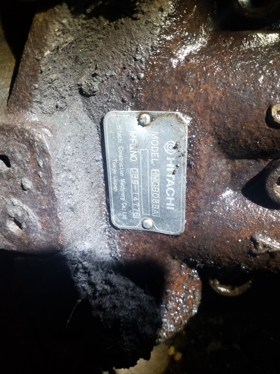

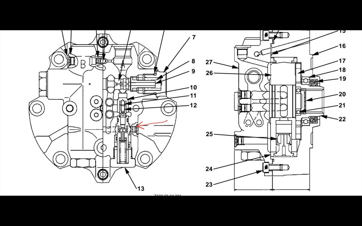

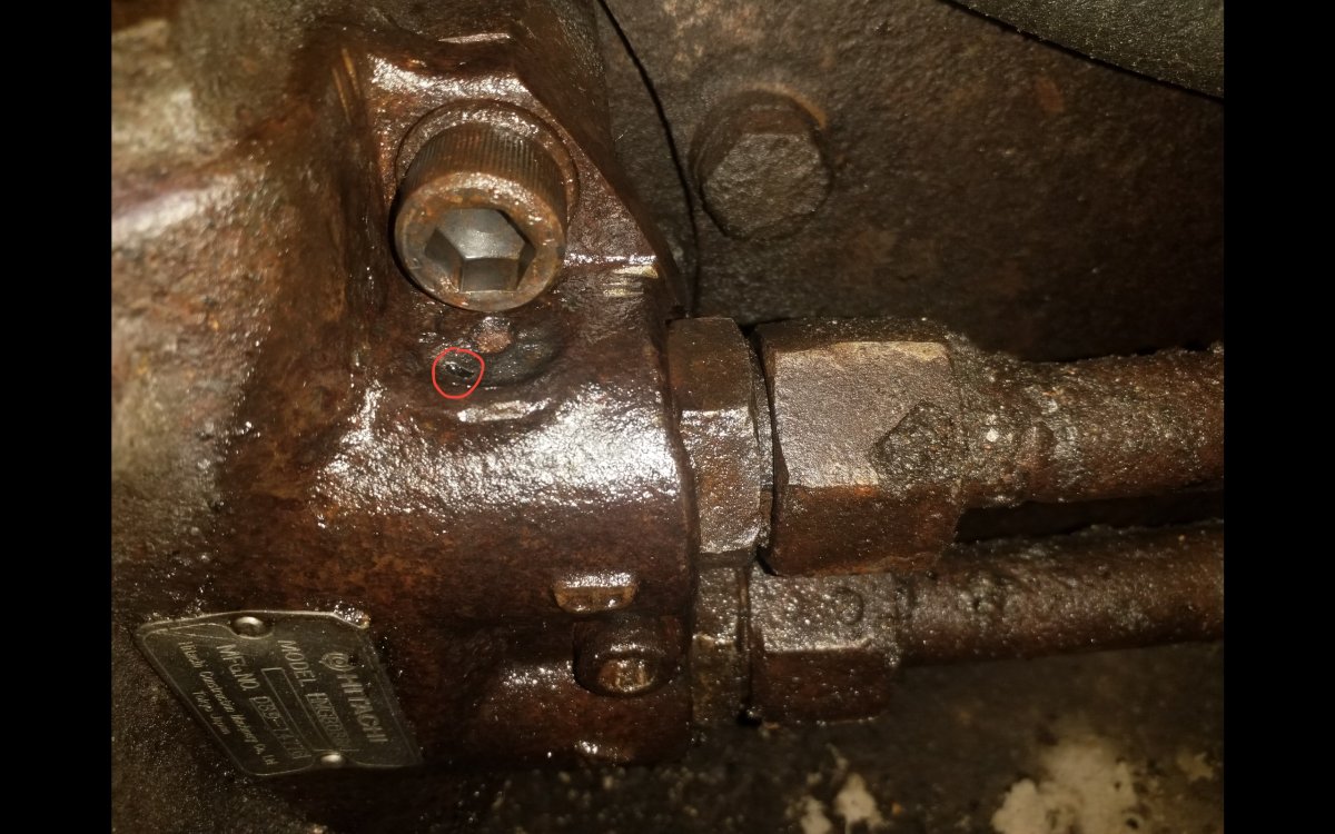

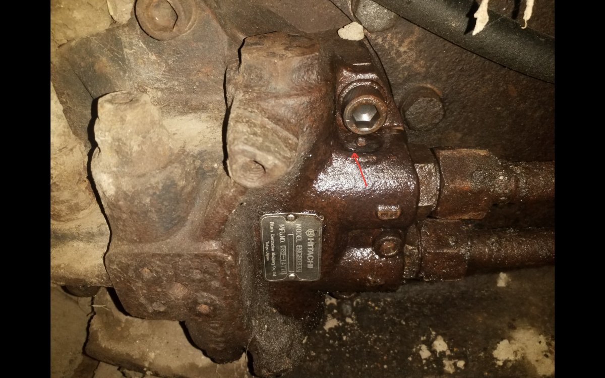

On the belt motor of a friend of mine's machine, hydraulic oil has started to leak out of a blind plug
due to the fact that the flange above the o-ring has rusted away so there is a hole in it so you can see the o-ring and that is where the oil comes out.
So the question is short and sweet.
Is there any hope of getting this plug out
Or should we just weld it over and hope it seals without leaking

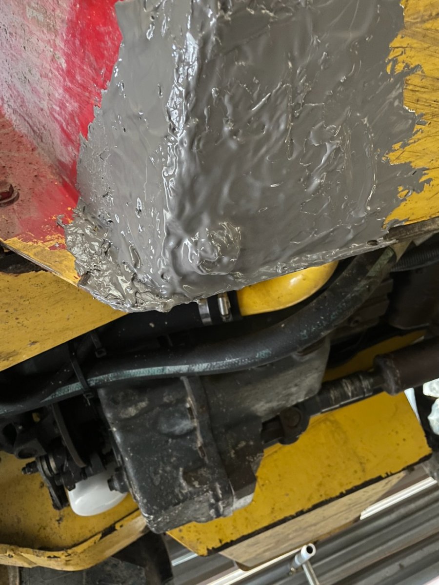

Use resimac 104xf. Had the same problem on a hydraulic tank and it worked a treat. View attachment 53305
was going to say the same, but with a full working pressure behind it, I'd be doing what Aiden suggested .... get it mega clean as poss. and weld the nut through the centre with a MIG ... the heat involved will help dramatically in extracting the plug

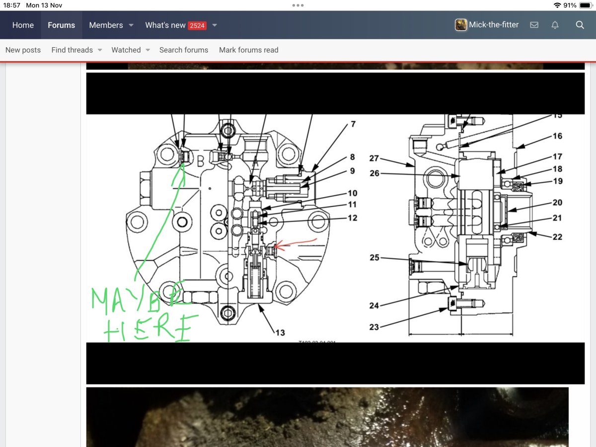

Maybe the green arrow is where the plug is compared to where the port and cap head bolt are, if you are going to weld it why don’t you weld a nut to it and try and remove it, it does have an O ring seal below the cap head which will melt but help to remove the plug.

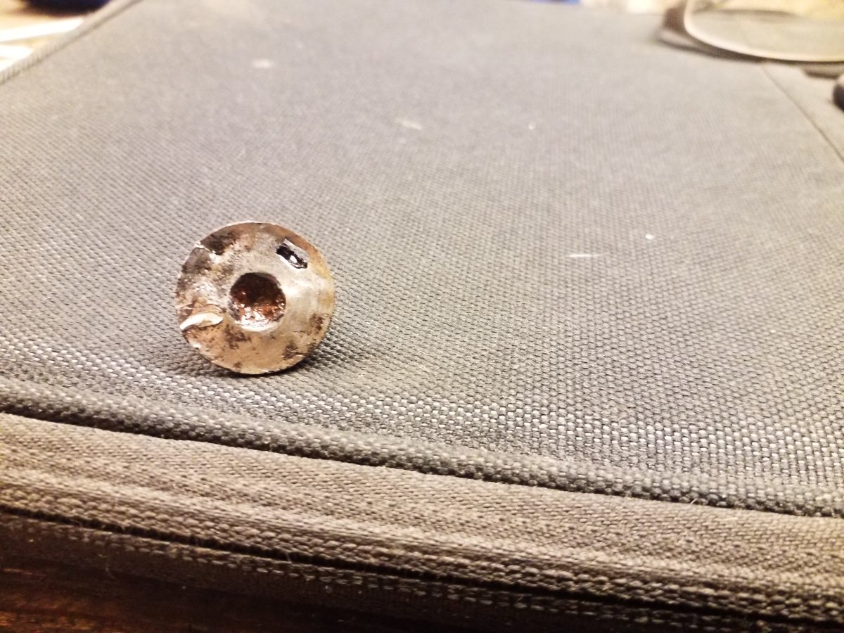

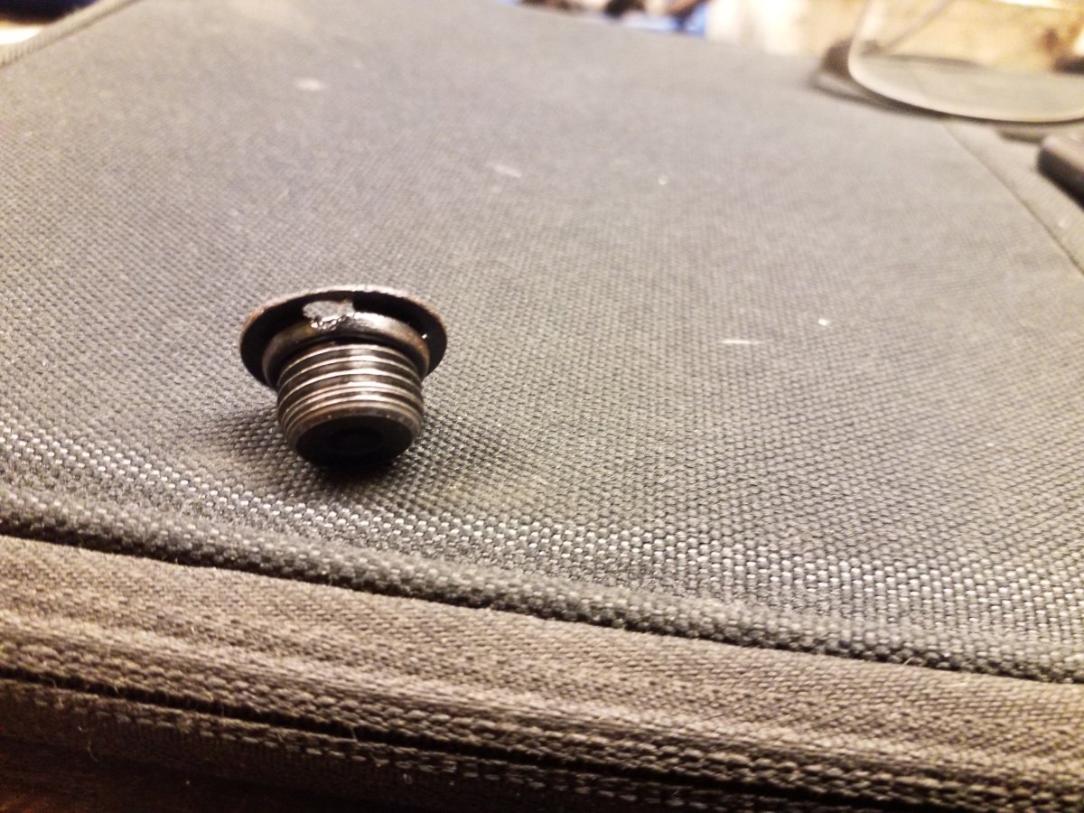

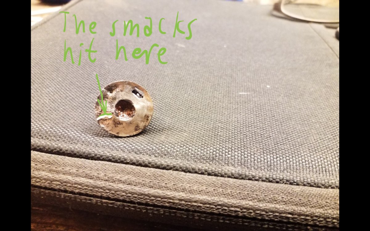

I took one like this 1 Kg
which gave one like this a few smacks
followed by one like this
Who also received a few light smacks
And I didn't believe my eyes but it came loose
So tomorrow the hunt for the new blindplug starts

Brilliant, glad it didn’t turn into a handling😆

Maybe the green arrow is where the plug is compared to where the port and cap head bolt are, if you are going to weld it why don’t you weld a nut to it and try and remove it, it does have an O ring seal below the cap head which will melt but help to remove the plug.View attachment 53310
You are a absolutely korrekt That's the correct plug 😊
My arrow is at the wrong place But the same kind of plug 😑🤣

you lucky bar steward ...... don't bother with the lottery for a while - you've used your share of good luck for some time ;):giggle:
