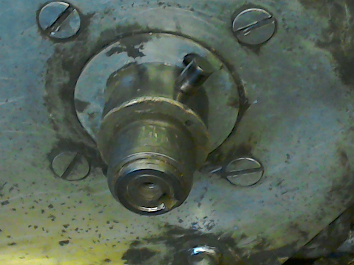

Hi just wondered if anybody could identify this centrifugal clutch.It is on a wacker plate and the engine is a honda g100 ,the drive shaft comes throu

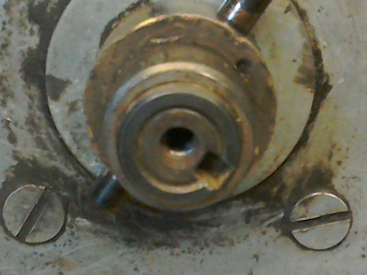

Hi just wondered if anybody could identity this clutch it is on a Wacker plate but has no identification marks.The engine is a Honda g100.The drive shaft comes from the engine through a steel plate with lifting eye then a washer then a housing for the clutch shoes that has 2 lugs for the shoes to locate then another washer and finally a piece that the pulley locates on.Please see pics.Also what is the best way to remove the clutch as I would like to replace the engine.

tha's a hell of a title Chris ....... may take the prize for the longest yet :ROFLMAO: :ROFLMAO: ;):p .... have you any more pix please Boyo
LS engineers would be a good place to start looking

Hi thanks new to this technology I thought I had put more pics on but obviously failed miserably, will try again .Thanks

well you've a few bits to have a pull against with a puller .... might have to make summat up though .. get it set up and tensioned... if it doesn't budge .. a little heat to the boss and a firm wack on the puller should shock it enough to let go .... assume there's a bearing on that boss carrying the drive pulley to the wobble unit ??
