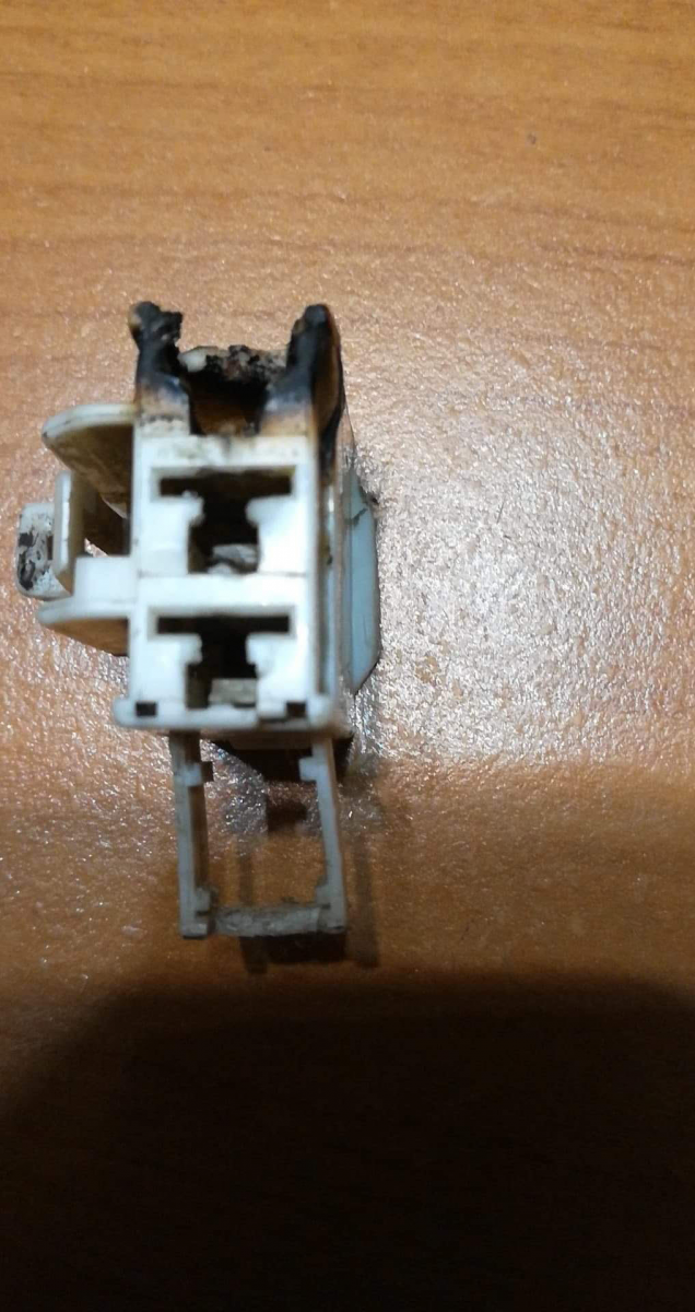

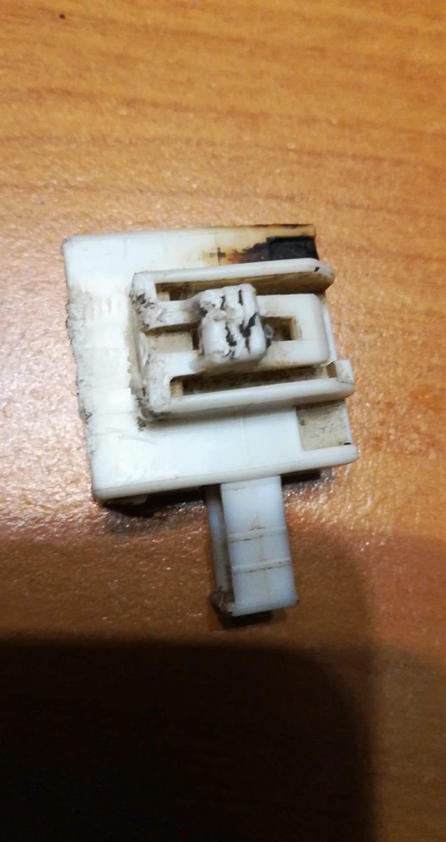

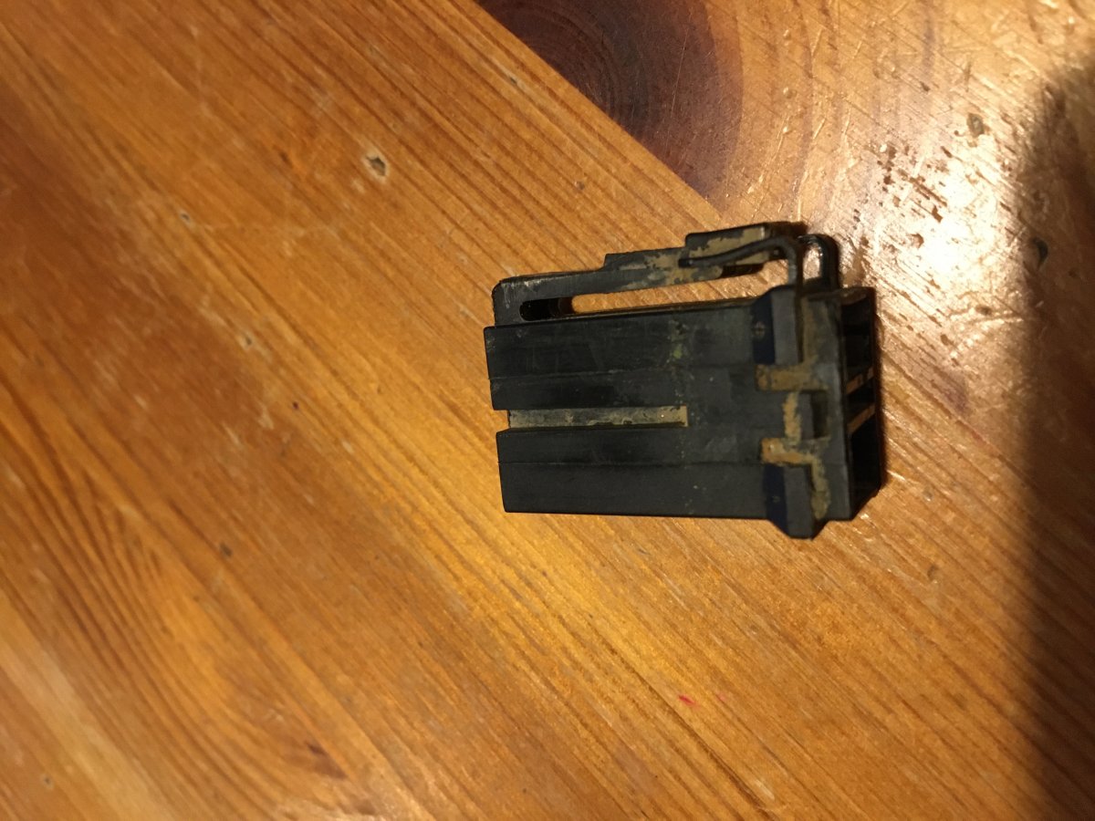

I am posting this on behalf of my father , who is the owner of JCB 3CX 1999 VIN 0486715, and is based in Poland, but is after one part that he is hoping I can find for him.

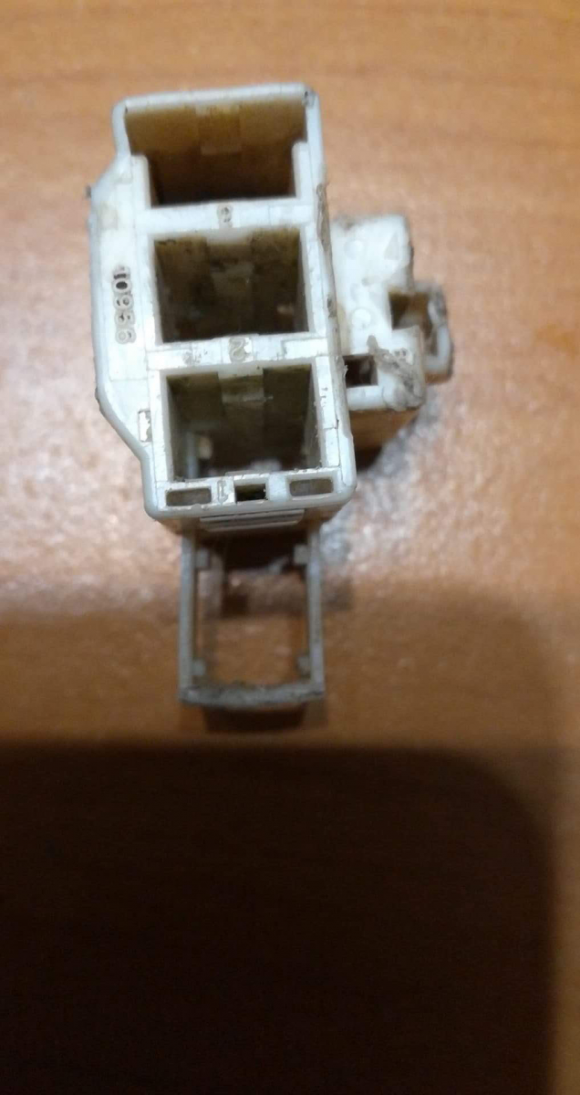

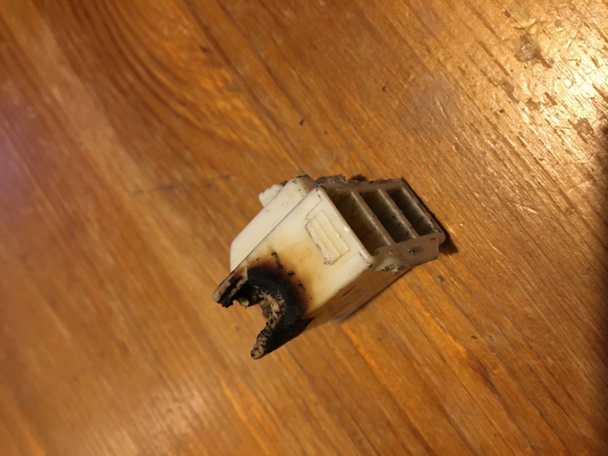

I know nothing about diggers, but he has sent me pictures and was trying to explain to me what part he is after. It is a white cable box/divisor/adapter 12V, that is then attached to fuse box ? He was able to read numbers on it 10956. Photos are attached below and if anyone here you could point me in the right direction on how I could go about getting this part I would be very grateful.
that's cooked :oops::rolleyes: ..... it's just a multi spade connector ....
I'd simply make the connections with individual crimped spades and bullets, with the mating sequenced so that it would only connect one way for each wire ... i.e. male spade, female spade, male bullet, female bullet .... 4 lines and only one configuration .. just try to ensure that the males aren't live, only the females and use insulated terminals

OMG thank you so much for your feedback ! At least now I know what it's called ;)
I will pass the info to my dad. However, knowing him - he would still insist on me buying the exact thing. Any idea what sort of shops I could try and look for it?

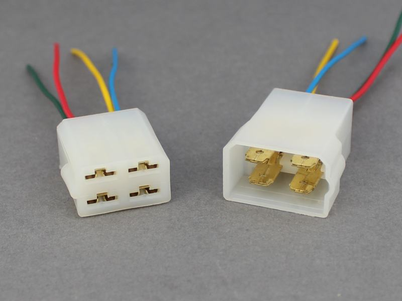

you need to search for something like this ....
these look to be for motorcycles though ...... it's all about phraseology on Fleabay .... just need to strike lucky
more here but M/cycles again ...... could always replace the plug and socket with an alternate
or two of these
https://www.ebay.co.uk/itm/10Kits-6...560773?hash=item445d633c85:g:5GkAAOSw~vVe8Z~u

It looks like a fuse holder for the larger higher amp fuses! Can you ask him where on the machine it is located? I'm guessing near the battery?

nah ..... tha's a lockable three way spade lug connector Aiden ..... bit like these .....
@kasia ..... they're called " spade connector housing " ...... https://www.google.com/search?q=spa...jw3IjX55brAhUAAAAAHQAAAAAQBw&biw=1263&bih=768

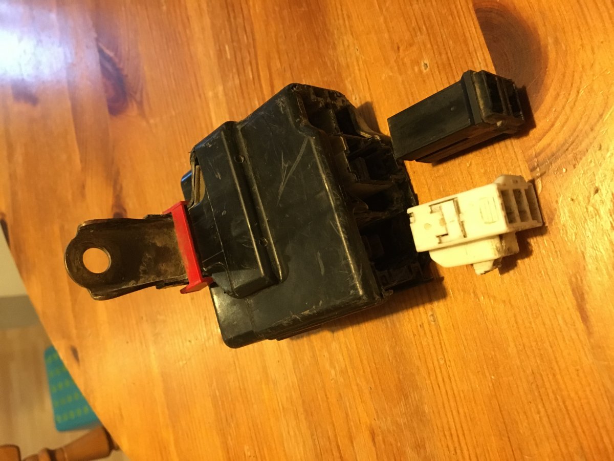

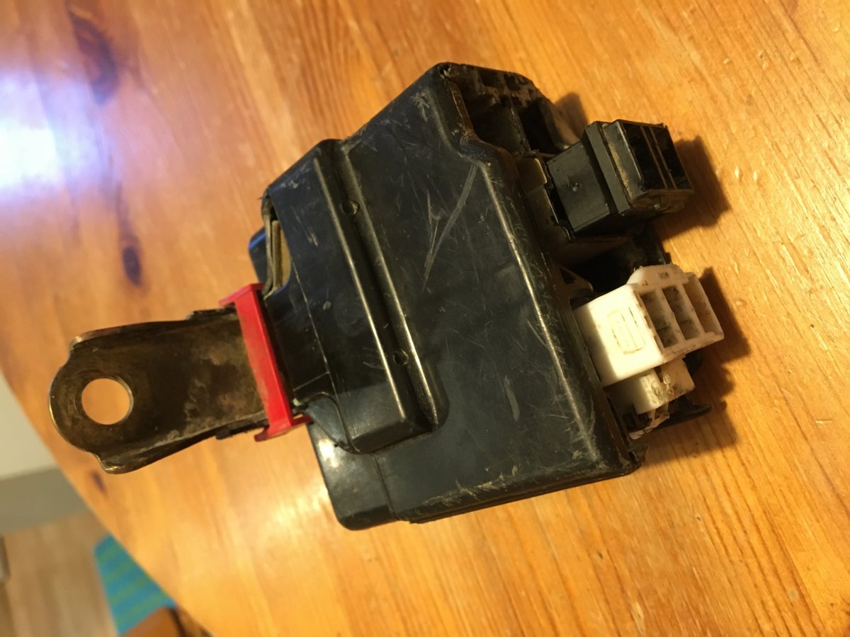

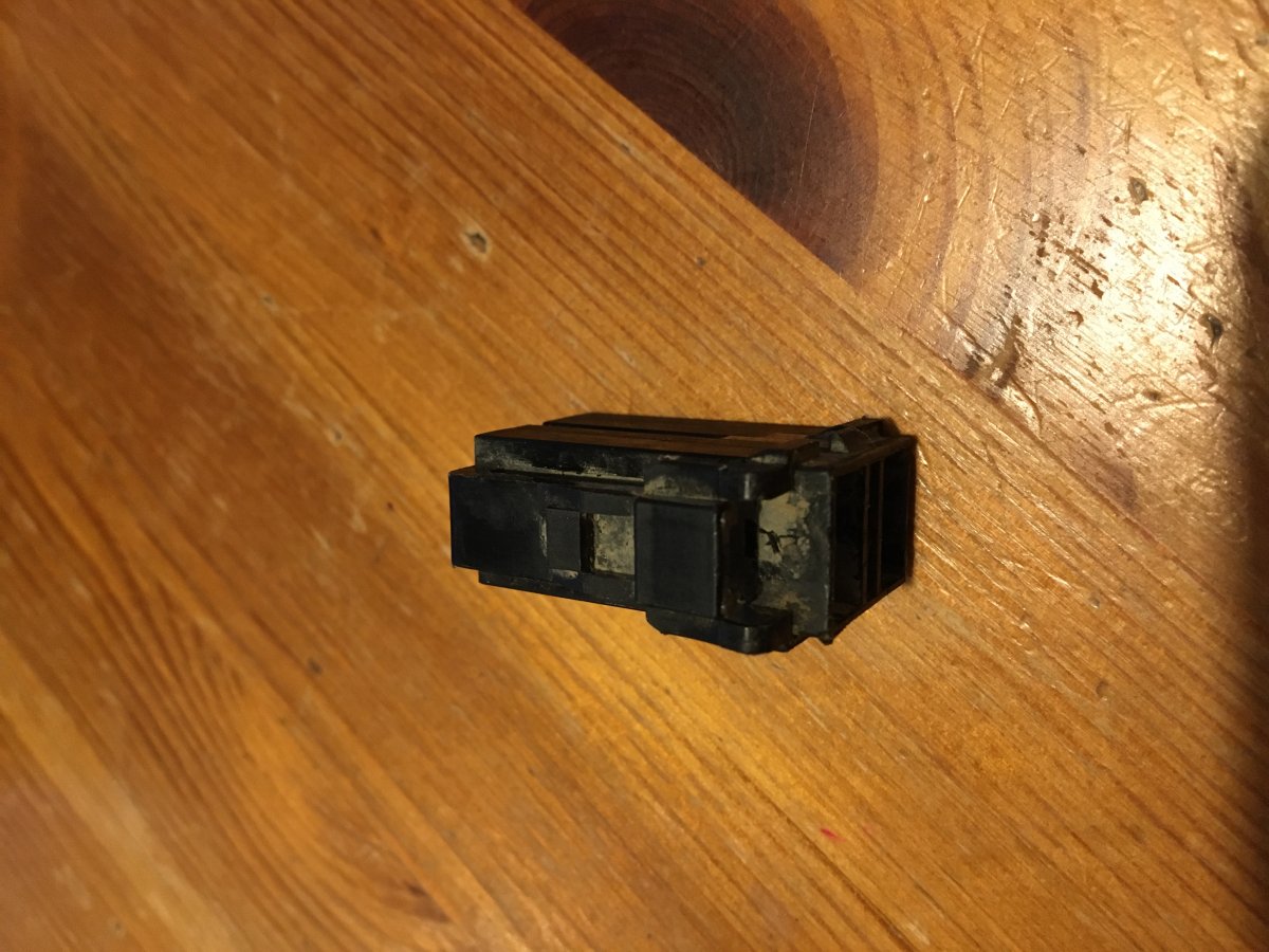

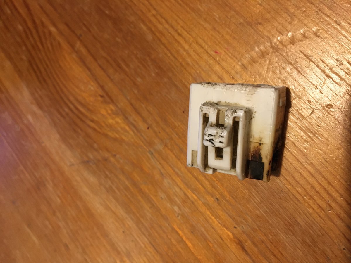

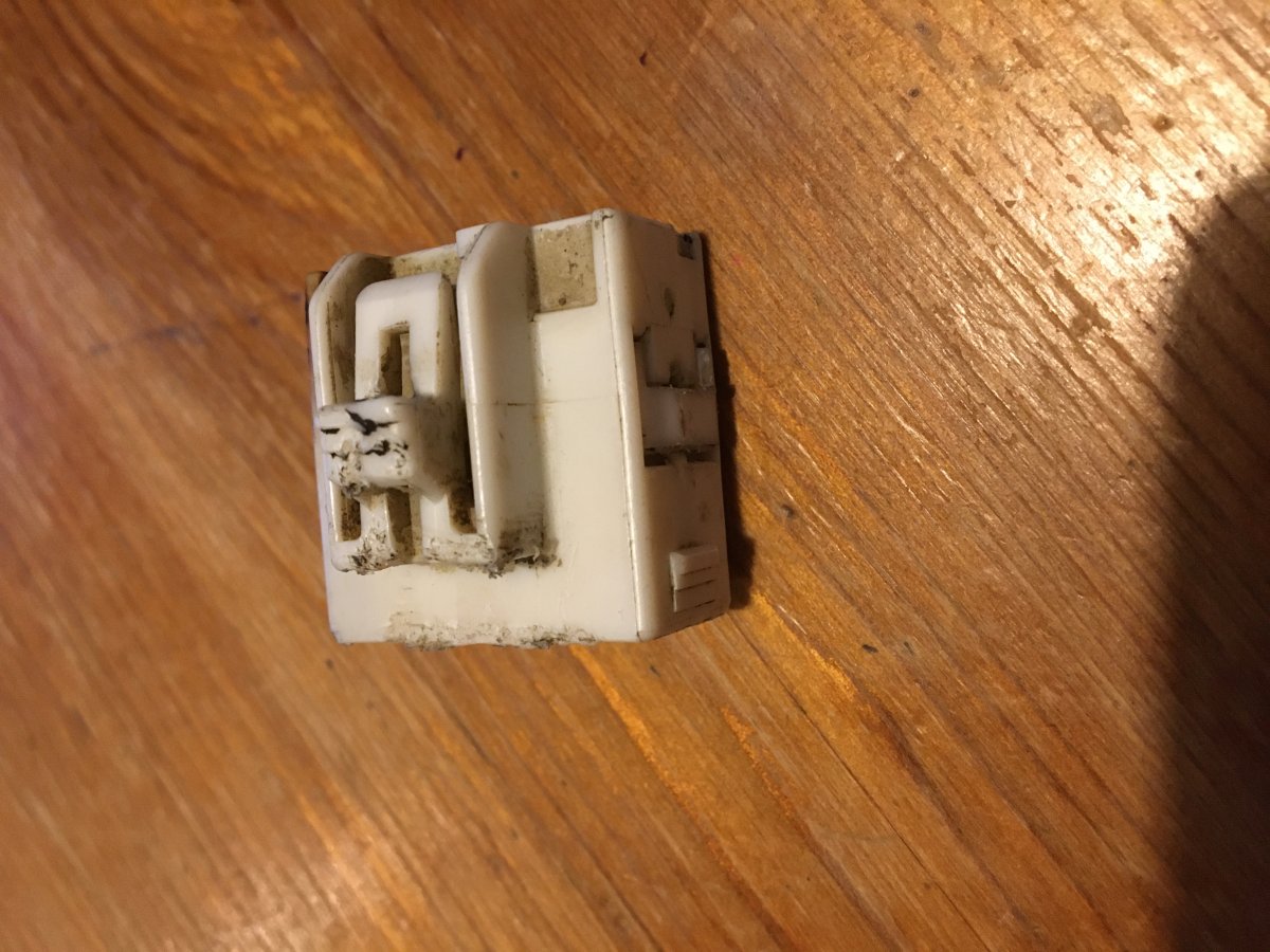

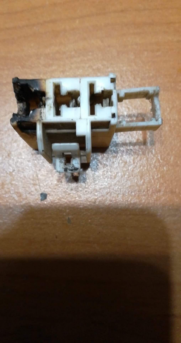

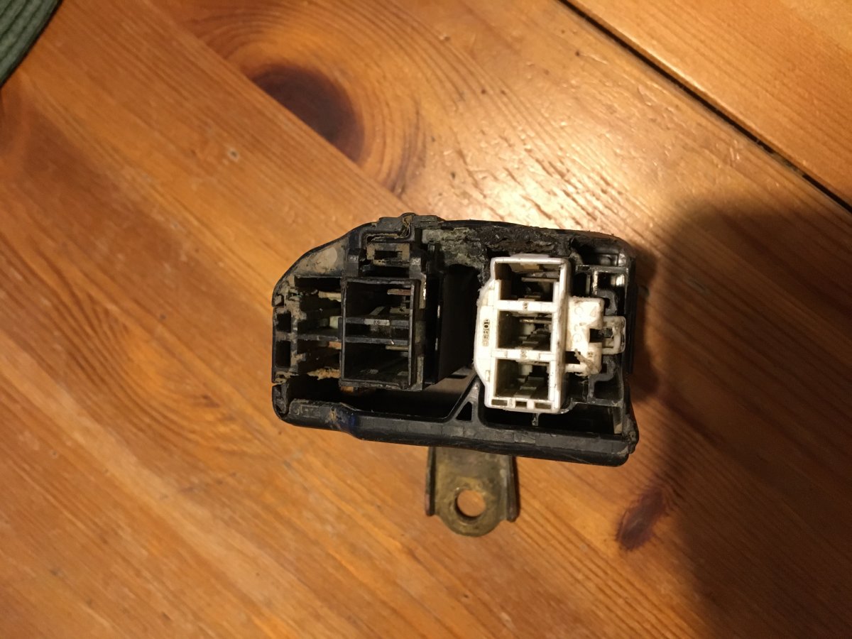

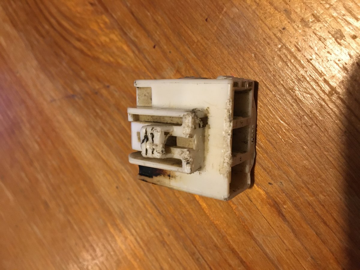

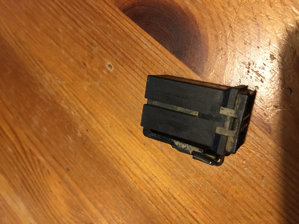

Thank you very much guys. I really appreciate all your suggestions. I have had a look at some of them. Just to give you a better idea of what I'm after I attach some more pics.

reckon you have a bad earth there somewhere :oops: :rolleyes: :unsure::mad: .... didn't see the location of where these connect to before ... just looked at the first post again ... pretty fair chance these'll be JCB only bits ........ and they'll want to sell you a loom :cry::censored:

Ring or email the link i put up. They will sort you out. Probably have a used one

I have spoken to JCB people already and they tell me I need the whole fuse box and my father says he does not need it ... He just wants the little element. Thank you for your help anyway.
id just crimp some spades on the wires
Plus I'd thread the wires through the shot blocks first and leave them back up the wires, to give them some orientation for 'r on' , if they ever have to come back off
