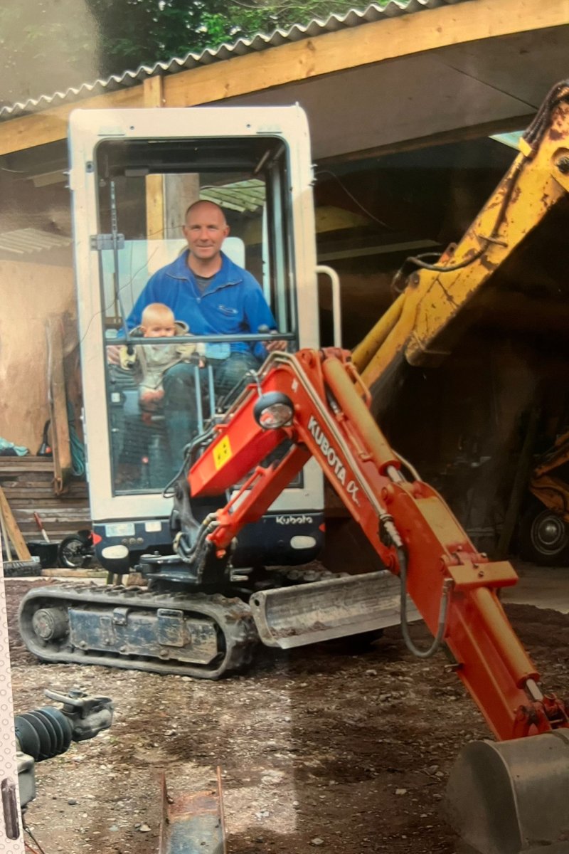

No idea on the missing paint, hadnt even thought about it until you mentioned it! great photo! Ive been desperate to get working with mine but the ground is like a marsh at the moment!. Do you have the manual in a digital format or paper?
Manual. Any issues we can sort it
