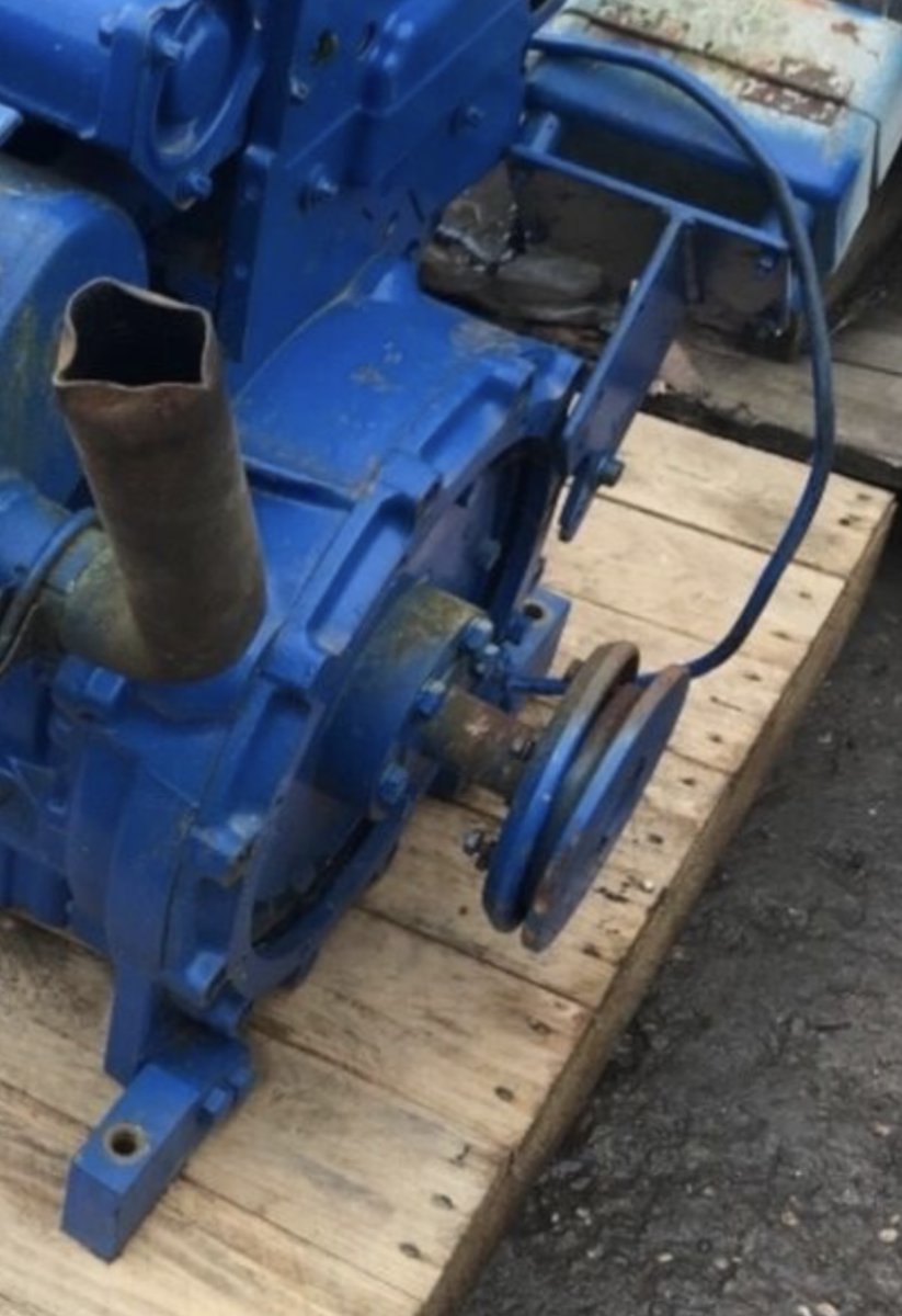

Like this! It’s what we called a silent pack engine🤷‍♂️ to me the reduction looks a bit more than 2-1?

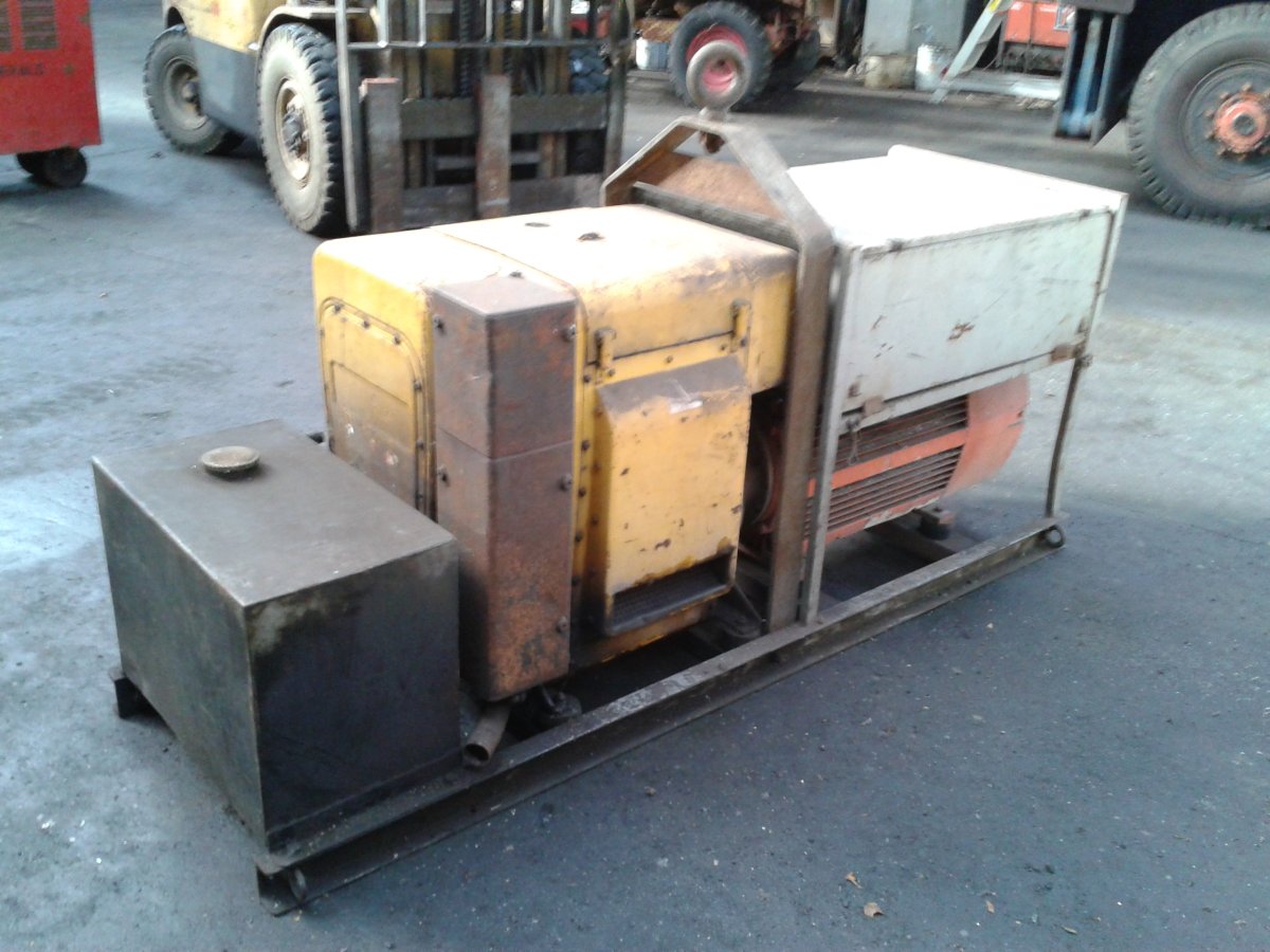

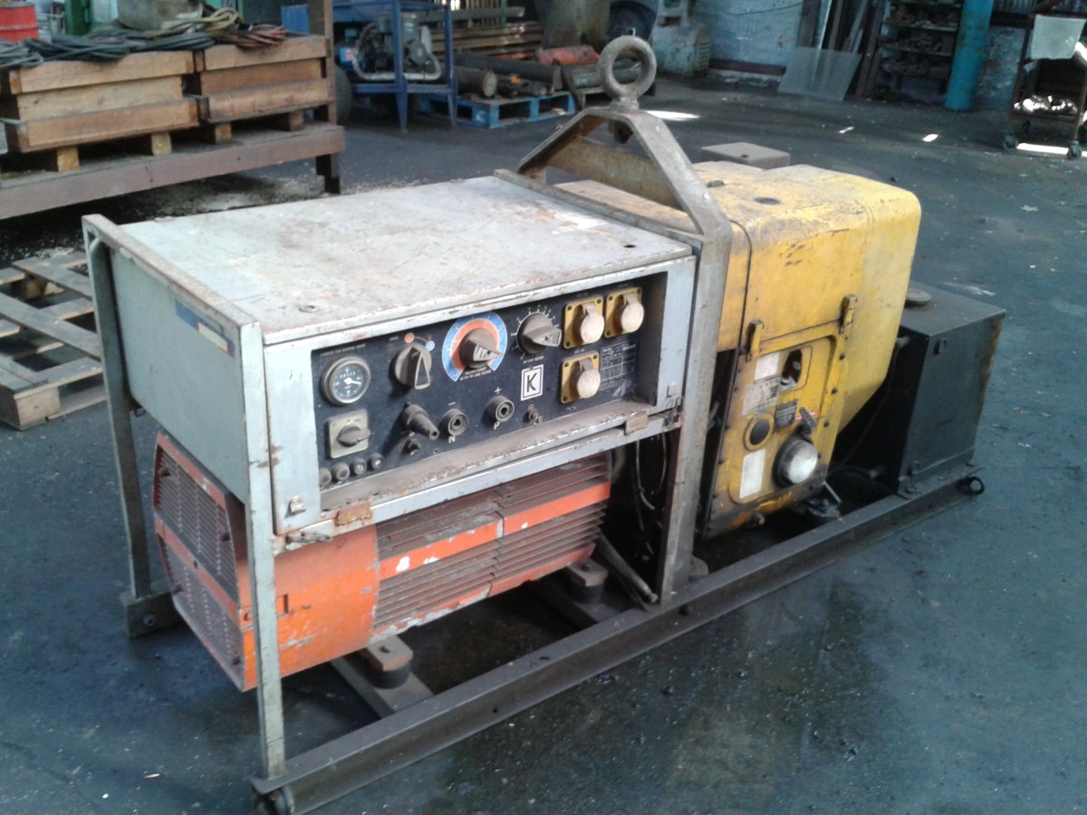

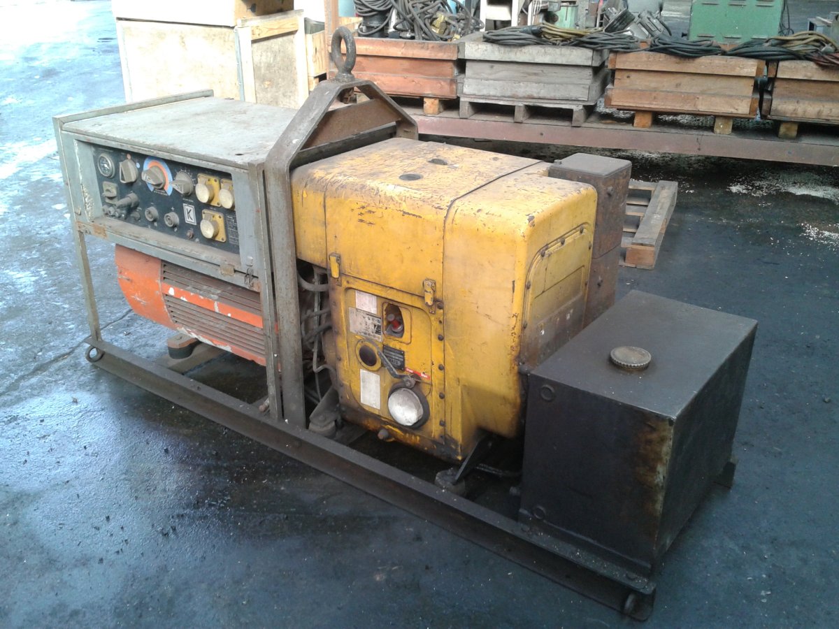

used to have a twin lung silent pack on my Elin welding genny ... never needed to have the covers off it though

Yes that’s it exactly very same engine.
Thanks for all the replies
It’s driving a big hydraulic pump.
The pulley is not mounted directly to the crank it’s definetly offset.
