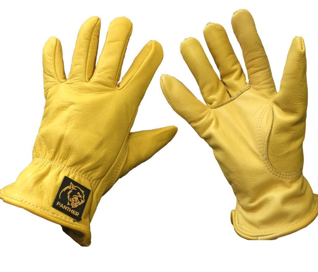

I like these
https://www.safetygloves.co.uk/A271...MIzqq_-d_44AIVz7vtCh3_jgLIEAQYAyABEgJGd_D_BwE
and similar, like the Parweld Panther gloves.....
very comfortable, relatively warm and will stick a fair bit of abuse/work ... great gloves if it's cold enough to need them .. always keep a pair in the car ;)
