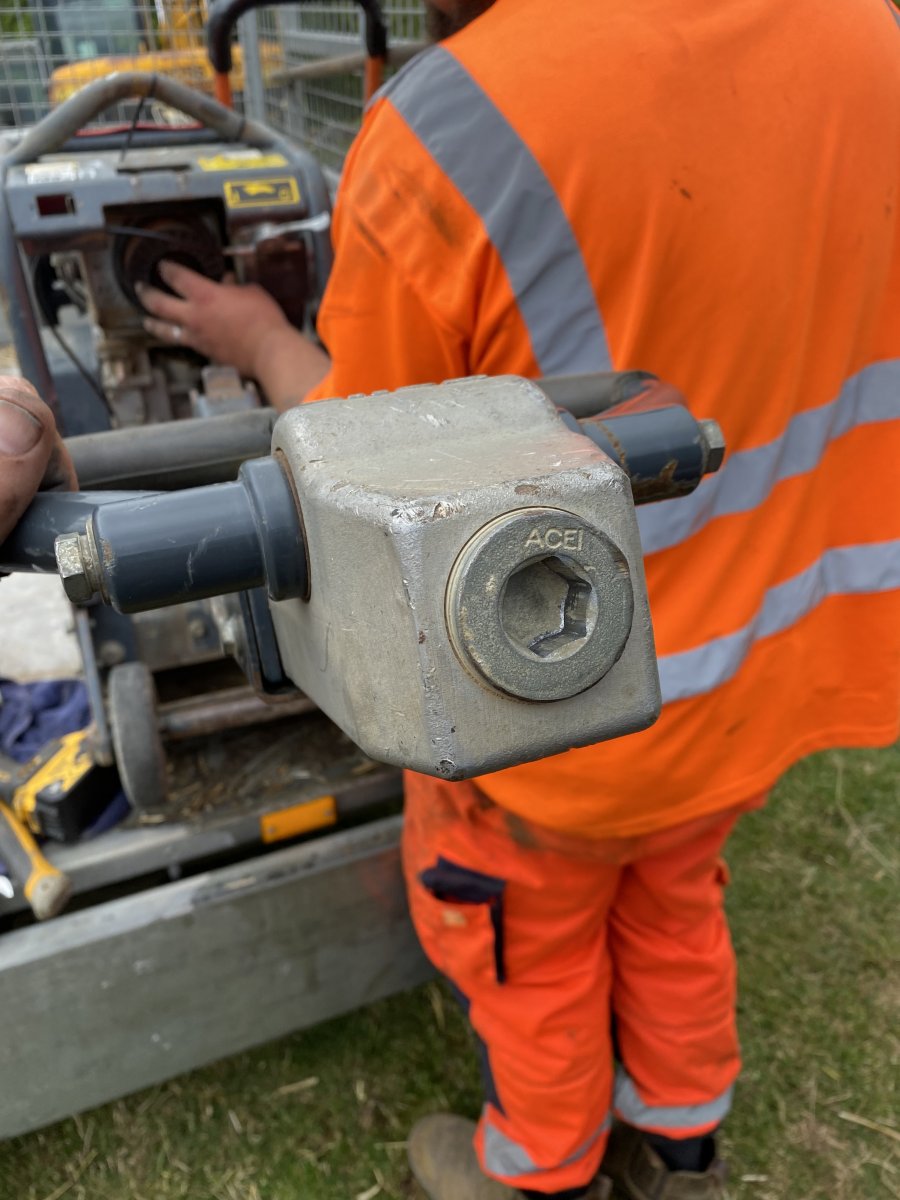

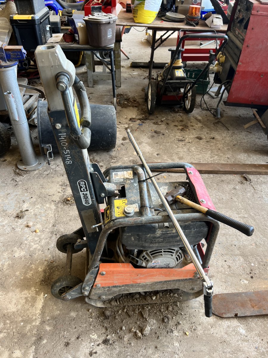

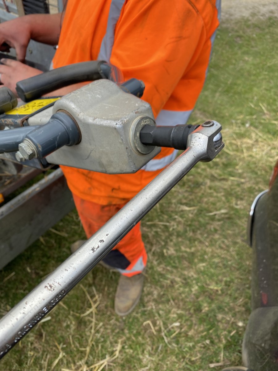

Now you got to bleed it, it’s like a brake system! Bleed screw by the hose, fill the reservoir, undo screw push do up screw!
Top or bottom end?Now you got to bleed it, it’s like a brake system! Bleed screw by the hose, fill the reservoir, undo screw push do up screw!
any air to bleed out?Changed the awkward pipe no longer leaking but still no reverse annoyingly
