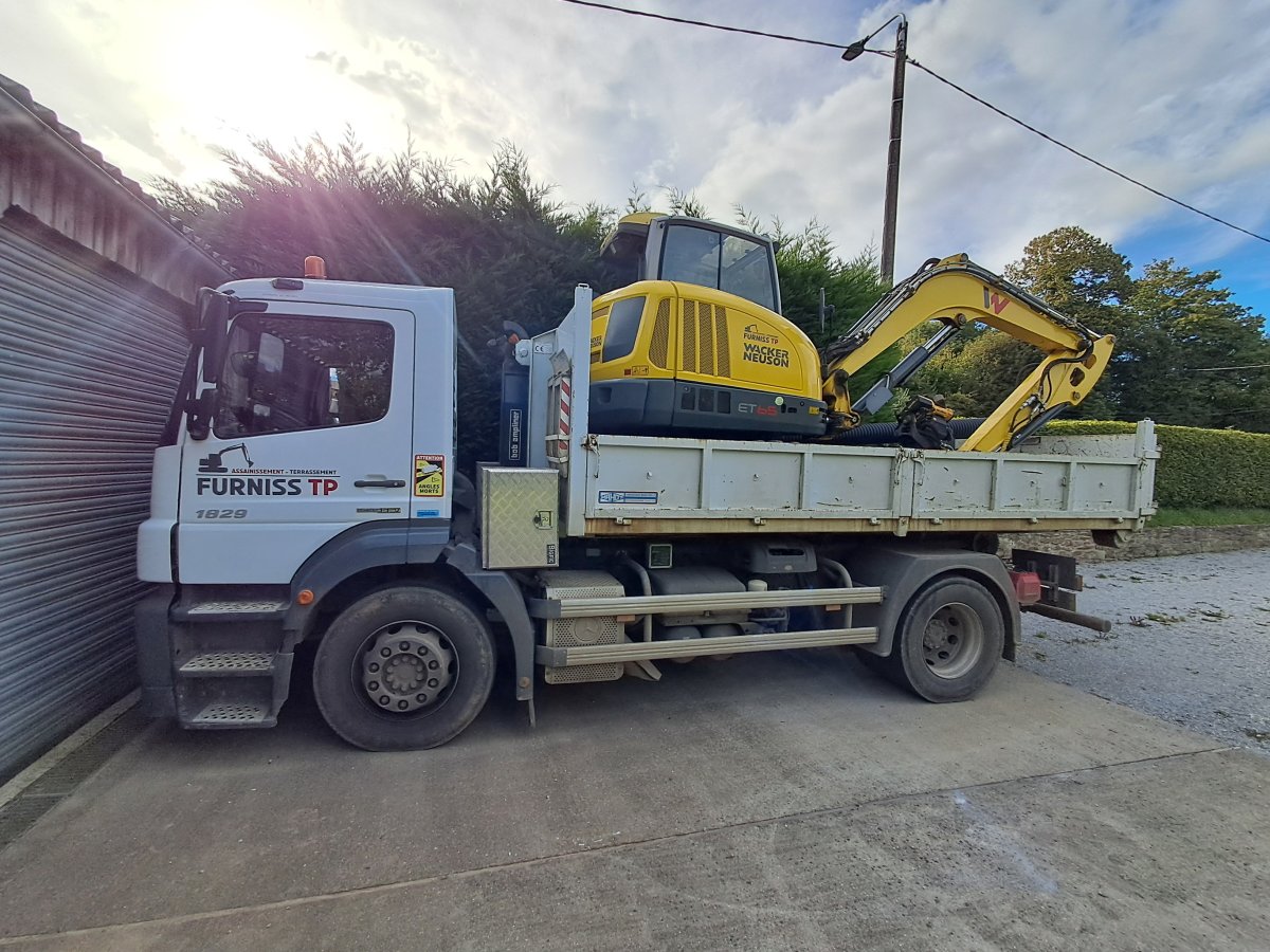

Wouldn't change mine its been perfect and big change for the easier for us !
5m bin - goes everywhere - easy to park on jobs - often 6t gets stored on it the weekends:)
