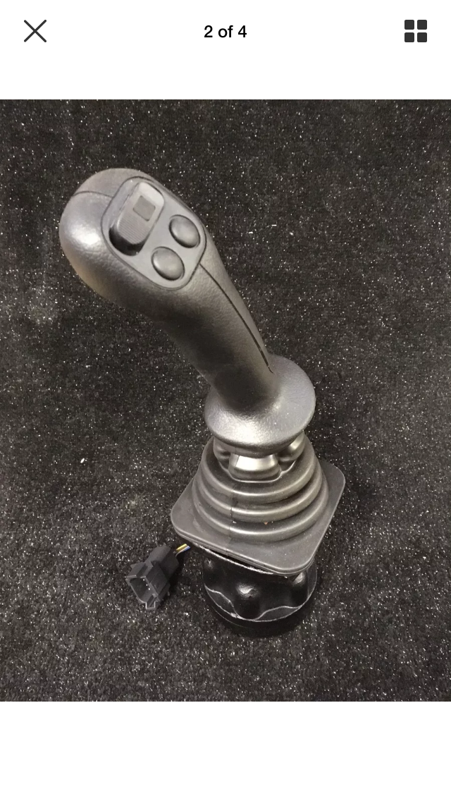

I currently run a Takeuchi 216 with 2 aux lines one of which runs off of the right hand joystick to operate the tilt. I’d like to stick a grab on my machine and either add an extra line for the rotating option or if possible change the left hand joystick to the same style as the right with the proportional control. It’s well out of my league just wondering if anyone could shed some light
I run a joystick like the one below
We think it may be a Kawasaki joystick

It's not just a case of adding a joystick with a roller. It needs a controller, proportional solenoid etc.
My recommendation would be call your dealer and ask for a price for a kit to do this. Or someone like mog suggested, summit.

Thank you for all the help chaps , I’d never undertake doing it myself was just wondering if it was do-able
