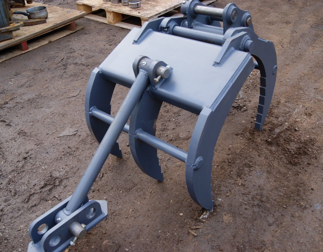

Anyone have any info on digger thumbs? Thinking of making or buying for a JCB 803.. Any thoughts?
I have one on my 3ton Kubota and rate it very highly. Wished I had gone hydraulic rather than manual.
After I had the Engcon fitted and started using the Scandinavian style buckets it was taken off and it is not used as often. But when it comes to tree and hedge clearance it is straight back on!!

Not sure about that mate. Have always used a proper grapple. Can’t imagine doing what I do and messing about trying to pin stuff against the bucket.
Where did you pick up your grapple? Or was it a home build?

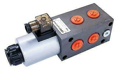

A solution that I need to sort is the diverter!!!
well you have a wide choice of those available ... leccy or manual .... but the latter'd be a bit of a faff :rolleyes: (to operate)
Got any spare buttons on yer sticks ?
https://www.ebay.co.uk/itm/Flowfit-...081644?hash=item48c6ddfa6c:g:9oIAAOSwlN9ctdgV

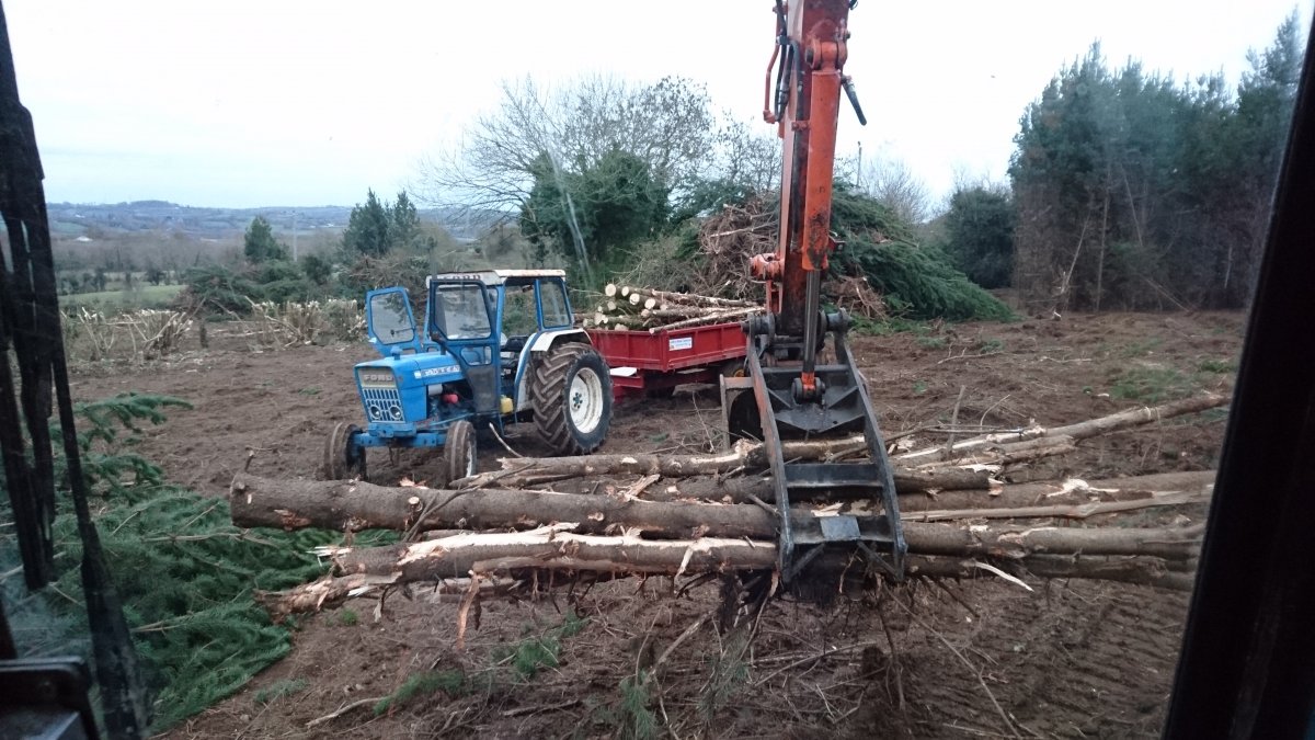

Well Fellas here's my thumb on the EX60. It a great job and really wouldn't want to be without it.
