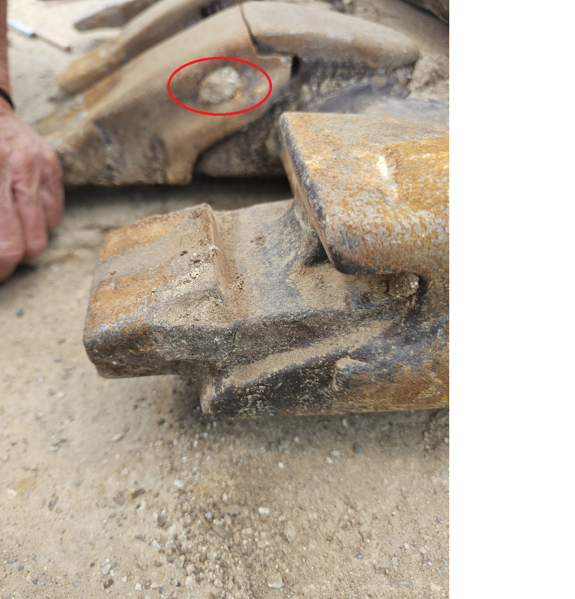

Hey guys, I m trying to figure out what kind of adapter teeth are these, on my recently bought used bucket. I will upload a few photos and I hope for the best.

The bucket was originally fitted on a O&K MH6 PMS. Then I bought it for my Volvo. I m looking for rock teeth but I don't know what to ask for.
New one on me. If you can stretch to it cut the adapters off and fit some K type.
could it be an old Akerman .. they made buckets for O&K
Christopher Harris
Christopher Harris

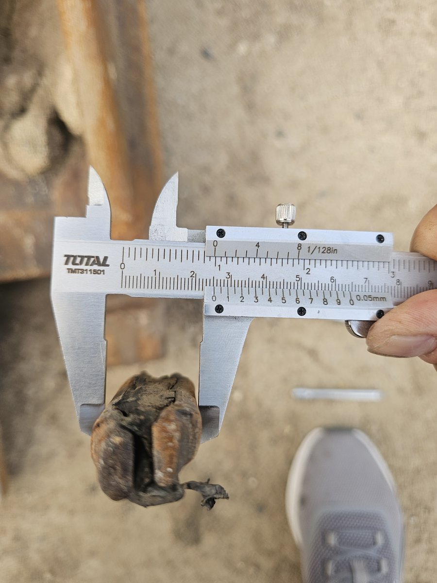

It's difficult to identify them with certainty just from these photos, but they do resemble a CAT J-series style adapter. A few measurements of the nose and a side photo would help narrow it down. Hopefully someone here has seen this exact setup before.

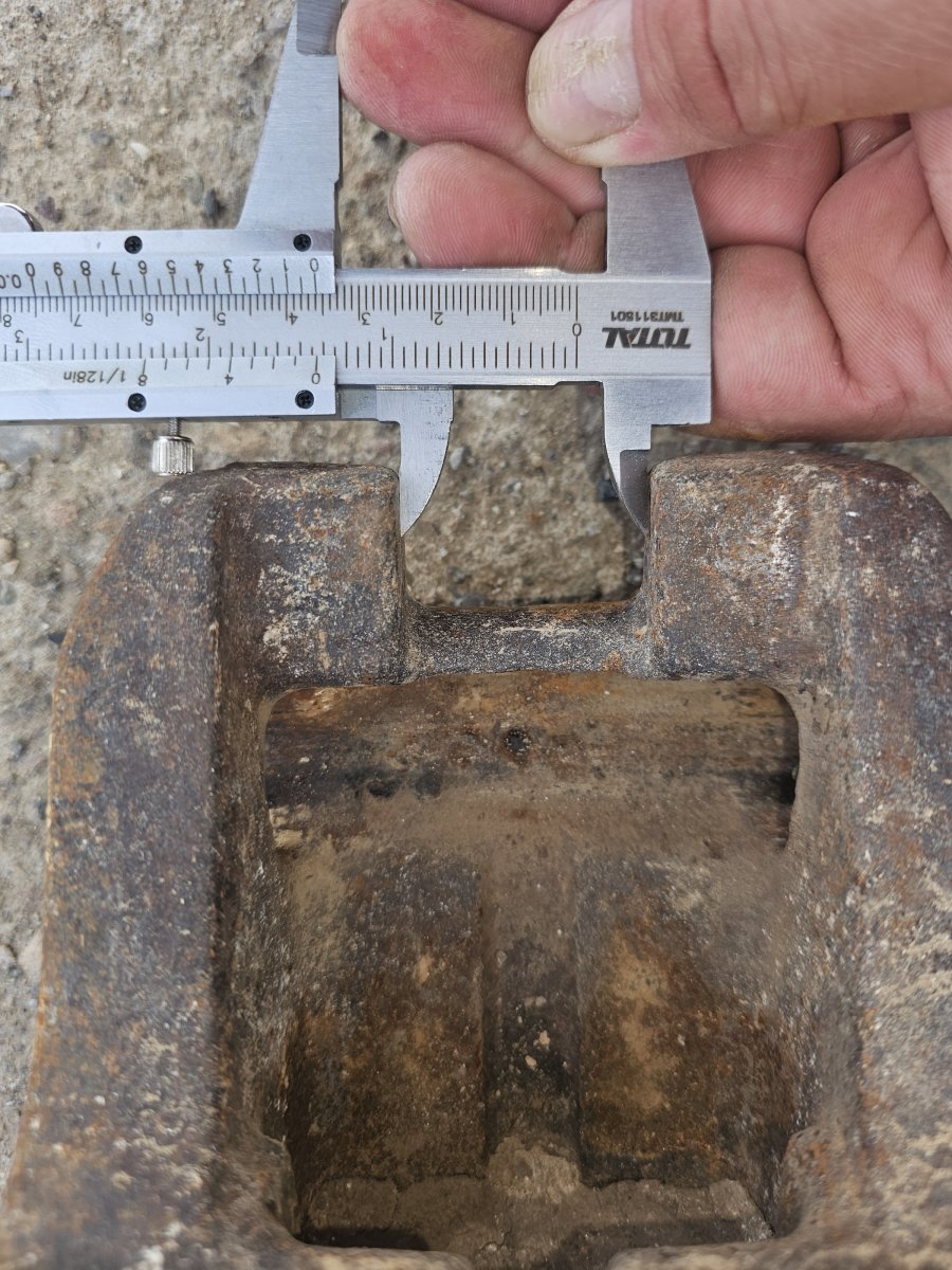

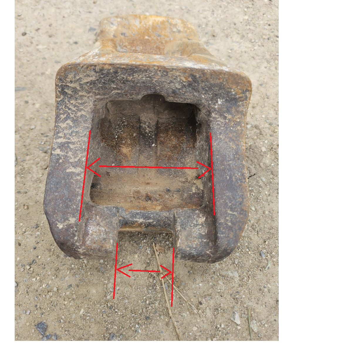

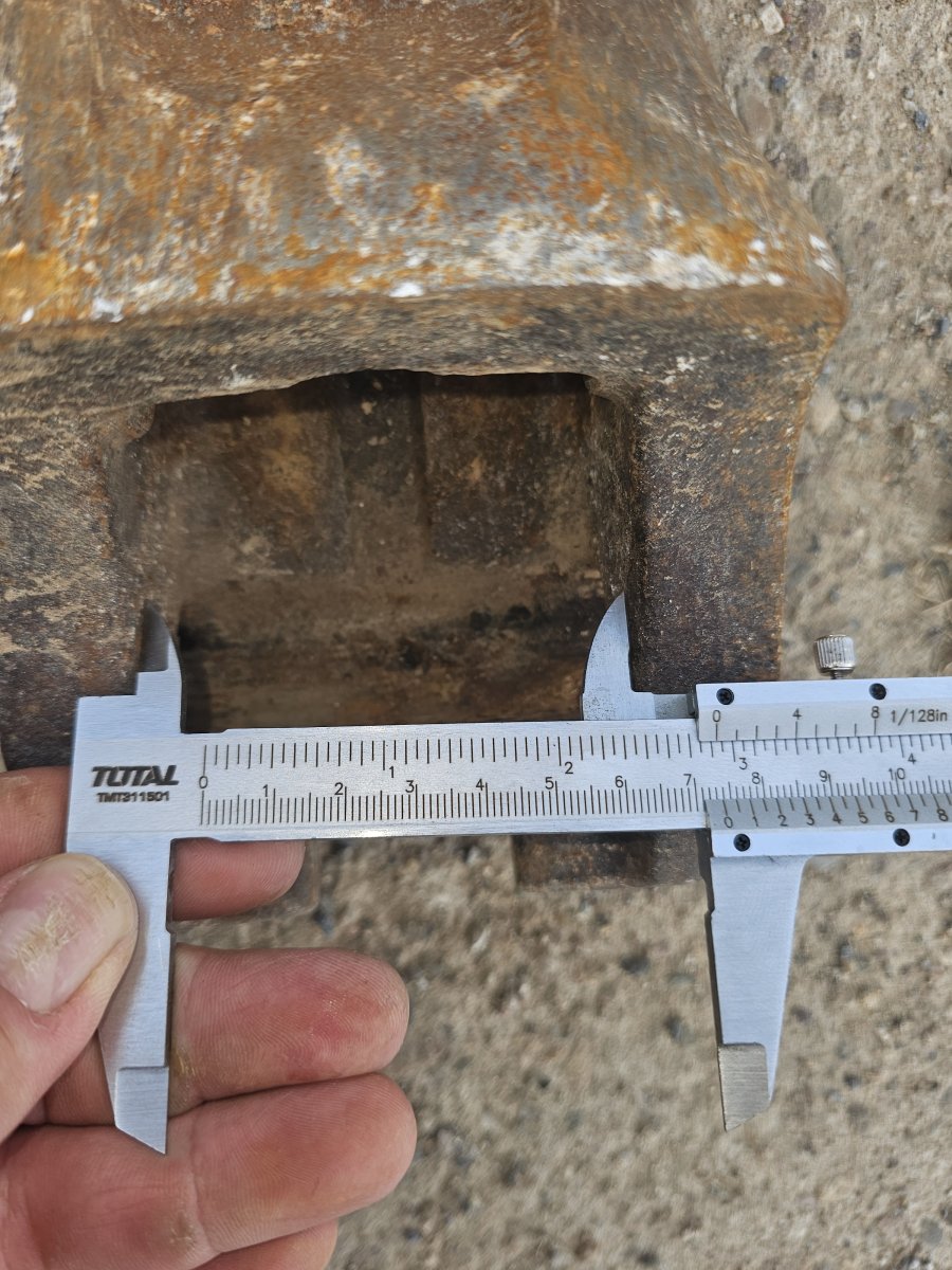

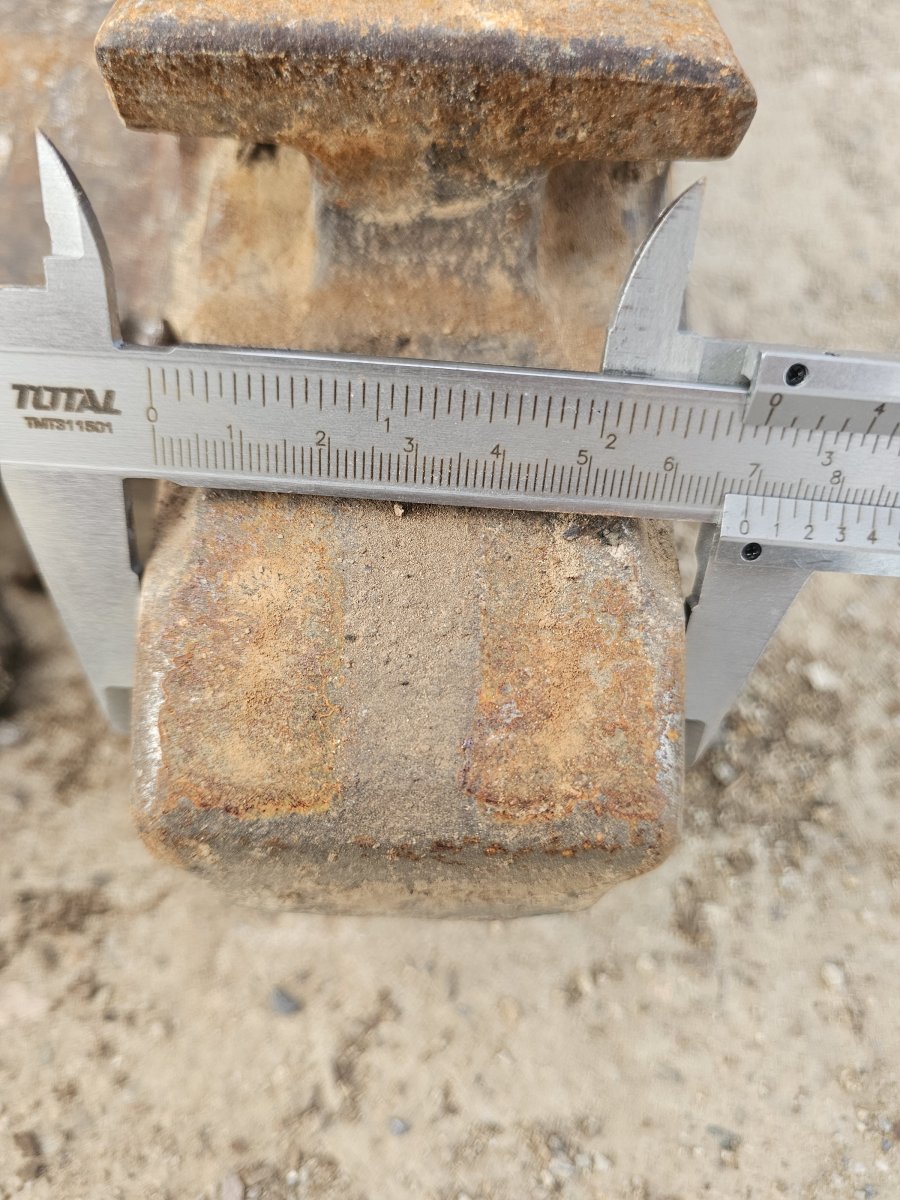

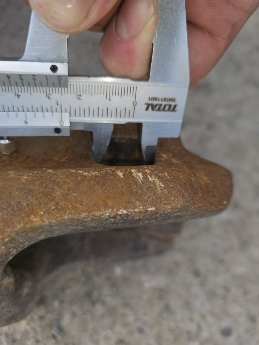

@CPS please check the attached photos. I m measuring with a caliper. I hope it helps.
