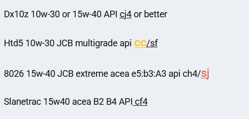

Looking to do all my own servicing and it turns out all the machines want different engine oil
Dx10z 10w-30 or 15w-40 API cj4 or better
Htd5 10w-30 JCB multigrade api cc/sf
8026 15w-40 JCB extreme acea e5:b3:A3 api ch4/sj
Slanetrac 15w40 acea B2 B4 API cf4
None of it is available at Halfords or any close motorfactor but is there any single oil that could just be used for all of them

Understanding some of those spec's helps a lot.
SJ is a petrol engine spec. "S" identifies it as petrol, J is the revision. The spec started with "SA" which is now described as "not suitable for engines built after 1930". The second letter incremented a letter each time the spec improved.
The same goes for the diesel oils the start with a C. So your CC oil's spec is very old (1970's). So a CD is better than a CC and a CJ is better than a CH.
Almost always, they are backward compatible, (but not forward) - where this falls apart is when the oil is a semi or full synthetic and is just too light for an old school engine.
I think CH is the minimum spec for an engine with a DPF
As for the word "multigrade", all those oils are multigrade. A 10W oil is a single grade (suitable for a narrow temp range - perfect for the front forks of your motorbike or a gearbox). Anything with two numbers (0W-40, 20W-50 etc) is a multigrade.
