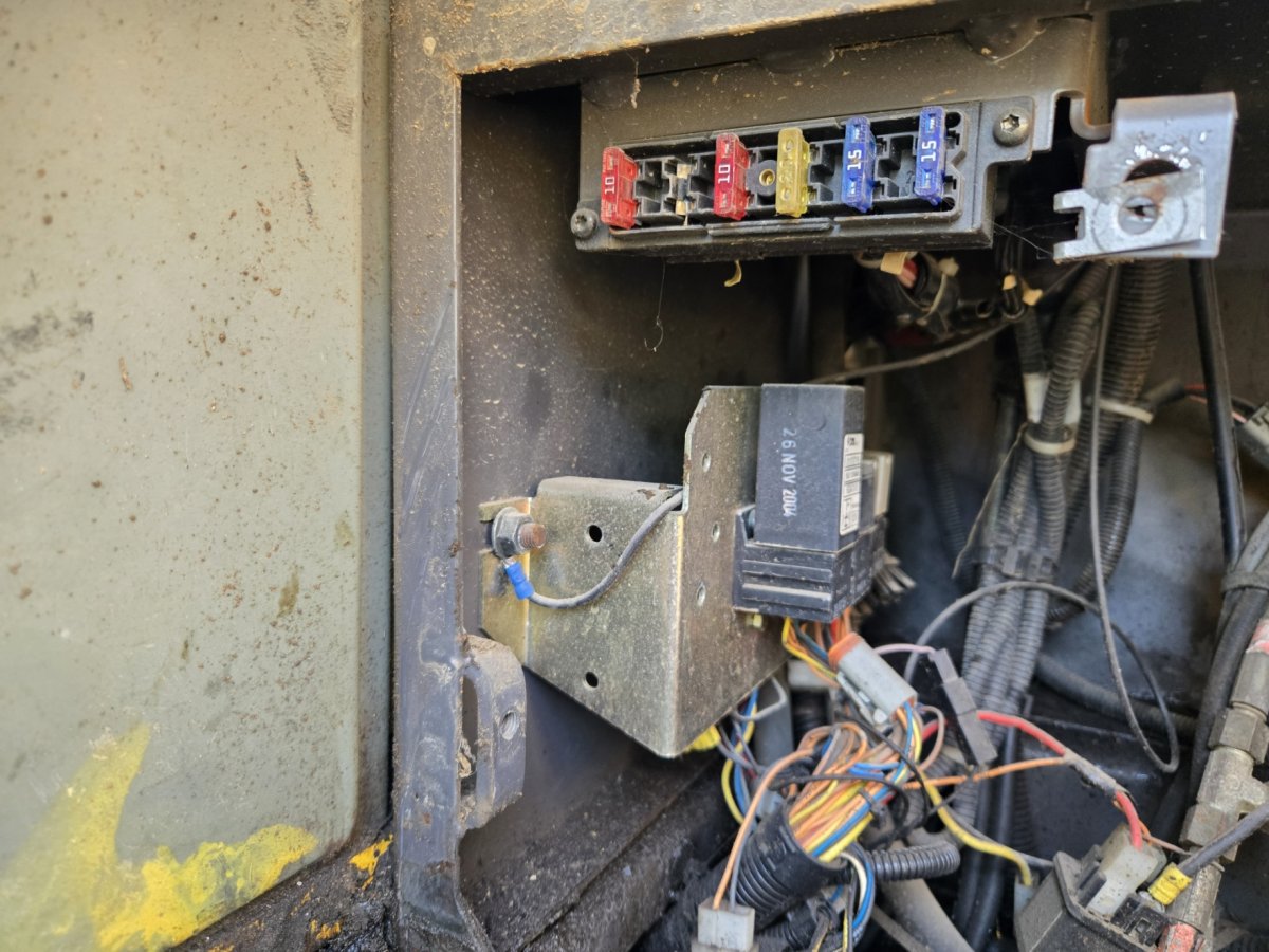

Guys hope you can help me out. My Volvo EC25 (2003) hydraulics stopped working when I was working - (engine still running). Then I turned off engine and it won't crank. First thing I checked was dead man switch but it seems fine - (I have not checked wiring yet, just switch). I was checking the fuses and the fuse number 2 (7.5amp) was blowen. I swapped out fuse but it blowen straight away when I turned ignition on. Does anyone know what fuse number 2 is for? and would it have anything to do with the starting circuit? I could be doing with a wiring diagram if anyone can kindly supply to me. I have attached photo of fuse box - Fuse number 2 is the second from the left - (I have fuse removed in photo).
