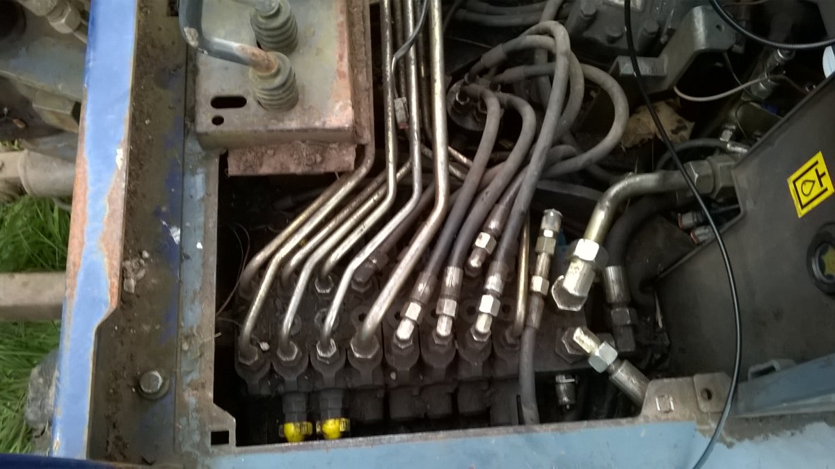

You’ll have to clean it thoroughly, ideally with a steam cleaner, and then watch for a leak when you run it. Remove all the side plates and base plate if there is one to make it easier for the water to run out when you clean it- possibly jack the machine up with the boom so there’s a good angle to drain it.

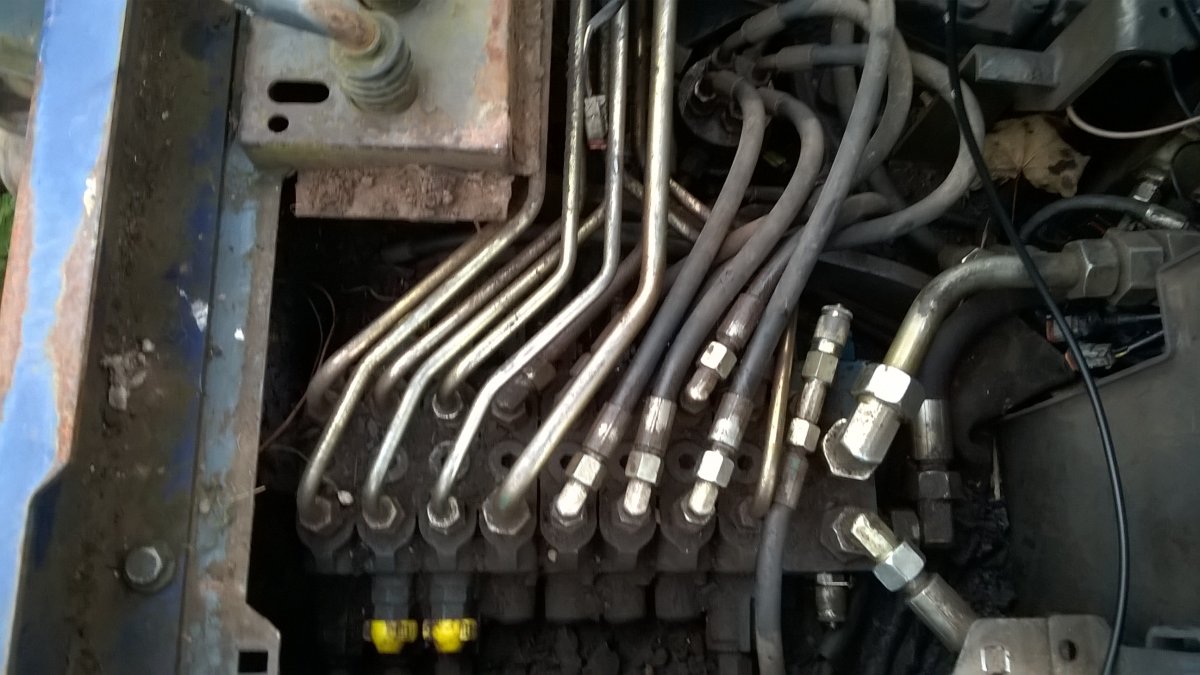

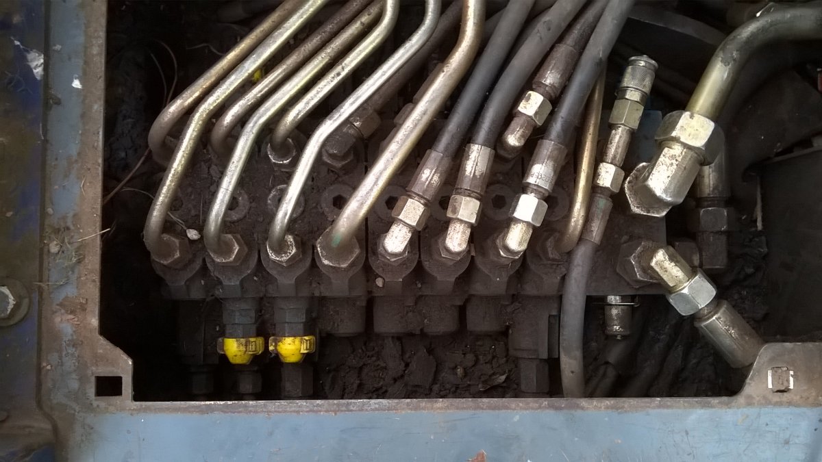

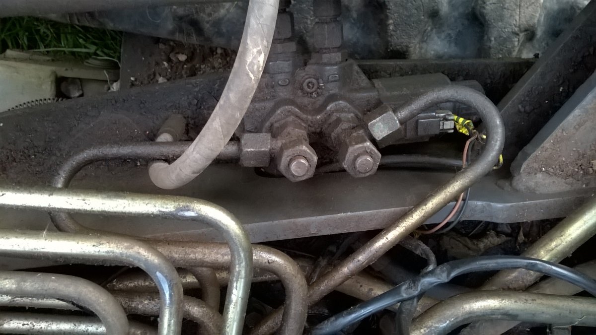

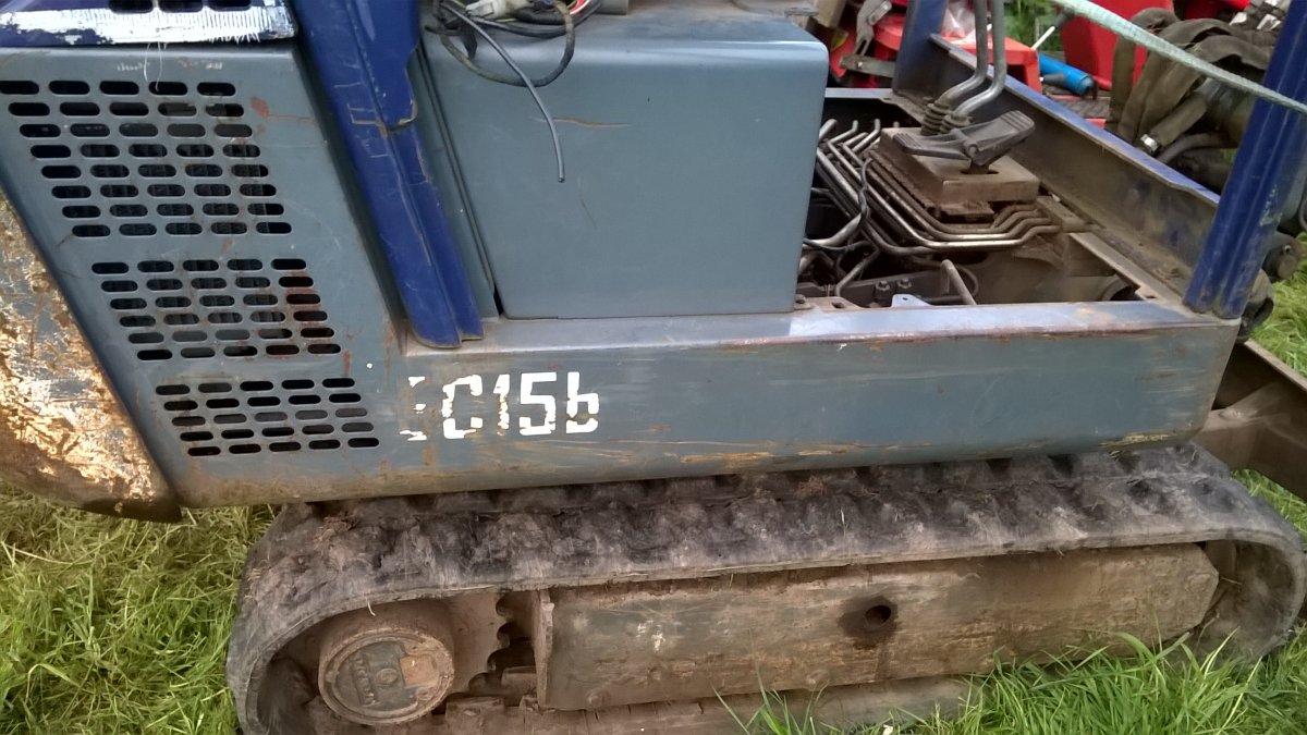

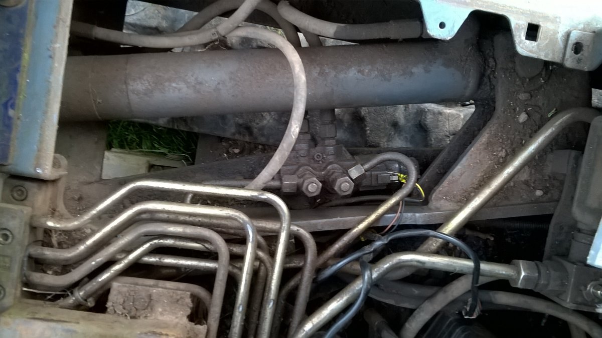

this is what's under the floor of the last EC15 I looked at .... plenty of places to have a leak from :rolleyes: - apart from what's under the carriage too :( .. good luck - as said getting the beast clean will help dramatically

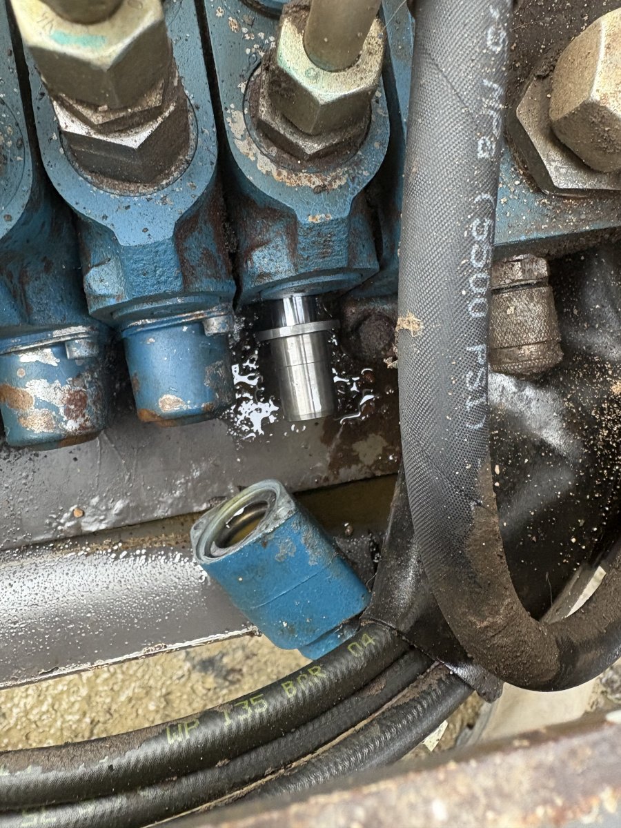

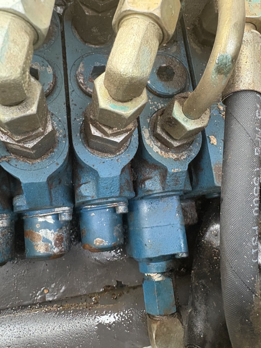

Managed to pick up the machine yesterday morning had a look at it today couldn’t see anything obvious at first glance however most of the damp appeared to be under the valve block towards the centre of the machine. Had a good dig around and found a couple of loose screws on the side where the access panel is so I stripped that bit off didn’t have the correct size o ring so I’ve noted the size and put it back together, don’t seem to have any leaks at the moment. I’ve washed it down just goner let it dry and check again later! Fingers crossed.
The bit that was loose below in pics
excellent ..... looks like you have gotten it nice and clean

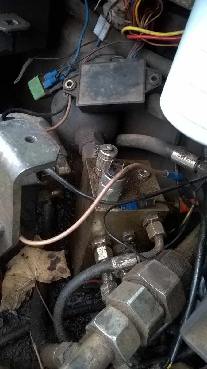

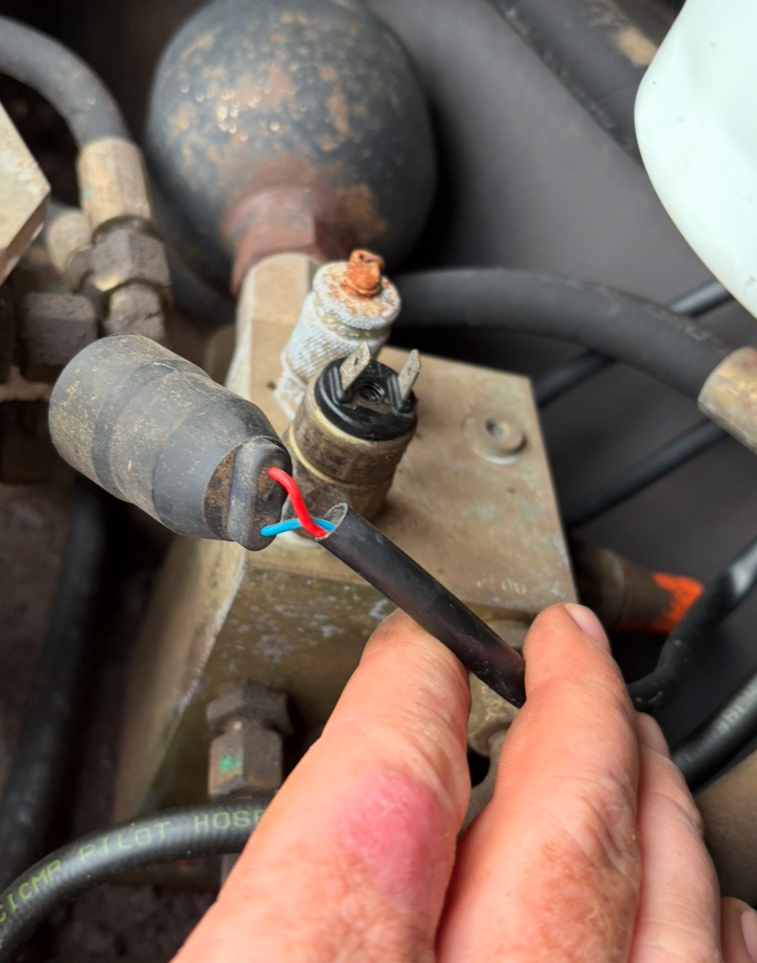

I also noticed this and believe this should plug in, is there any reason this wouldn’t be plugged in?
I noticed it unplugged on v8druids photo also
Regards
Dan

not my machine that .. friend's down the road .....
that valve is, I believe, the servo pressure reg./distributor ... that MIGHT be the dead man servo solenoid?? but looks more like a pressure switch to me, TBH ... quite what for though, I've no idea -- Aiden @CPS ????
