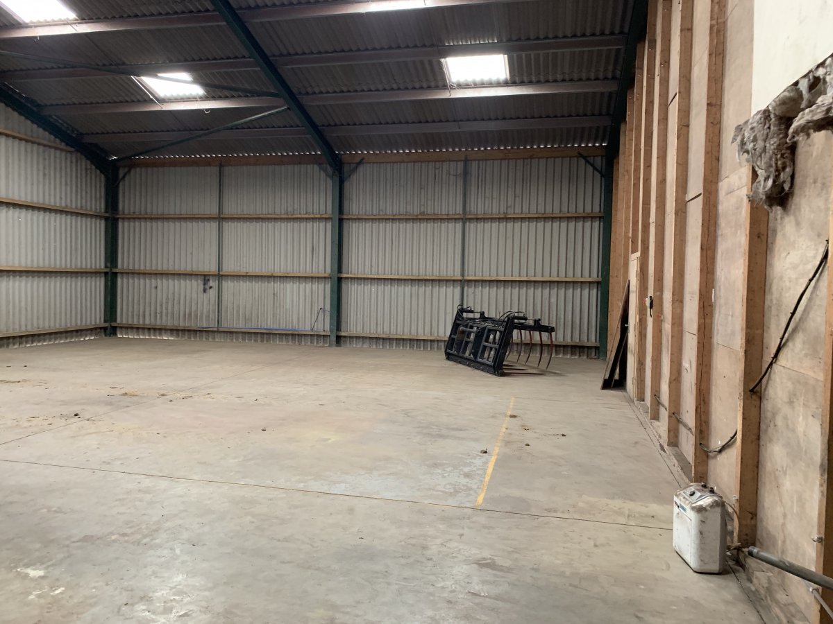

Luckily there is only one exposed part the rest is in a actual compound all locked up. There is a 12 meter run that is accessible.
I priced up some brick work £1350 to around 6 ft.
The mesh is circa £800 just trying to work out what’s best
There would be items of fair value in there and desirable but also big so not the sort of thing you can just take away. There will be police response alarms and sensors etc but just trying to slow them down as much as possible
That’s the run ( far wall) the rest is inside the yard

I’d agree with concrete panels - you’d only need 4 bolted onto the inside of those posts. You’d need to come very prepared to defeat them - whatever you put up can be overcome if the scumbags decide they’re having it away.

If you're storing plant in there they'll just come through the roof, start a machine up and smash that lot straight out the way.
Concrete panels not too pricey, very easy to install and always worth money. I'd get them made up to fit between the I-beams. Once you've removed the cladding you might be able to wiggle two into each bay diagonally without having to remove the first roof bay- then just reclad down to them.

Concrete panels would be an easy job to put in from the inside. I’d not clip them in that particular instance, but retain them with some channel irons at each end (in the corners of the building) and use a bit of flat in the middle. Weld it to the upright so it pretrudes out in the gap between the panels in the Center of the building. Then once the panels are in, weld some flat up each side. Job done(y)
I may need to do a diagram to explain this better :D
I know you said anything used could be boxed in, but these won’t need any further dressing up, perfectly adequate how they are. Even covering up mesh has a cost, in materials and time.

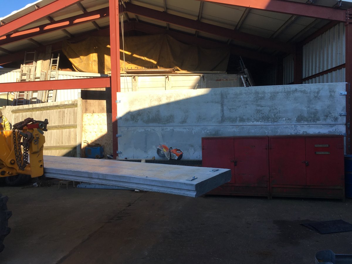

End of our workshop, which is a bit of a work in progress :rolleyes:, those panels have been in a while, and we’ve only just got the cladding for the end! :D

so they're ordered to length are they James ... what's the ball park cost of those ... instant wall ... what're they like for fixing to inside ?
Yes you order them to length. Easy enough to cut if you need to, but if you are ordering for a specific job then it pays to get the length perfect. Iirc they were mid to late £40s per meter, + transportation. Say £50 per meter plus transport if your just working things out roughly. But I’d get a firm quote per meter, as they were a while ago.
By “fixing” I guess your talking about drilling and fixing to the inside? No different to drilling and fixing to any other concrete product (y)
