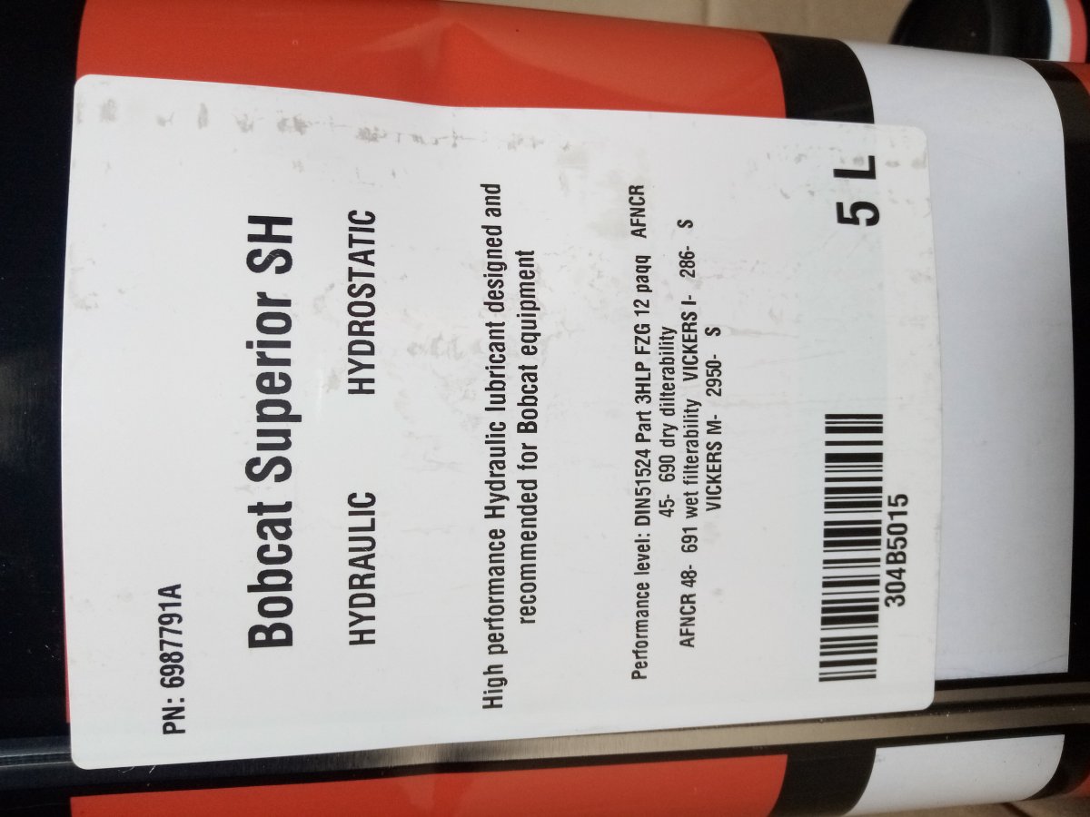

Are hydraulic systems sensitive to what oil is used or can I top up the dumper with bobcat oil?

This is the bobcat oil

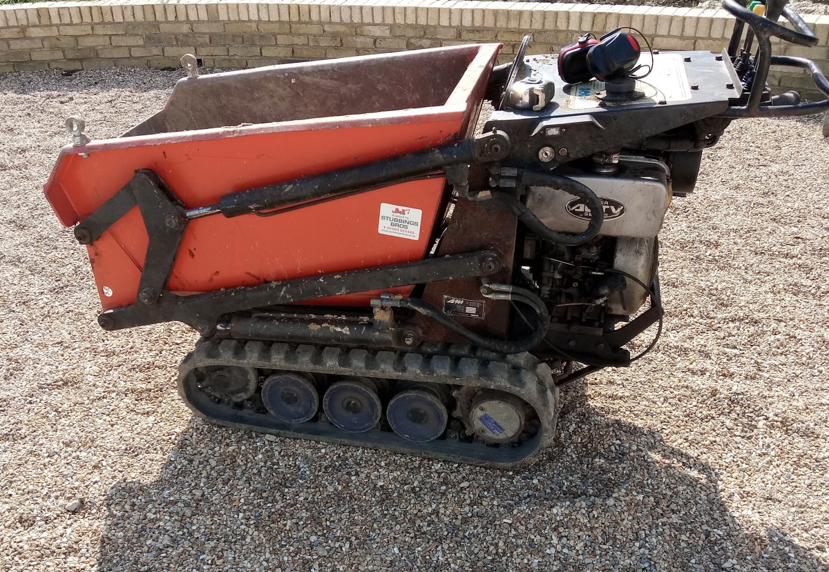

that's the way I'd have it set up too ... drain at six o'clock and then fill level plug gets filled 'til it over flows ..... but his book says drain at 12 o'clock, which'd alter the fill level, unless the the holes are at 90 to each other - 3 / 9 and 6 / 12 o'clock ?? :unsure: ... I'd expect a filler to be more like at 10/2 o'clock though, with the drain at six :confused::unsure: ... any chance of a pic @Russell ?

usualy 3 holes ,drain,fill and level 12/6/9 o,clock did mine last week was fkin stinking

It doesn't say anything about servicing them on the manual. I got the 12 and 3 o'clock thing off youtube
Looks like 2 holes in this one
well drain it at six o'clock and can fill with it in same position ... fill hole will either be at 3 or 9 o'clock.... fill until it comes out the filling hole and the level will be correct .... same as a diff .. fill 'til it comes out the hole ;)

What about the hydraulic oil? Top-up with bobcat oil or order some specific oil?
can't see an SAE number on the Bobcat label ... I'd be inclined to get some as specified at SAE32 ... got a 45 drum here an' a few 20 cans, but not a lot of good to you, sadly :( .... or me much :rolleyes:.. Drema's on 46 bio and me other machines don't seem to use/lose much at all :unsure::)
