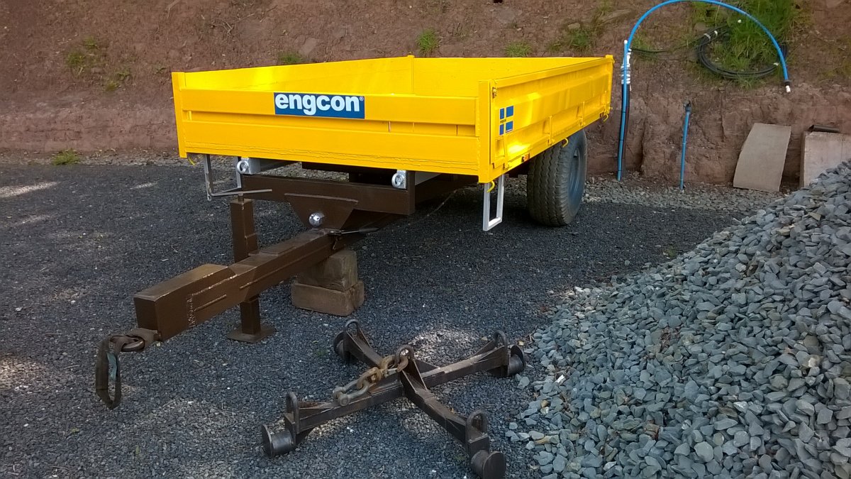

Worst colour to cover
certainly is ... had to put four coats on this :(
I'm shocked ..... used them for well in excess of a decade, maybe more and only ever had one problem with them ... opened a 20 of HBZP grey oxide, stirred it with the stirrer in the drill and was like water. Opened another .. same problem .. rang them and we had two replacements the following morning ... rep turned up a couple of days later full of apologies ... they'd had a duff batch that'd been wrongly mixed/missing pigments, etc. and we weren't alone - 1000 ltr batch, most of which had gone out ... anyways .. he left us four more 20L tubs and took the faulties with him .... and that's the only issue I ever had with them ... Trying to recall the carriers they used - blue and yellow 18t, 4 wheelers ... they were always pretty good too
Clarke's mebbe they are one of biggest hazchem/ADR setups.
What paint did you use?
Firwood's ... would have to have a look at the tin (or the paperwork) to be more specific ... wasn't quite as dark as I was expecting and like p*ss in the tin, even after a major stirring -- unusual as their stuff usually needs thinning :unsure::unsure::(

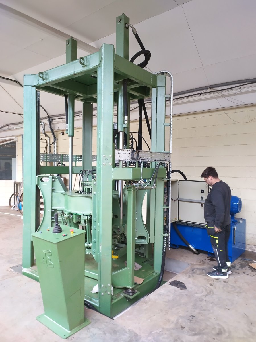

We're looking for different paint, trimite (firwood) are suggesting 2 Pak top coat acrylic paint for the machines we are building, is it worth it? It'll be egg shell finish.
Currently we're using hammer finish but we're not getting a good finish and looking to try something else.
how are you applying it Mike air or air less spray ... I used to find if you thin it too much you don't get the hammer finish unless applied liberally with air spray .... airless was better
Quattromike
Quattromike
Well member-known
Yeah we're using a graco airless sprayer, our paint facilities are pretty piss poor but thought we might try something different
that a diaphragm pump or hydraulic piston? .... never had a lot of luck with diaphragm units - had a couple and they were both piss poor ... can't recall the make, but it was a decent one - may well have been Graco -- slung 'em both in the skip when I cleared the shop ... diaphragms were a ridiculous price for a bit of plastic that went hard for a past time 🤬
the hydraulic one I replaced them with was awesome - and so reliable as long as you kept it clean
trouble with going two pak is you will need 'proper' facilities to deal with that :rolleyes:
