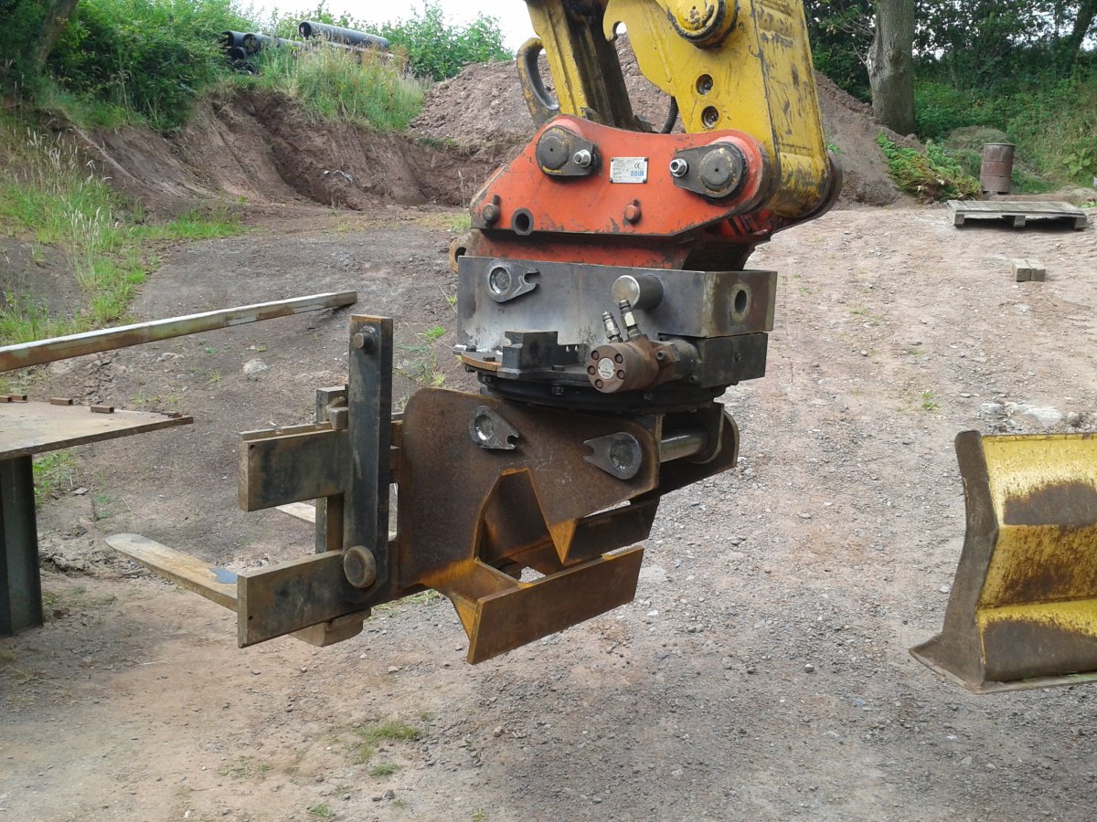

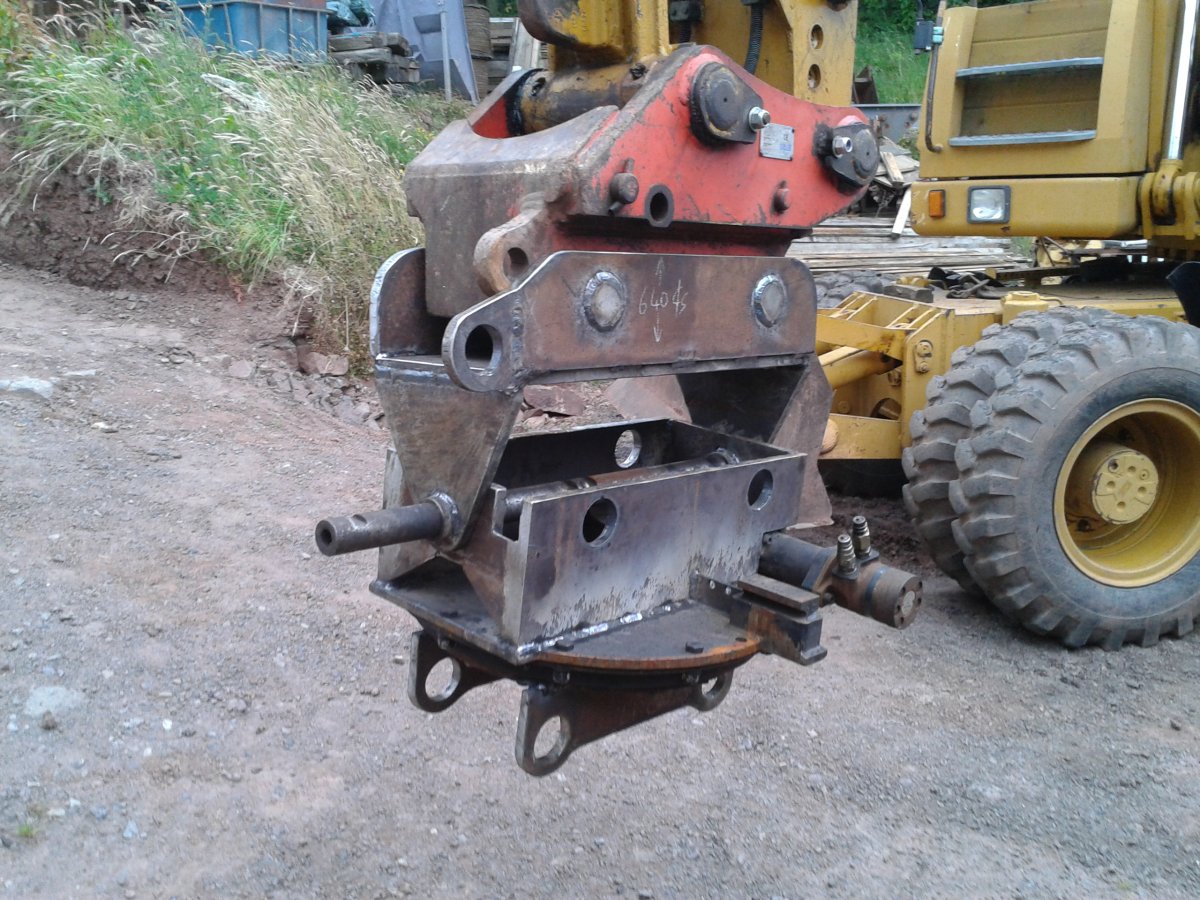

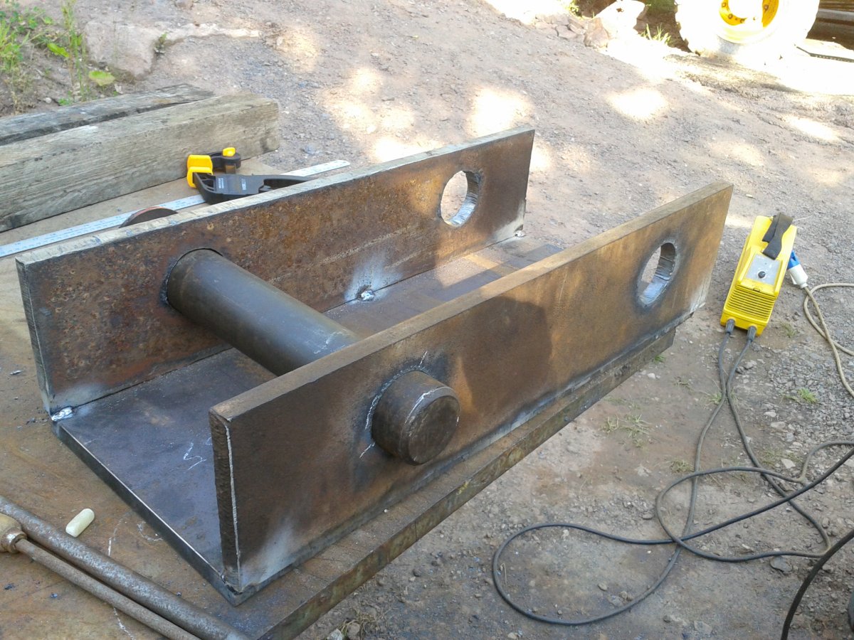

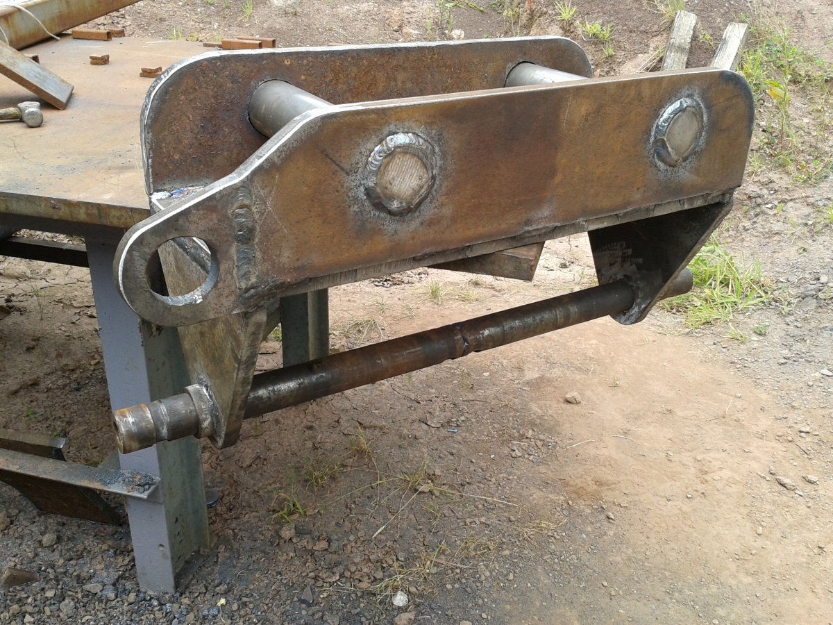

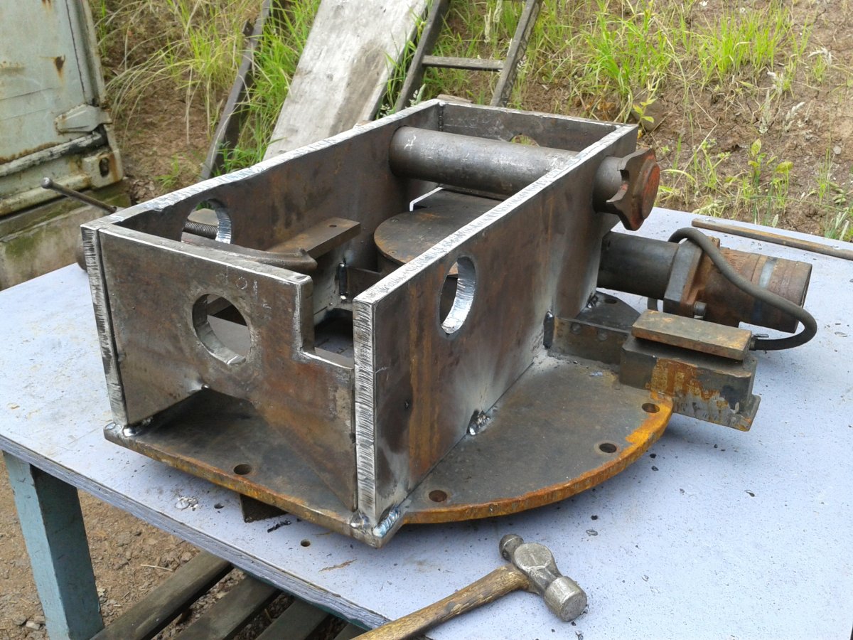

The finished build height of the hitch looks better than it was originally.
Although if you were to put a price on the value of labour for such an talented designer & fabricator I’d go so far to say that Gra has duped himself as he’d of been better of buying an Engcon off the shelf & spending his time making simple stillages or dare I say it re-shanking spades for sale on EBay!However long your time took…..£1800 is a bargain!!

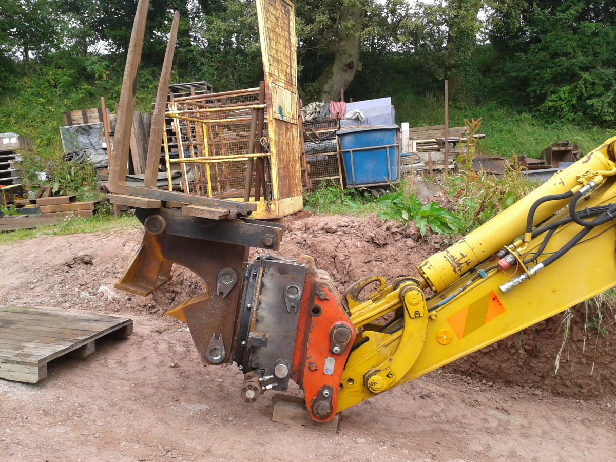

so I'm pulling these sort of lumps out of the bottom level of my dig in pursuit of a flat yard
View attachment 55046 and give it a little too much, trying to loosen a big un from the clay bed they're sat in and .........
as promised ... here's a bit of a wart
View attachment 55047 View attachment 55048

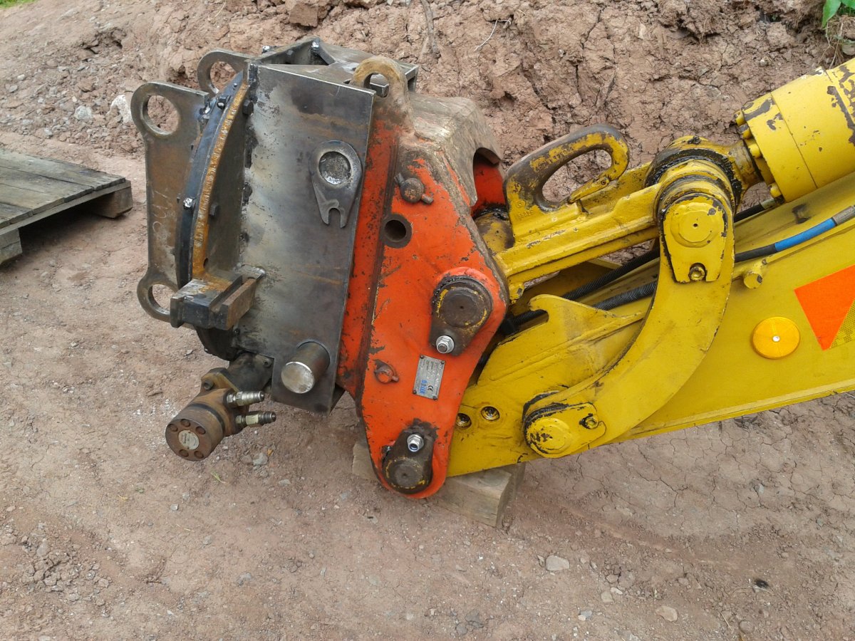

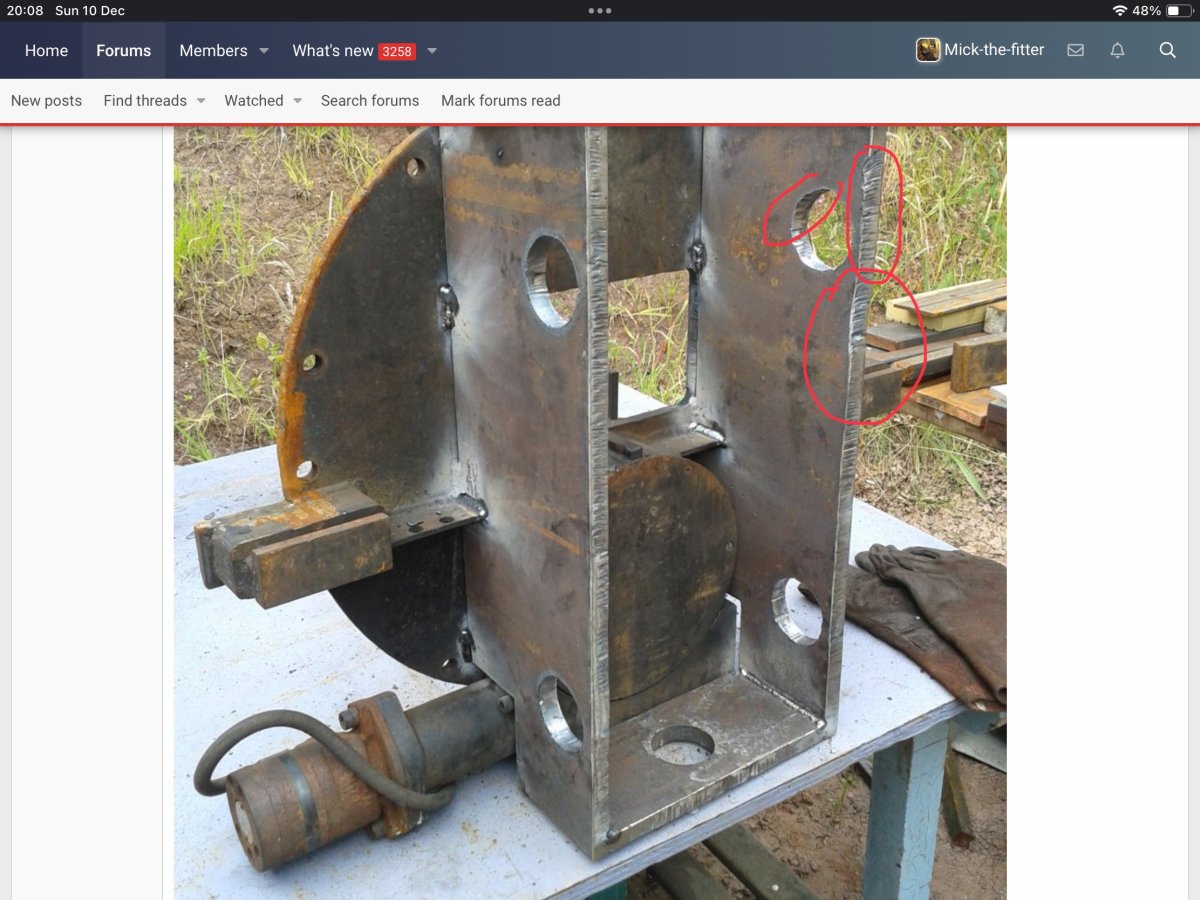

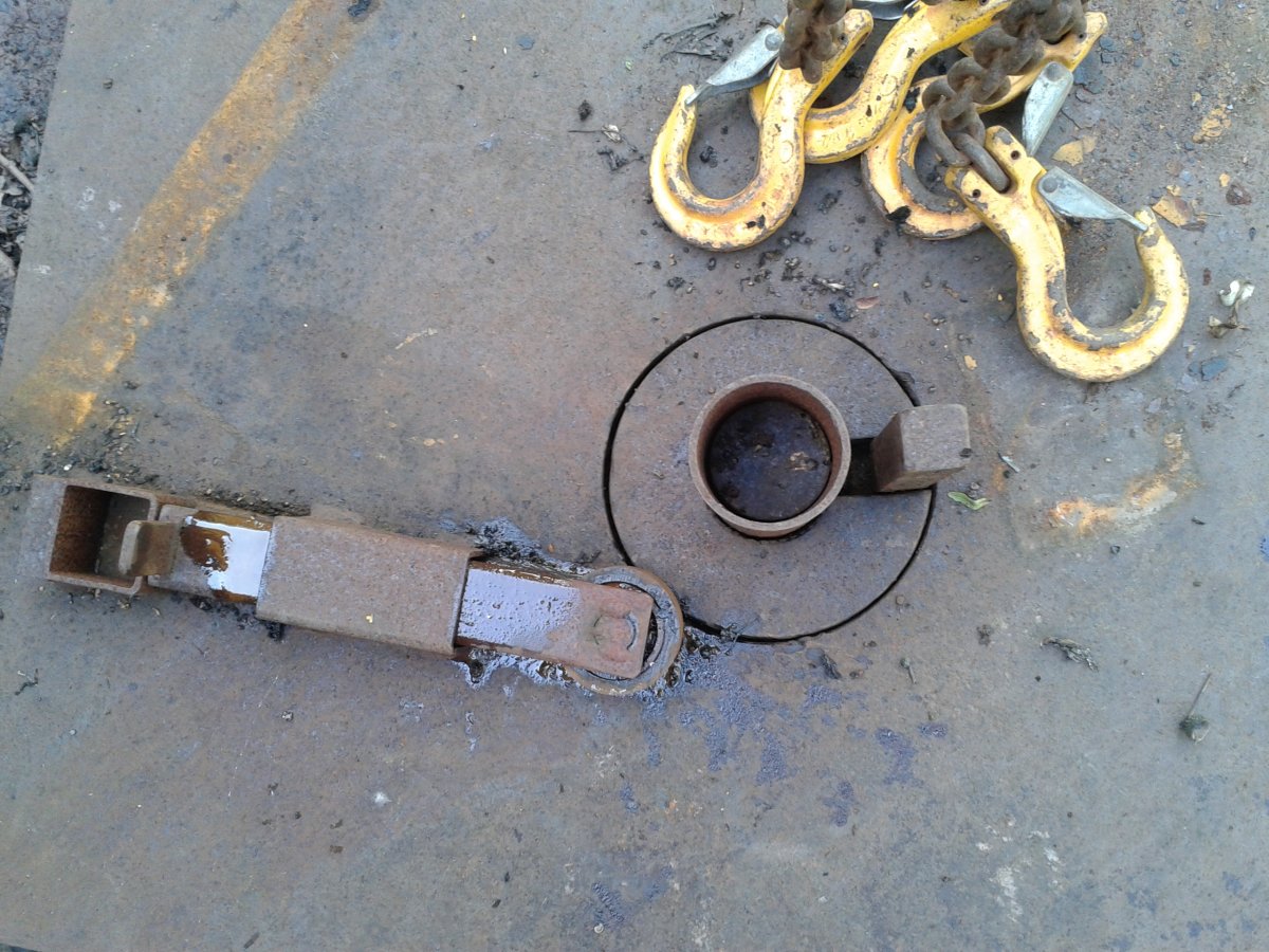

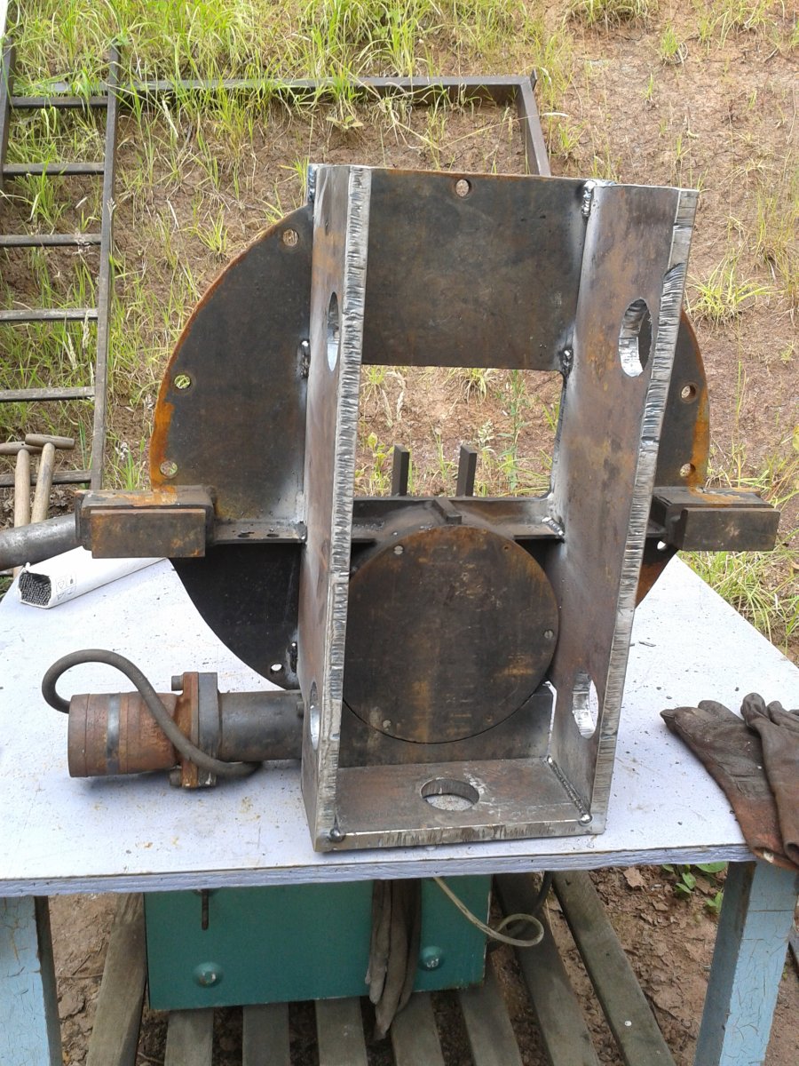

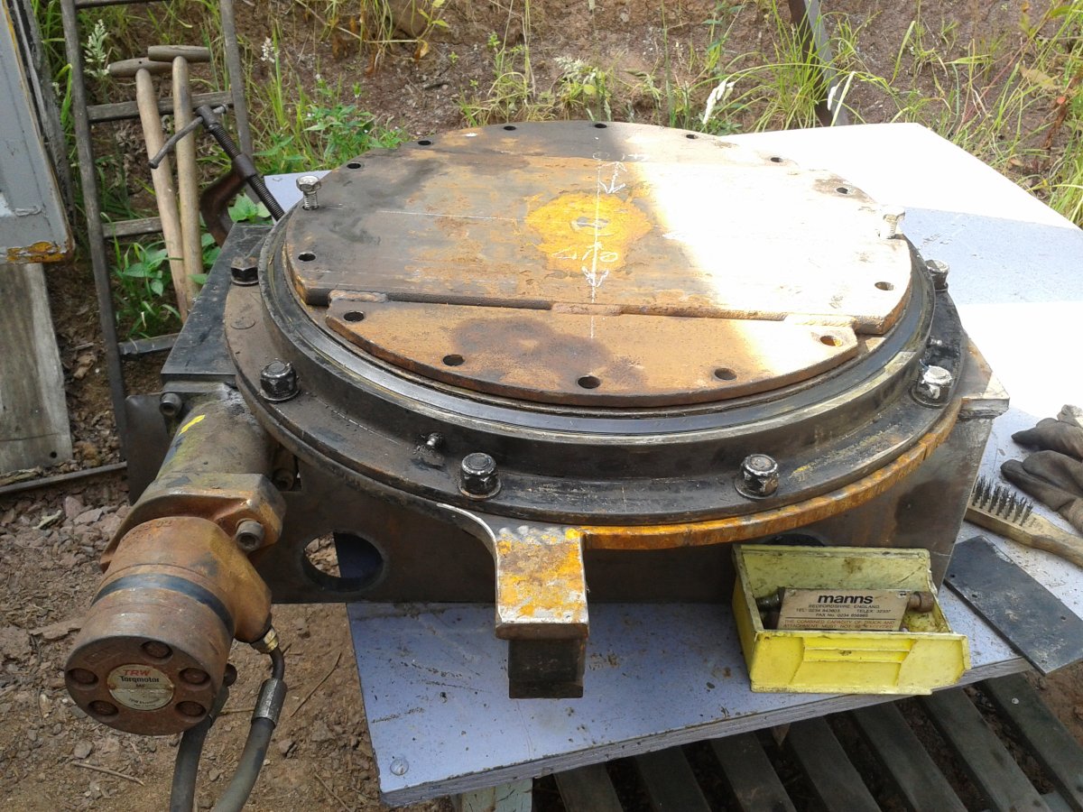

I was very lucky not to do more damage ....... dropped the bucket where I stood and came down off the digging level to strip off and drop the hitch and then the bottom off onto the bench ... was lucky not to damage any plumbing

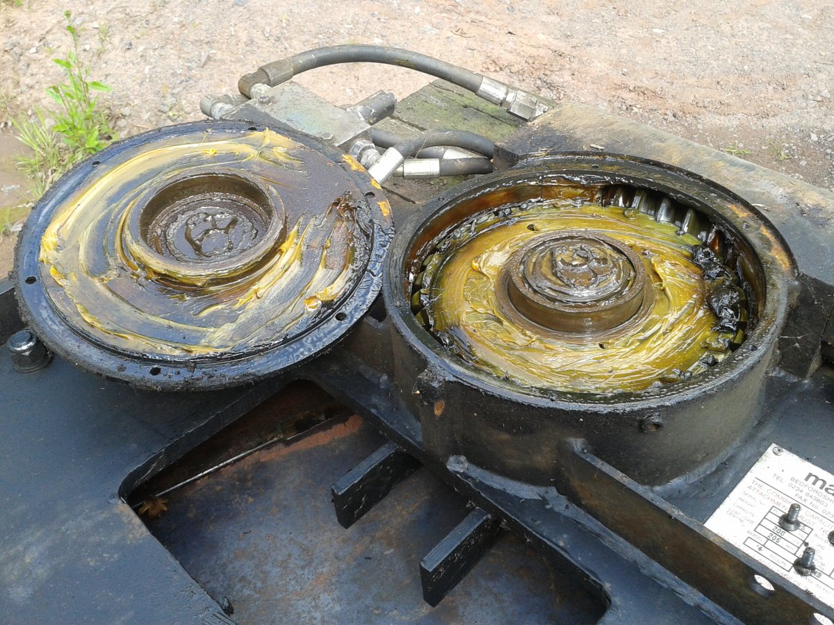

and inspect the damage

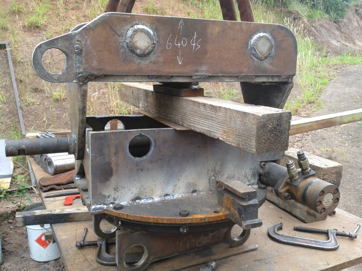

8.8 bolts ... 10.9,s might not have let go? .. 's what went back in... these sure stretched to breaking

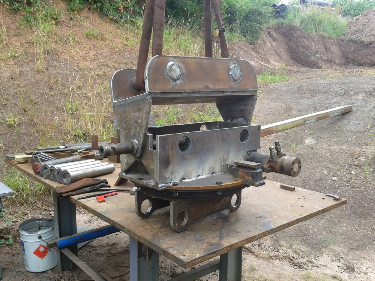

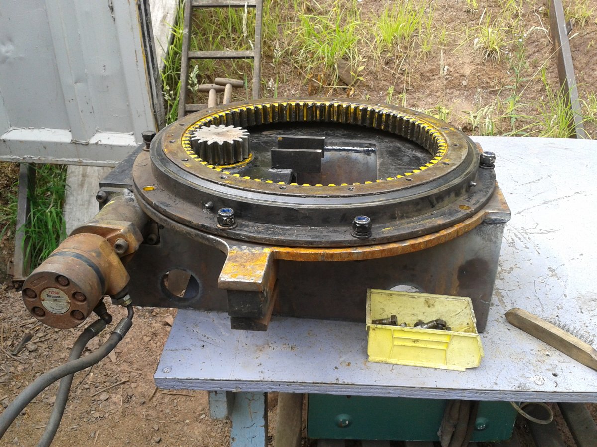

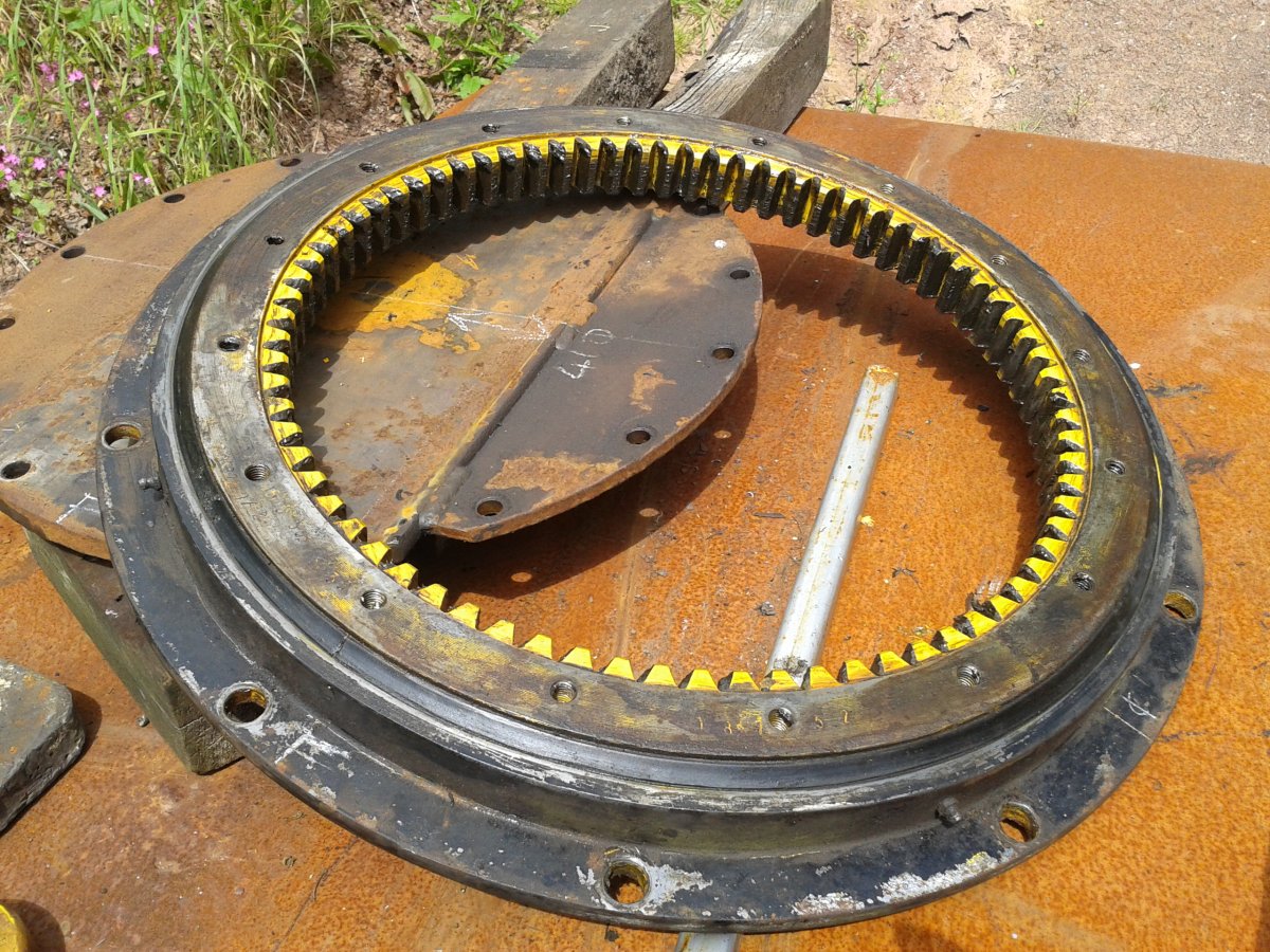

so . ring gear off for starters and park the remains on the bench

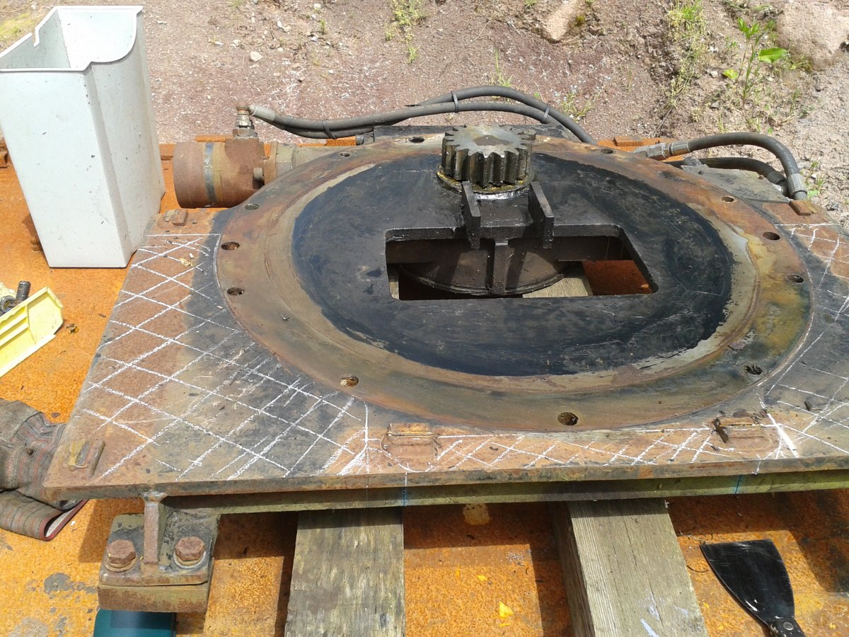

View attachment 55057 View attachment 55053

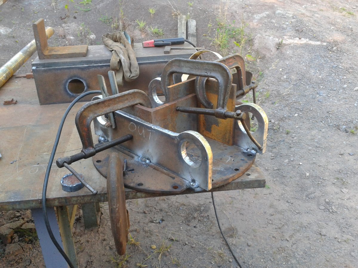

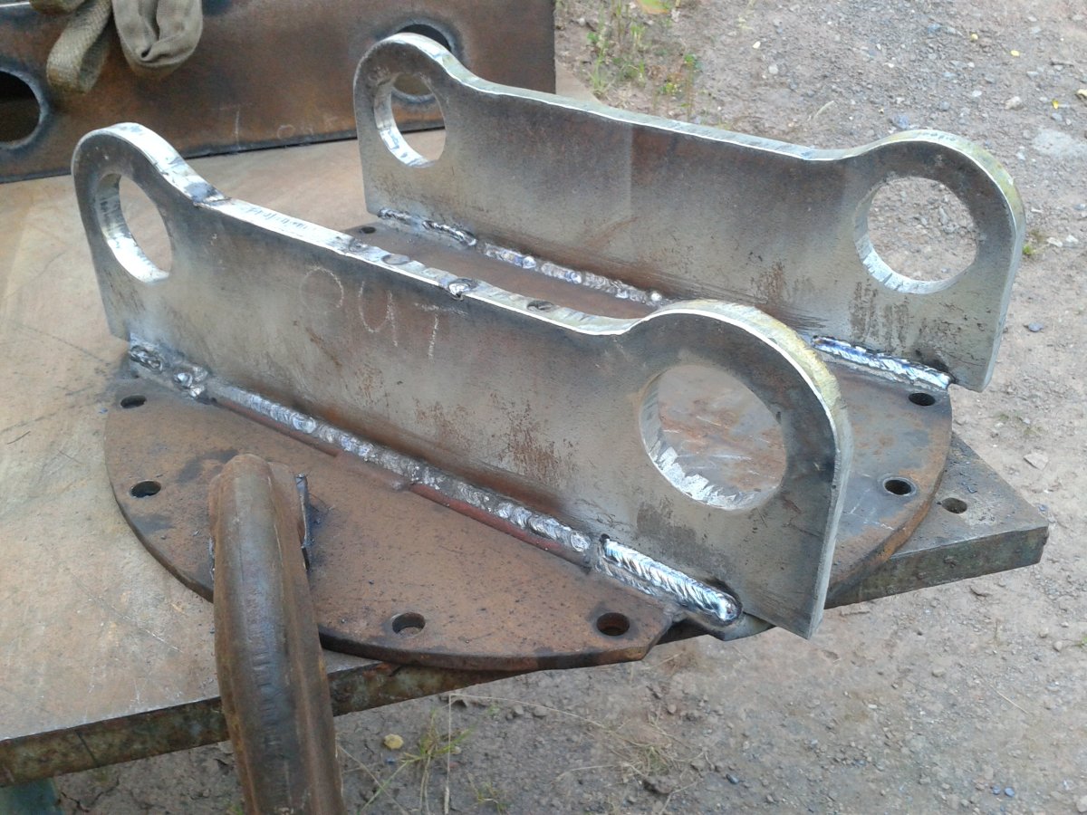

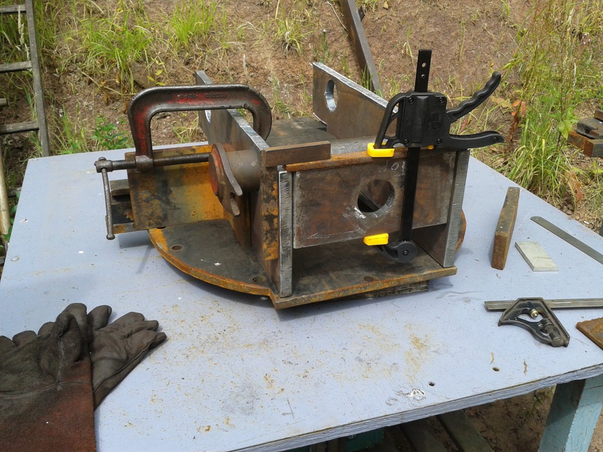

then clean off the lower plate wings

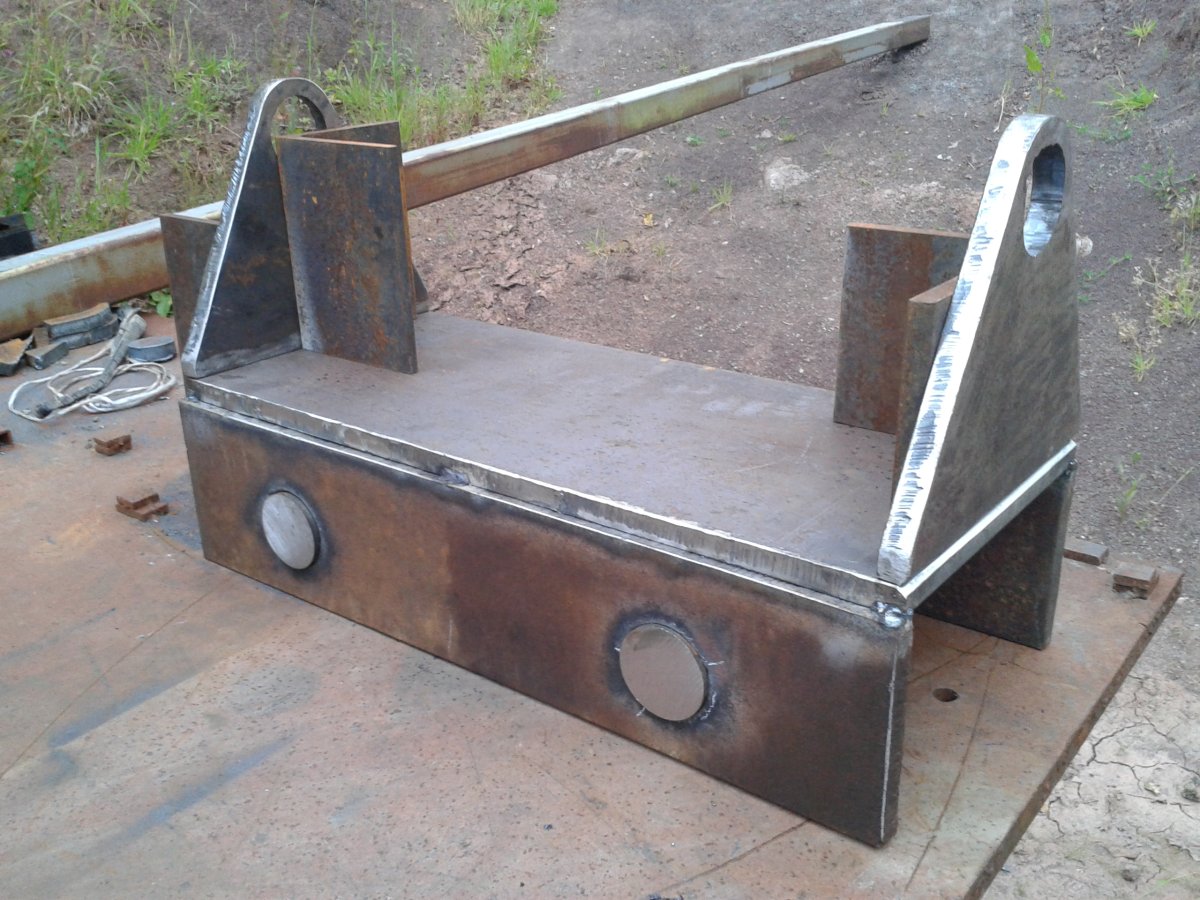

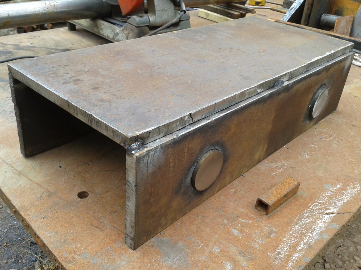

and cut off some of the welds (that I should've added to massively, but forgot to ) the stress on these originally was in a completely different plane .. 's no wonder they tore off when the bolts let go

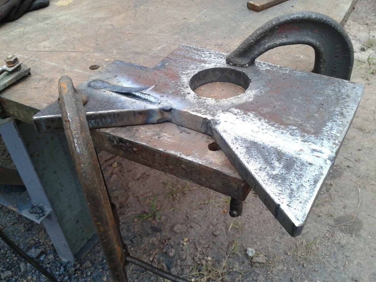

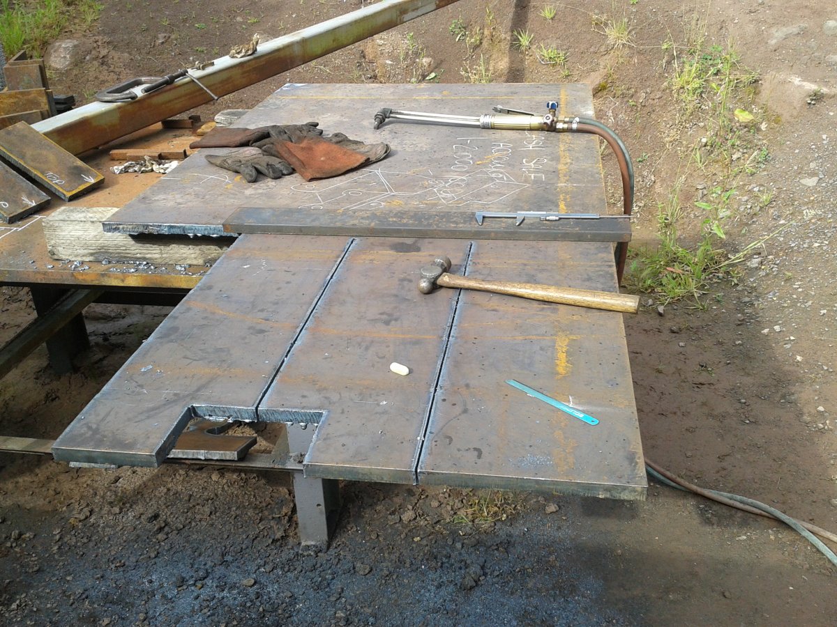

next was beat seven shades out of the bent 20mm piece

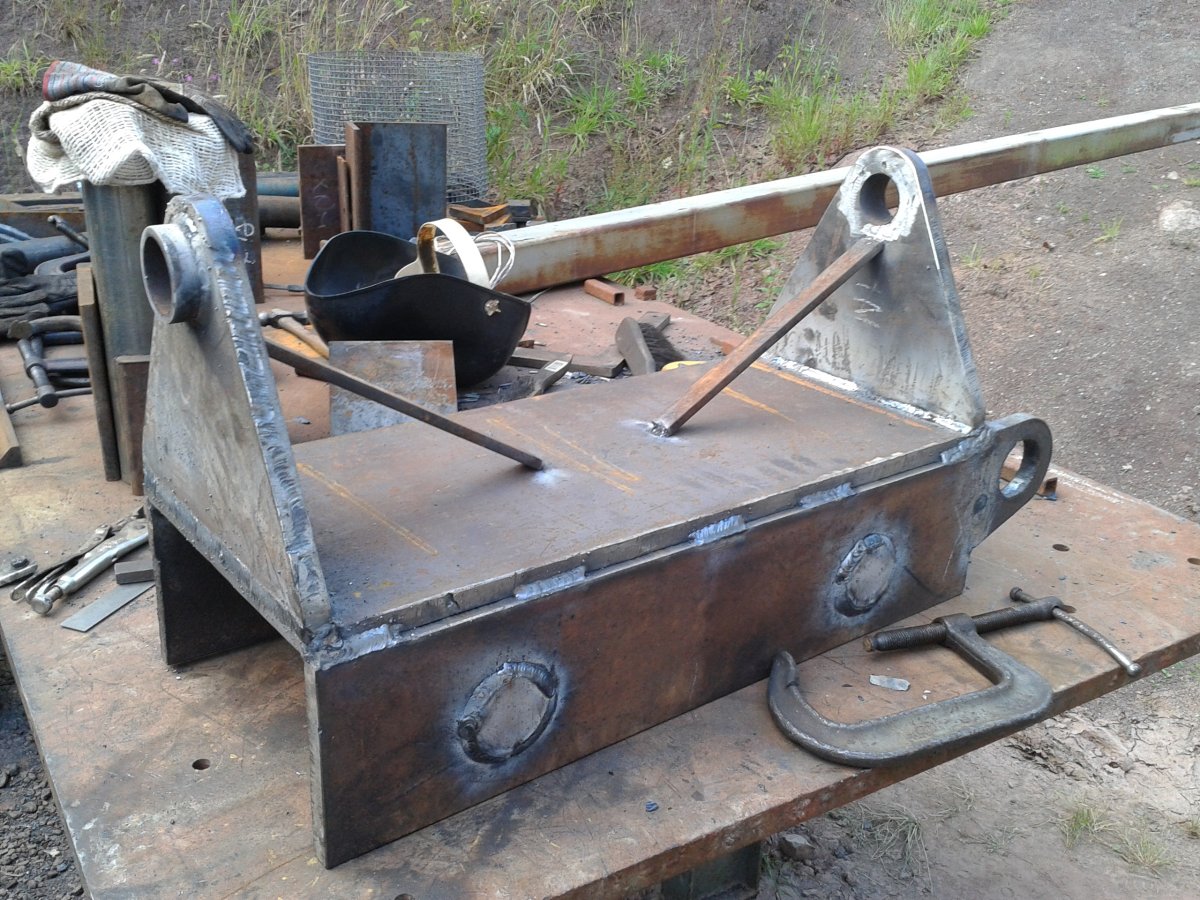

having gotten it securely bolted down to a very solid bench top .... then get the cleaned off wings back in position and clamped down
ready to get welded back together - properly
this is either going to turn into another epic - or I'll start another one DaveyYes add in as many build threads as you can please

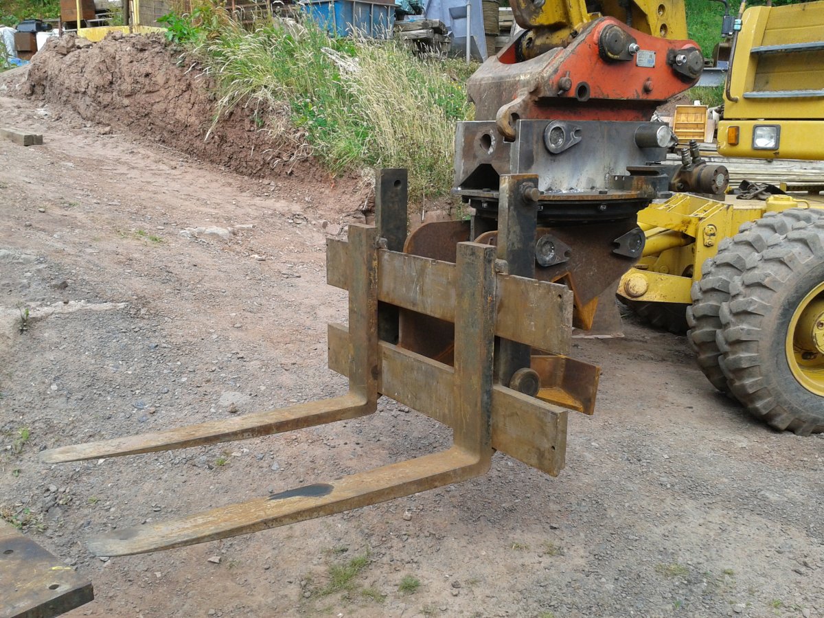

I did think the tilt did look a bit heavy on the Drema, but at least you have a few granite sets to park her on!so that's about it guys .. don't think I've done much to it since and done a lot with it ... forks and grabs is where it really comes into its own for me
came off the pile on the left.. the whole pile was a bit muchso split it to move it
