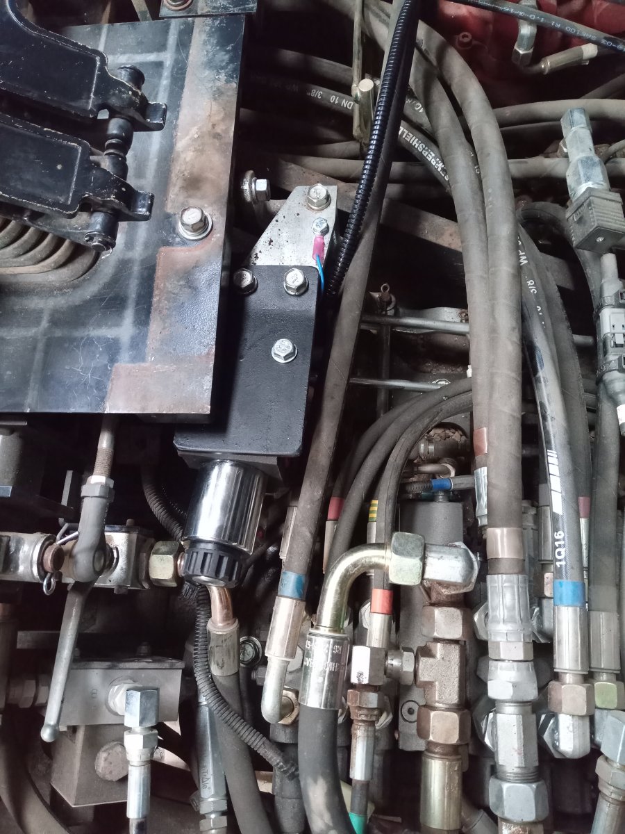

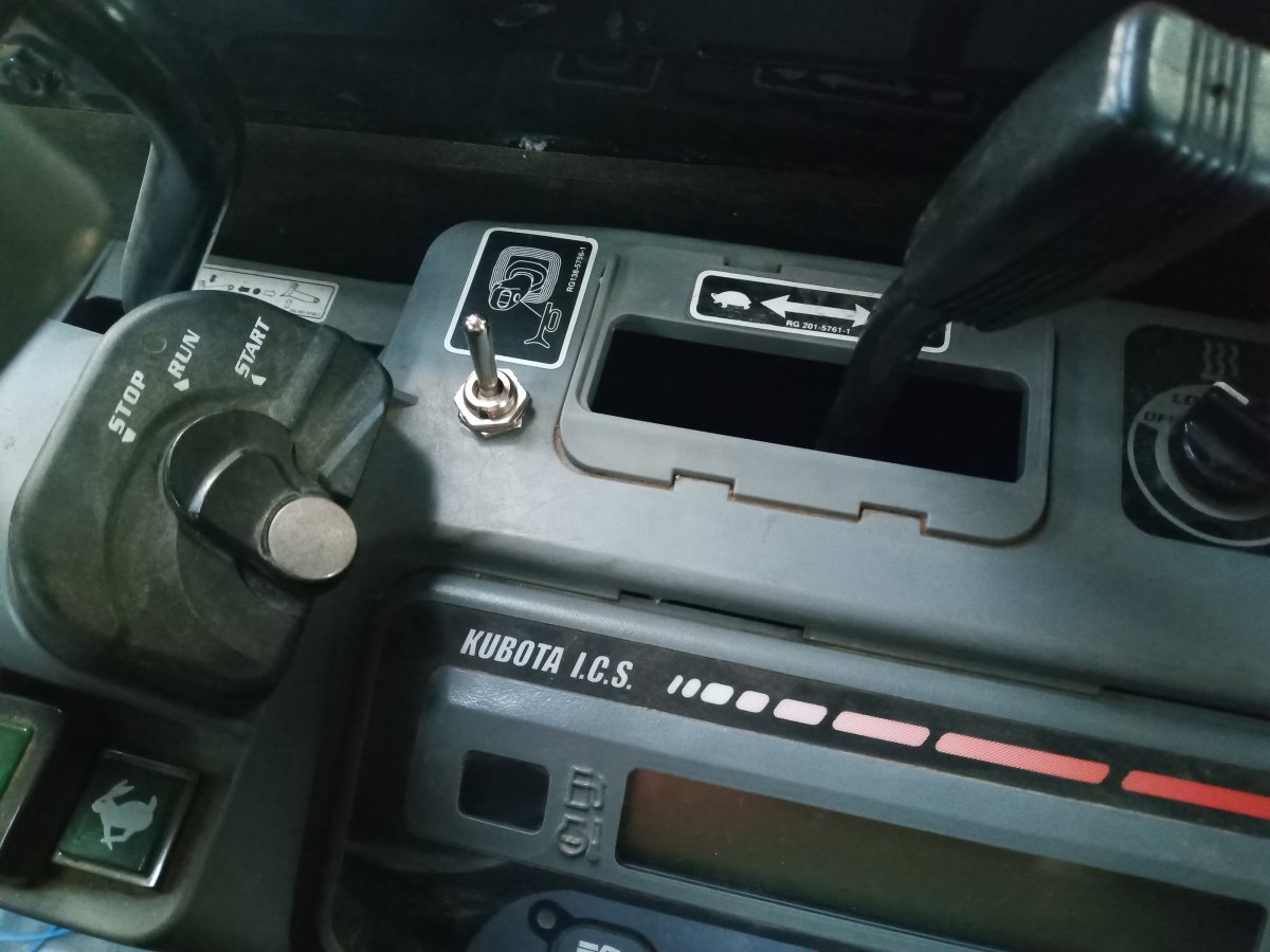

Hi all, I'm looking for a bit of help with how to wire in a solenoid diverter valve to my Kubota kx61-3.
The plan is to fit a diverter valve to the hydraulic piping for the offset ram, so that I can switch between offset and tilting hitch on the rh foot pedal. This leaves the left hand foot pedal free for the standard aux circuit to be used with the tilting hitch still functional.
I'm confident enough with plumbing in the hydraulics but a bit stuck with the electrical side of things. My main concern is if I run a pos cable from the battery to the solenoid diverter via a switch, the solenoid will stay energised with the engine turned off if I forget to switch it off. I.e. I'll end up draining the battery on a regular basis.
What's the best way of tapping into an ignition live? I was optimistically hoping to use a spare space in the fuse box under the seat, thinking that there was a common positive but it looks like each fuse has its own positive so that won't work.
Help very much appreciated
