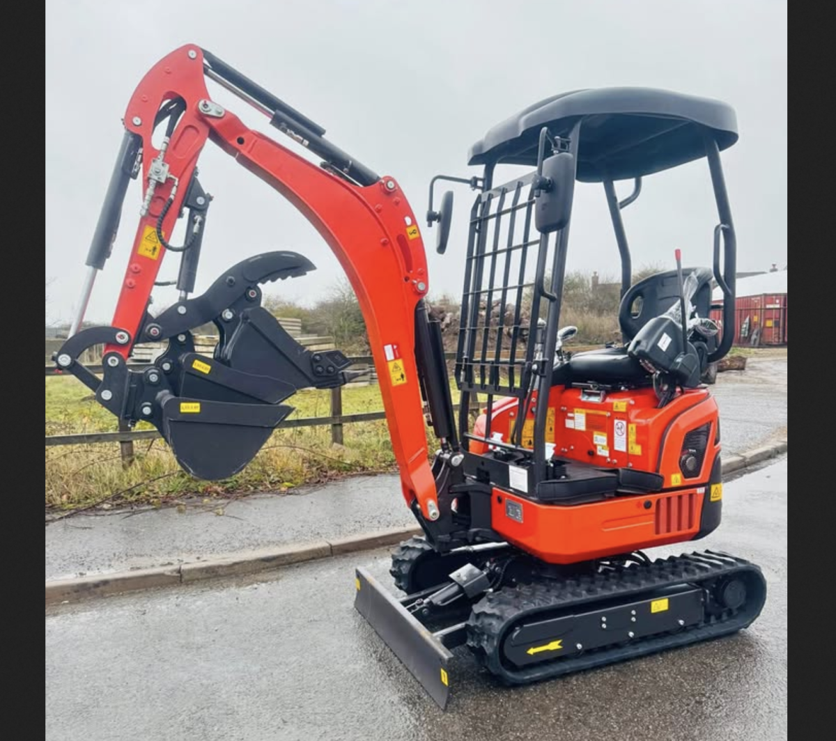

Hi,
Sorry for what is no doubt a very basic question, but could anyone tell me whether the minimum distance that a bucket can reach towards the blade is of any importance? I'm referring to the distance shown (hopefully) in the image I've added below. I've just viewed a mini excavator where that minimum distance is about 800mm, which my dad claims is too far as the bucket should be able to push up against the blade to help load the bucket up. Is that true?
Many thanks,
James
Not all clear up against the blade but it’s proper handy if they do.
800mm is masses though. Way too much working envelope lost. Any photos of the machine? Could be an oddball hitch or just a Chinese machine with s**t geometry! Got a link?
blackhorse
Is the cage on the front to keep the victim, sorry operator, from presumably realising they have purchased a lemon and jumping out the front into the path of it?
That would have been the first thing to come off! :)
Thanks, guys. On those comments alone it sounds like my old man is right and I should give it a miss. Much appreciate the input.
James.

Alot of variations. Some machines have long dozer blades or dippers on the digger which improves it. I think zero tail swings generally not as good as the whole body of the digger is further forward on the undercarriage which limits bucket to blade clean up..

Looks like I guessed right!
Avoid the Chinese tat. There is lots of secondhand mainstream kit around currently, what’s your budget?
incredibly short dipper ...... unless you wanted to fit a tilty :ROFLMAO::ROFLMAO::ROFLMAO:
