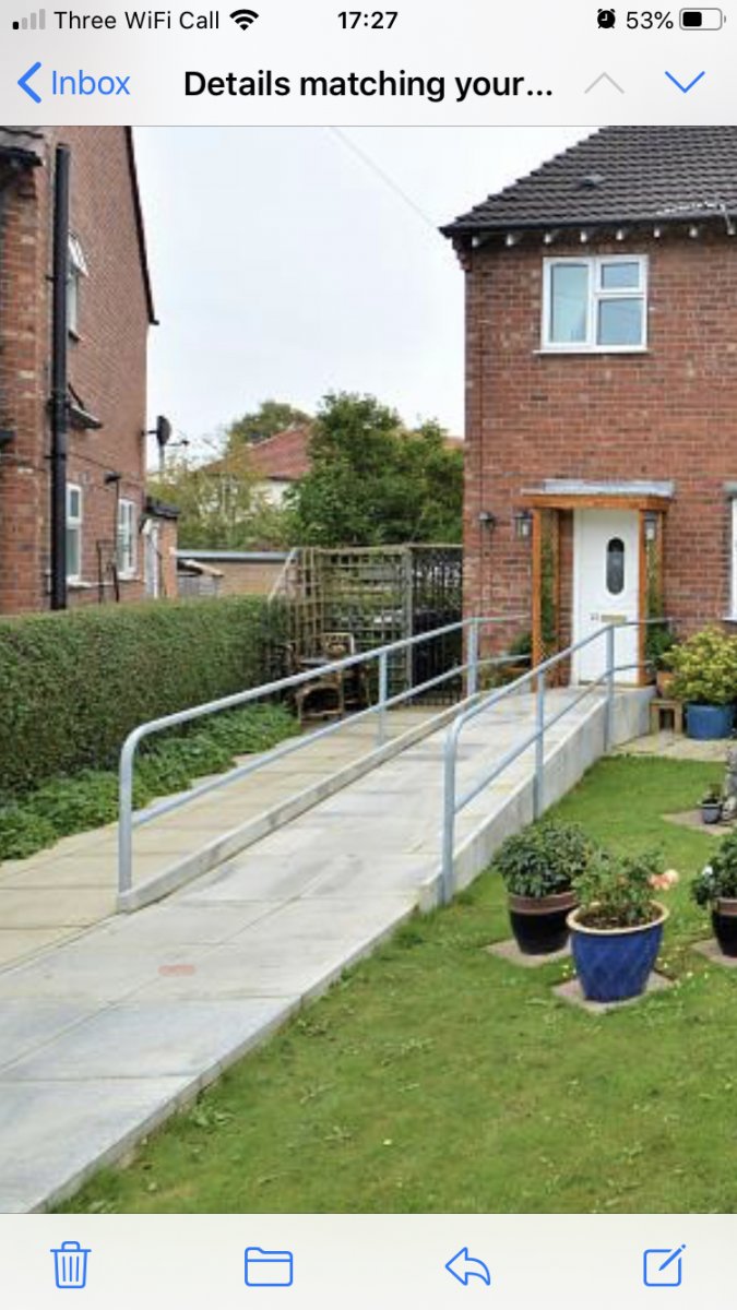

Just had this property emailed to me, what’s up front but a whacking great disabled ramp... 😎
