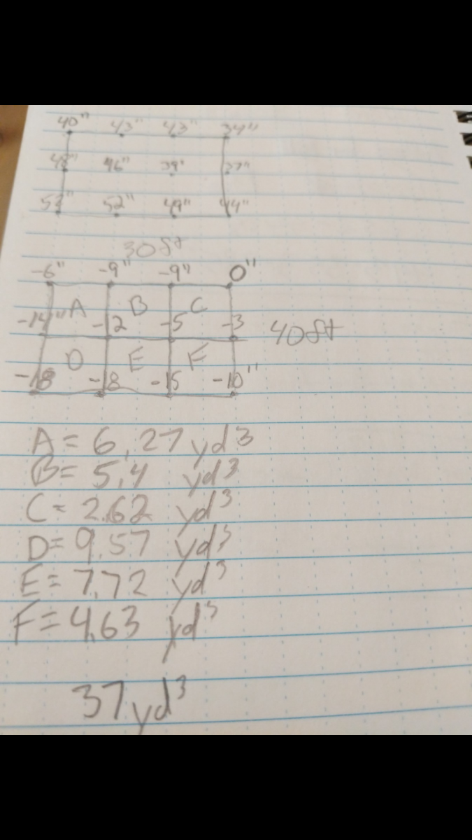

Did some math for prepping a slap in a sloping backyard. Had to use the eraser a few times. Lol. Yard drops 11" over 30ft.

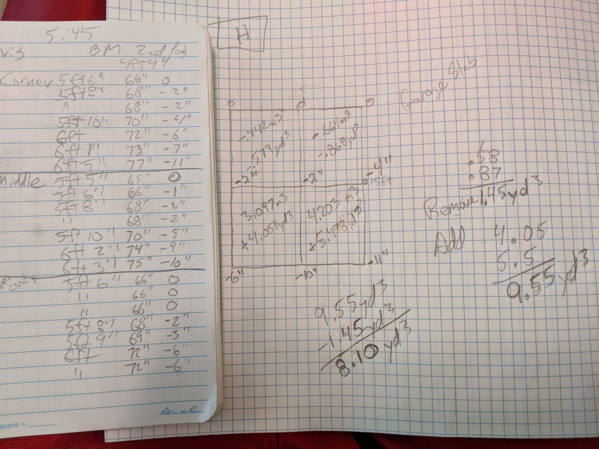

Sorry about the confusion. The math earlier in the thread was for the amount of fill dirt needed to raise/level the area. The concrete pad is going to be level.
Here is a new one I mapped out/calculated to fill a low spot in a neighbor's yard.
