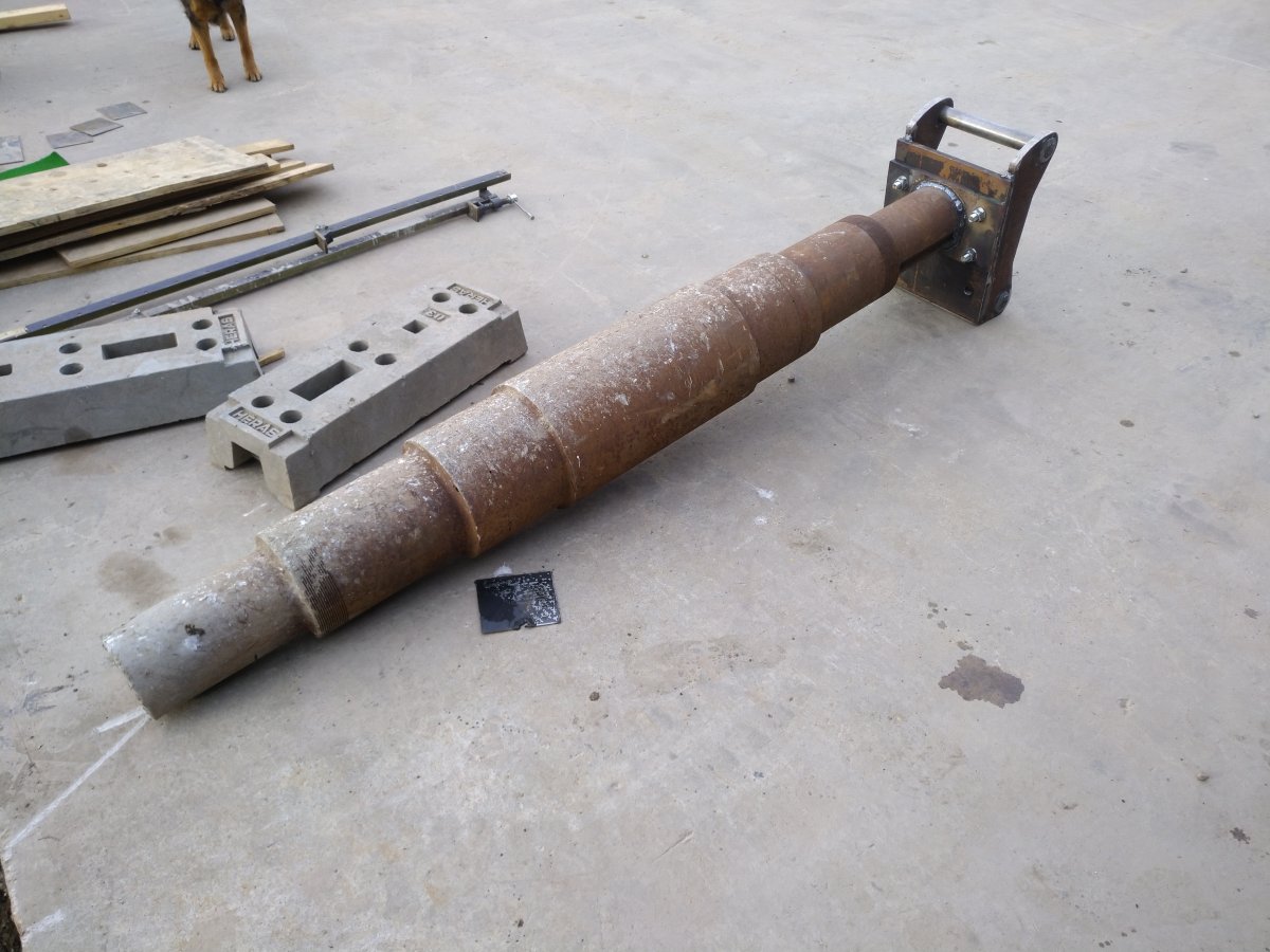

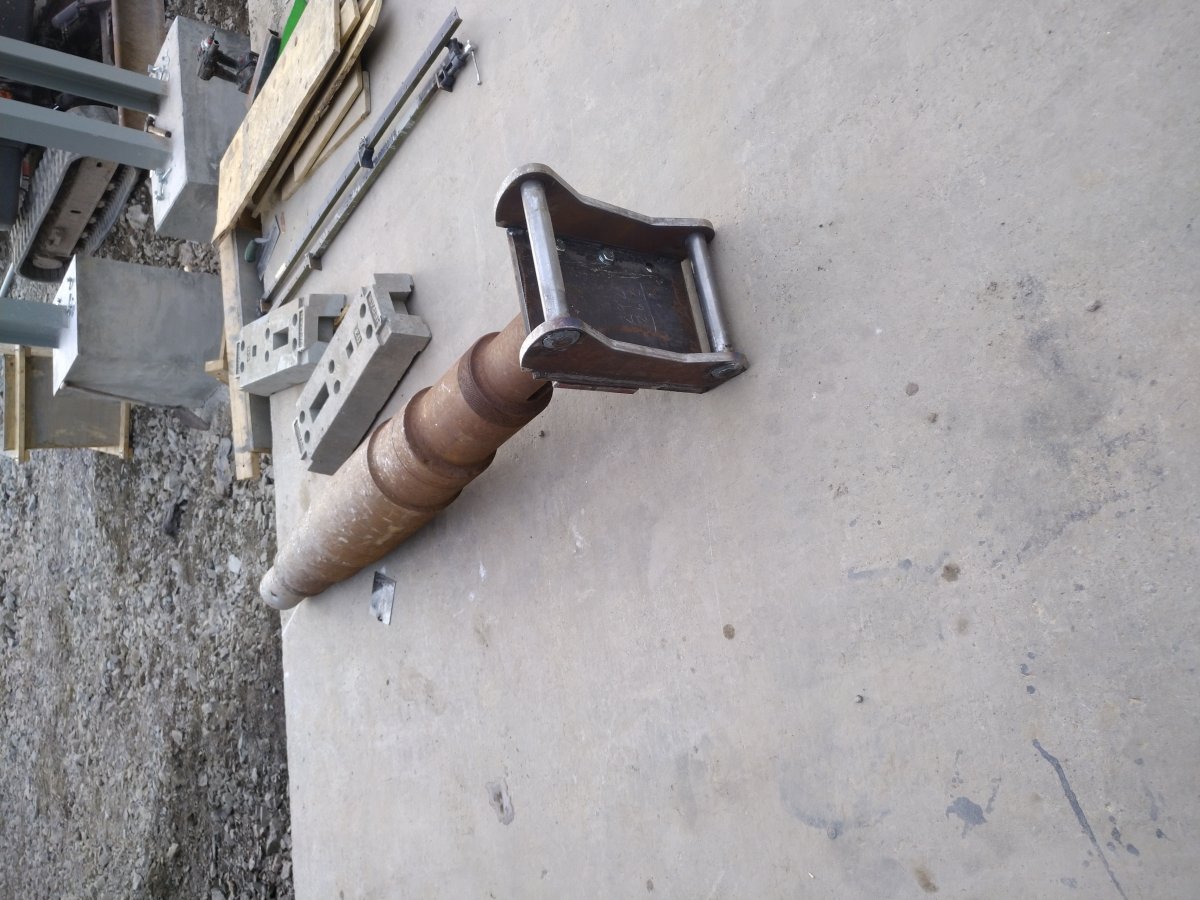

Made up this d e as weight rammer to get the job done. Seemed to work well 😁
Looks cumbersome and very hard on the machine. Don't fancy those welds' chances either- lot of leverage and impact stress on them.
Surely you just end up punching holes in the ground?
Wouldn't a more square weight on the end of a short chain have been better?

Just had one purpose which it done very well, had a small pocket about a meter by 2.5m that was up filled approx 1.2 meters with 6" crusher run and didn't get compacted in. This thing put it all down about 8 inches. If it had a bigger base it would not of had the point load required to get the lower part of the pit compacted.
