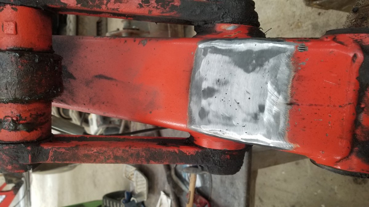

This Kx71 has slowly been suffering.... when the bucket is crowded right out it taps the dipper, not had the old machine long but thought I better prevent it getting worse or knackering end of stick.
Plan is a little bit of plate welded over the area..... any tips from you fabricationally gifted chaps before I do it ?
DON'T DO IT!
Change the bucket or quick hitch or adjust the pin spacing. That will make the underlying problem (flexing the dipper nose) far worse, and you'll have the whole lot drop off before you know it due to metal fatigue.
DON'T DO IT!
Cheers Doob
Thankfully Yes....bit more thought and I stopped short of doing it.
Going to build a bit of meat back into that area?and investigate how we can stop it tapping there
It's a kx71 that has had a jcb 803 hitch on all its life - there must be some difference in the spacings although I seemed to remember they were the same.
Like I say haven't had it long ... bought of a mate in the u.k as a stopgap/spare (yard machine).... I have always been under the illusion he took care of his kit .... this view is changing 🙄

After you've reinforced it, is there any way you can limit the travel as the plate will make the contact worse
(a collar on the ram shaft perhaps)

Show us a pic from the side with it touching or almost touching?
Pin spacing on the hitch must be far too close. Be good for bucket crowd angles but must take a lot of breakout force off it. I'd be looking to change hitch or if you don't wanna spend but have time modify hitch
Bit of a brain fart from start to finish.
Been flat out jumping from one machine to the other and not noticed the fact that it's actually damaging the dipper quite badly, turns out that the two manual hitches that i have are actually 125mm and 130mm centers - thinking back a few weeks i put the 125mm on the machine because it picks up all my buckets and the 130mm will only pick up half of the 6 or 7 bucket set .... anyhow the 125mm is too close and as the lads on here said (y)and its enough to bang into dipper as in the previous photos.
Anyhow luckily I stopped before it had knackered end of stick and then Doob jumped in quick enough to stop me rushing about bodging and actually find the cause of the problem 👌
Filled it up and ground it off - bit of paint and all should be good.
Filled it up and ground it off - bit of paint and all should be good.View attachment 16474
assume you filled it with weld Kev, not Holts??
Ha ha ... now I know I'm no Druid ..... but give me a bit of credit Graham 😉
I filled it with weld and ground it somewhat back the original profile..... was that the right thing to do ?
