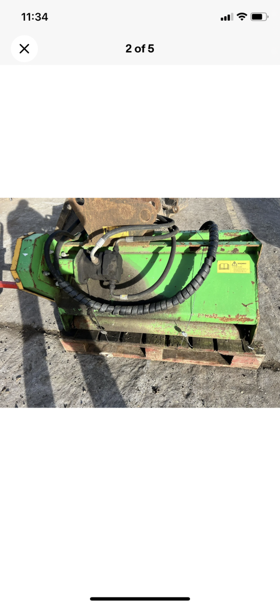

Hi guys I'm new here so please take it easy on me 🤦🏼😂
I've got a massive headache going on with a digger flail that keeps blowing out the seals🤬
I've had a look on here but it's going pretty much over my head so can somebody please simplify how to make this flail stop blowing out the seals?
It's got 1 feed and 1 out,same thing on my digger

They just do mate, even with a case drain and cross line relief.
Basically I think it's nigh on impossible to get the cross line relief set just right so that it won't bypass under load yet the cross line relief does it's job when you let off the aux. I've given up and I know a couple of others on here have too. Diggers don't make great flail carriers anyhow.
The cross line relief basically absorbs pressure spikes generated by letting off the aux flow but the flail rotor of course wants to keep spinning! These pressure spikes are what blows the seals.

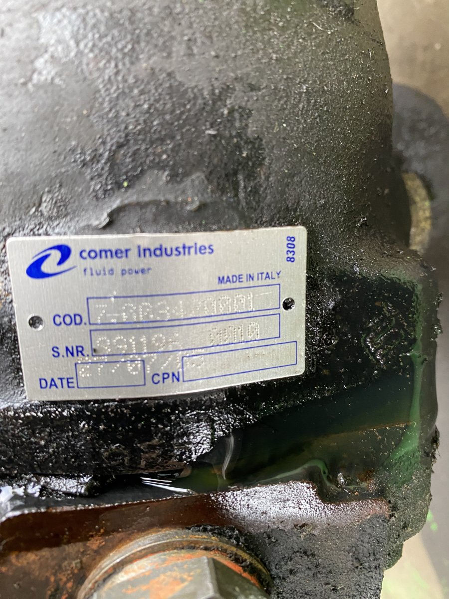

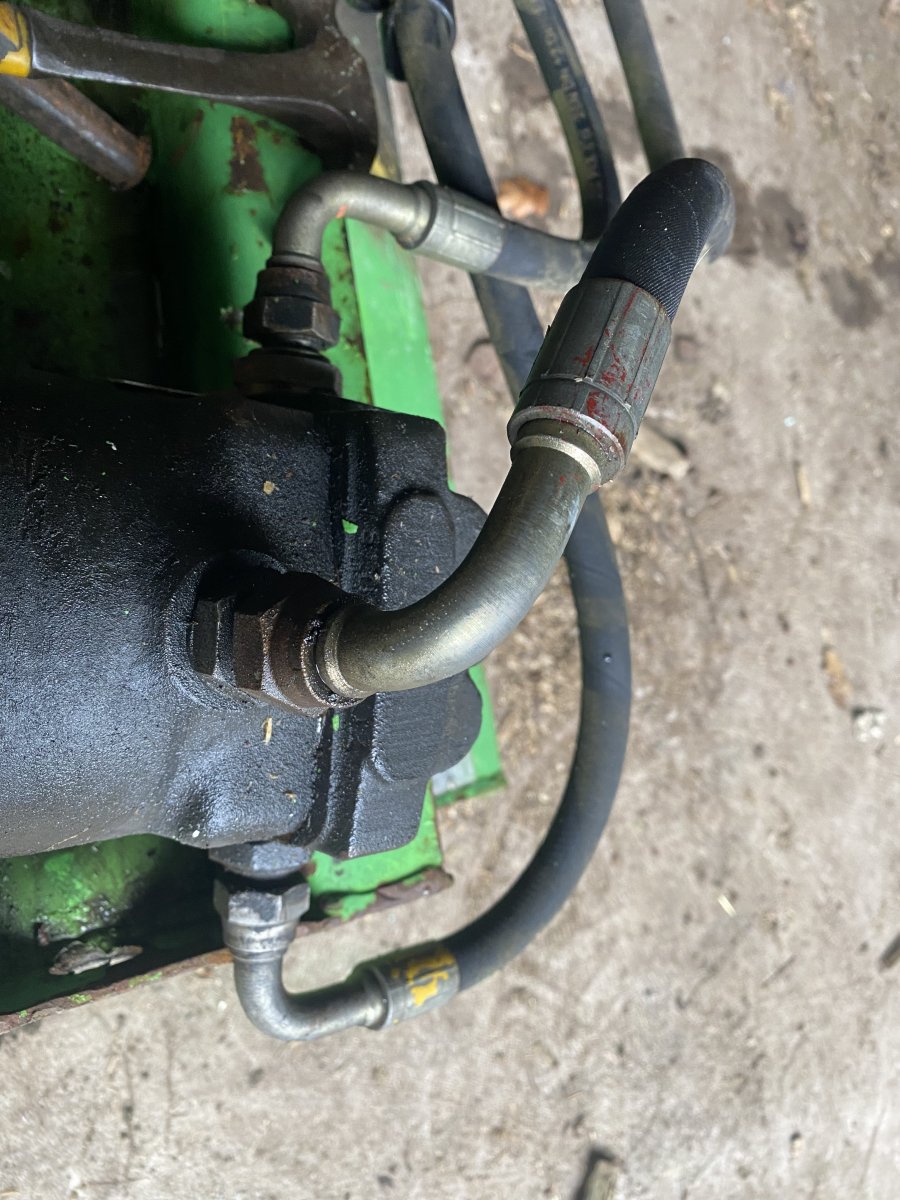

oh.. and a free to tank case drain line'd be a pretty good idea too ... that'll have enough resistance already, having to 'climb' the dipper
the case drain looks to be the top hose on the motor's body ... the other two ports on the back end of the motor should be labelled P & T (hopefully)
as the guys say the T line ideally needs to be an unrestricted, free flow to the tank ... if it's going back through a valve block of any sort, there will be an inherent resistance there somewhere

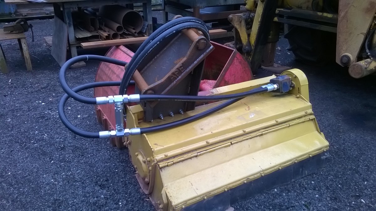

when I mounted Alex's Bomford up for his Mec, I achieved the CLRV by simply tee-ing a NRV into the lines, allowing the oil to flow in a closed loop from the motor's ports when P was no longer feeding the motor, until it ran down to zero rpm
P pressure kept the NRV closed, until it wasn't pressurised, at which point the closed loop operates ..... worked well
