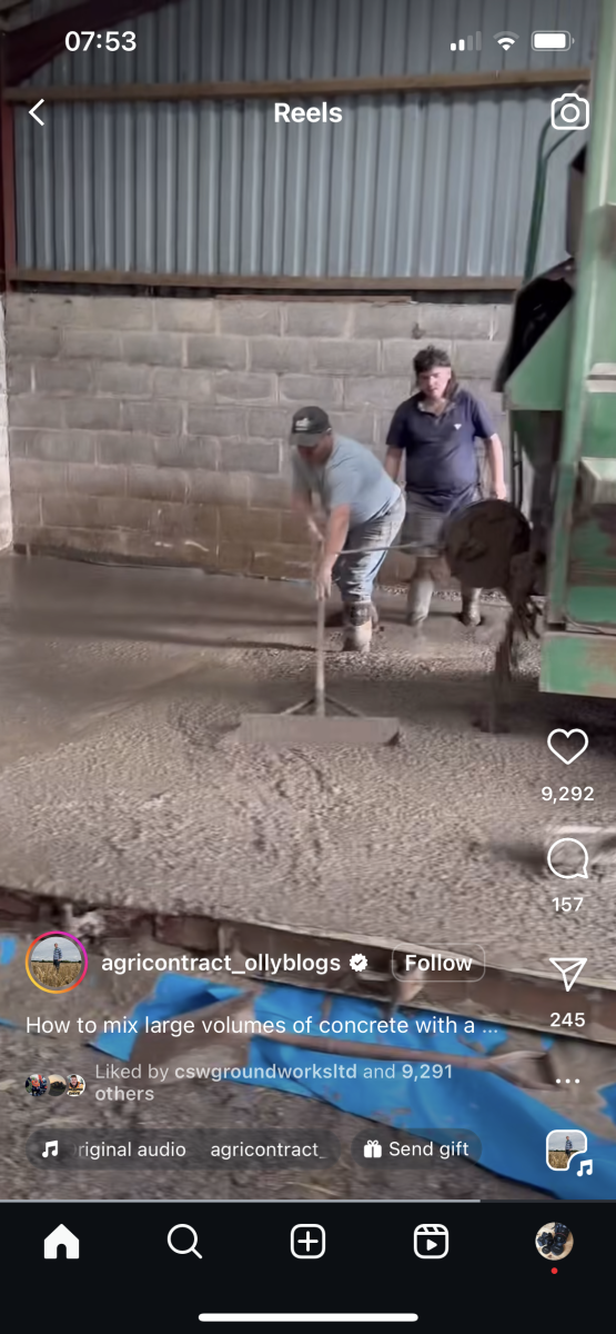

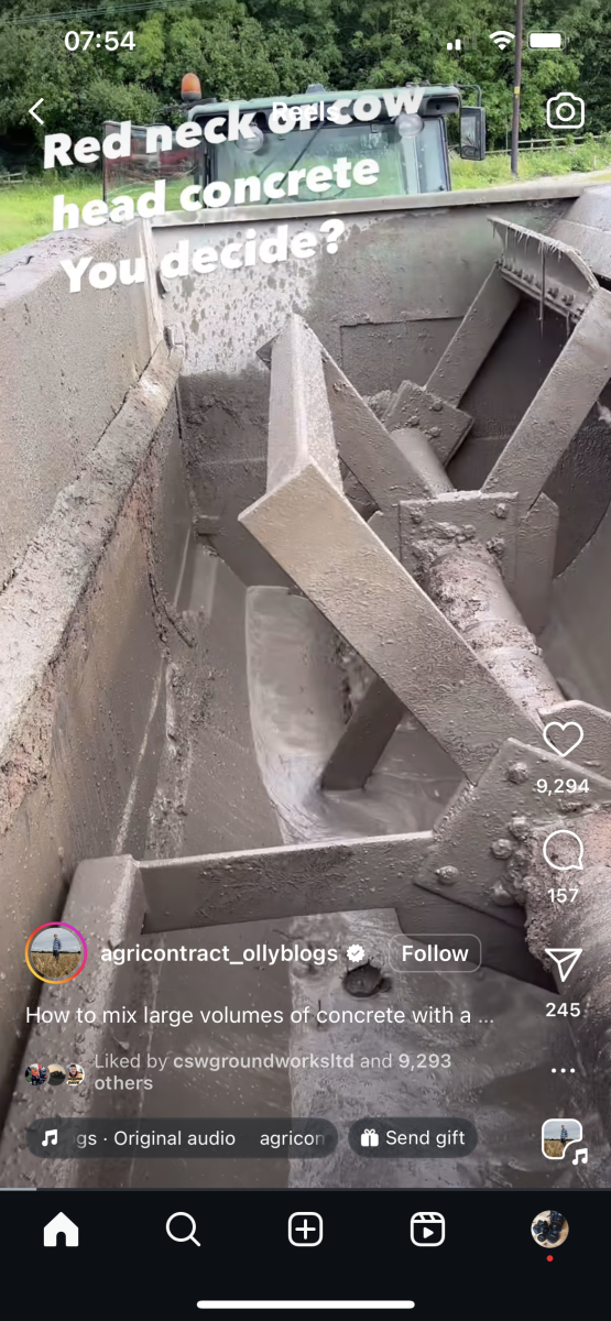

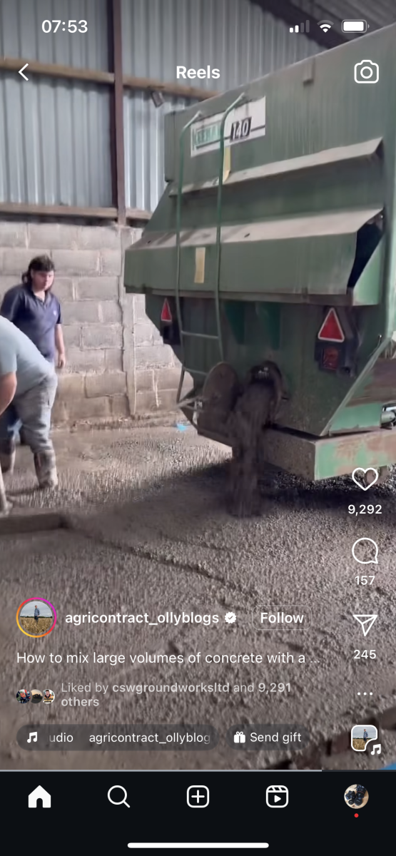

Apart from too much water can’t fault the idea
I don't think the paddles go close enough to the bottom to get a proper mix. I would be worried you will get cementy water at the top and neat sand /ballast at the bottom
Probably wouldn’t take much ‘tuning’ to get it mixing better - bit of simple fabrication to get one paddle sweeping lower would be enough.
