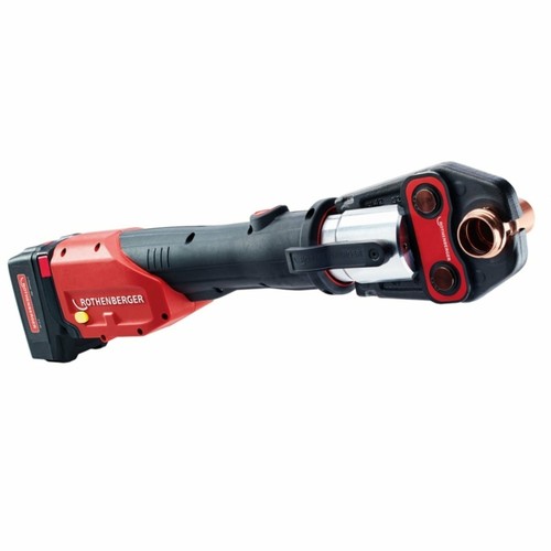

£1400 for a tool you’d use every day doesn’t sound much to me tbh…
Millionaire plumbers’ day rates are massive - spending a bit on tools once in a while to offset a bit of tax can’t be the end of the world surely?!

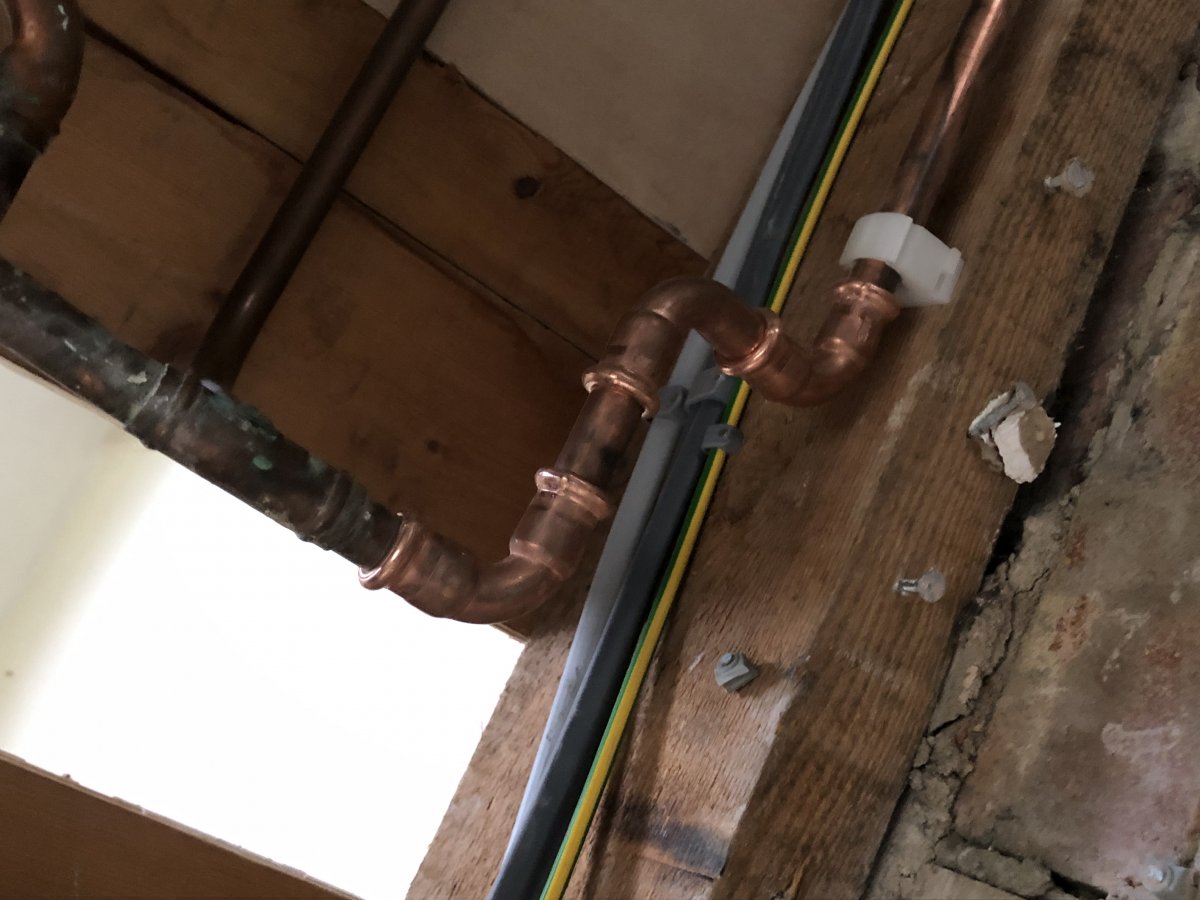

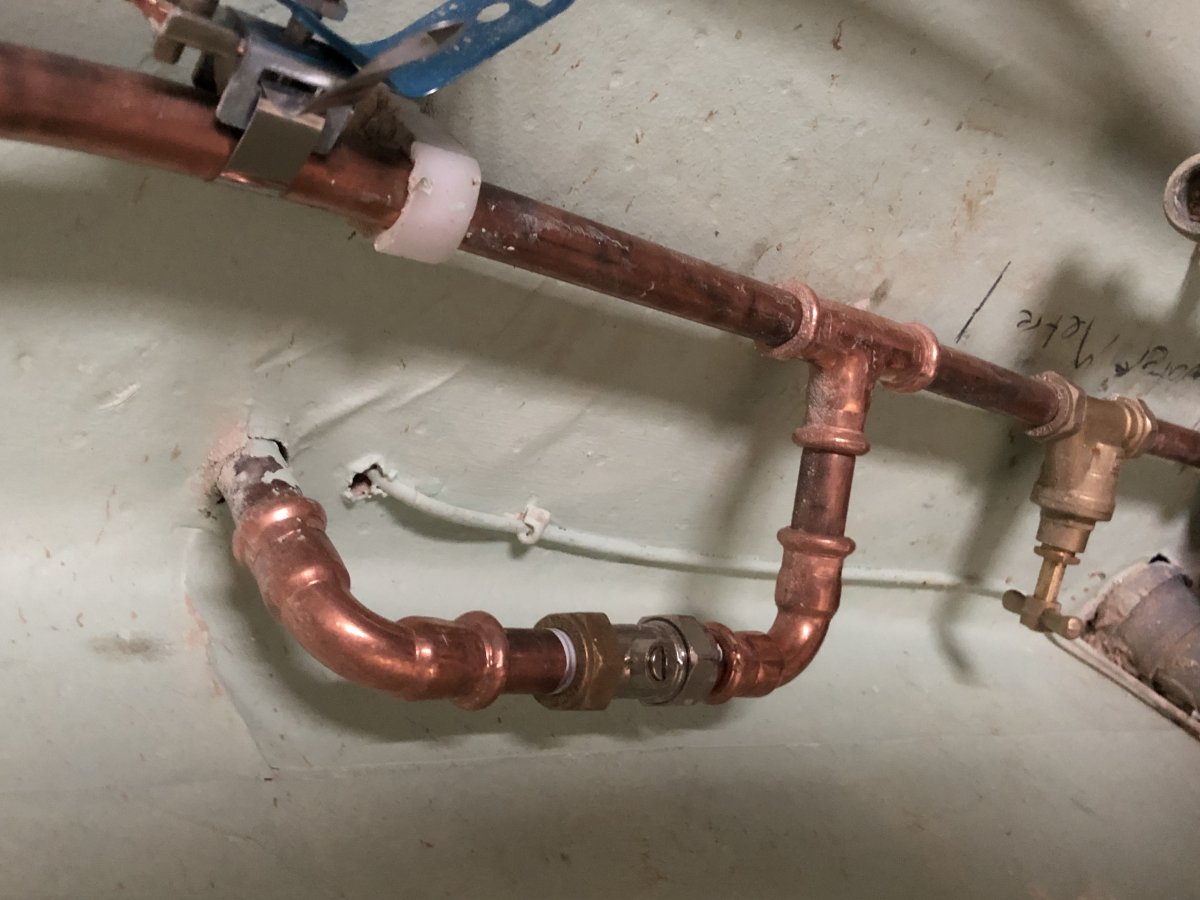

But then my blow lamp is £100, tub of flux £10,roll of solder £20 and fittings much cheaper. Don’t get me wrong, I’m not against it but probably more beneficial in plant rooms etc. Whenever I’ve seen it used domestically it just seems like they forget how to bend pipes and it’s all 90elbows and sockets
I fitted some stainless press fit in Chatsworth house as they don’t allow hot works, I was just a subby so don’t know what it cost!
As an alternative to hot works from my (layman’s) perspective it looks the best solution, and I’d have thought would command a small premium to cover the additional fixings costs on jobs where it’s necessary?
Surely a plumber must be able to bend pipes and solder though - if those skills are lacking then what is the point of employing them? I plumbed my last house with a mix of plastic push-fit and copper (where you could see it) and I taught myself to solder and bend pipe. I certainly couldn’t make money doing it but I’d like to think if that’s what I did for a living I’d get pretty decent at it!
I’m sure it will become more common, and yes it does look a good alternative once developed. The trouble with it currently is that there isn’t a set standard across manufacturers. Whilst the copper pipe is 15/22/28 etc, there’s a few different profile jaws depending which manufacturers fitting you’re using (U/M/V) Then some of the fittings are water only, some are water and gas.
You would think pipe bending would be a required skill but when using press that seems to be forgotten!
