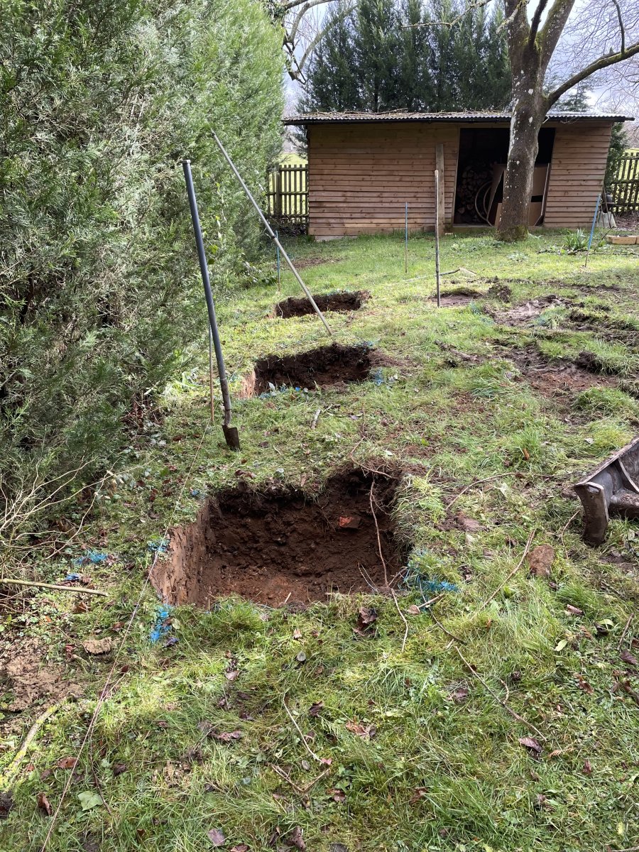

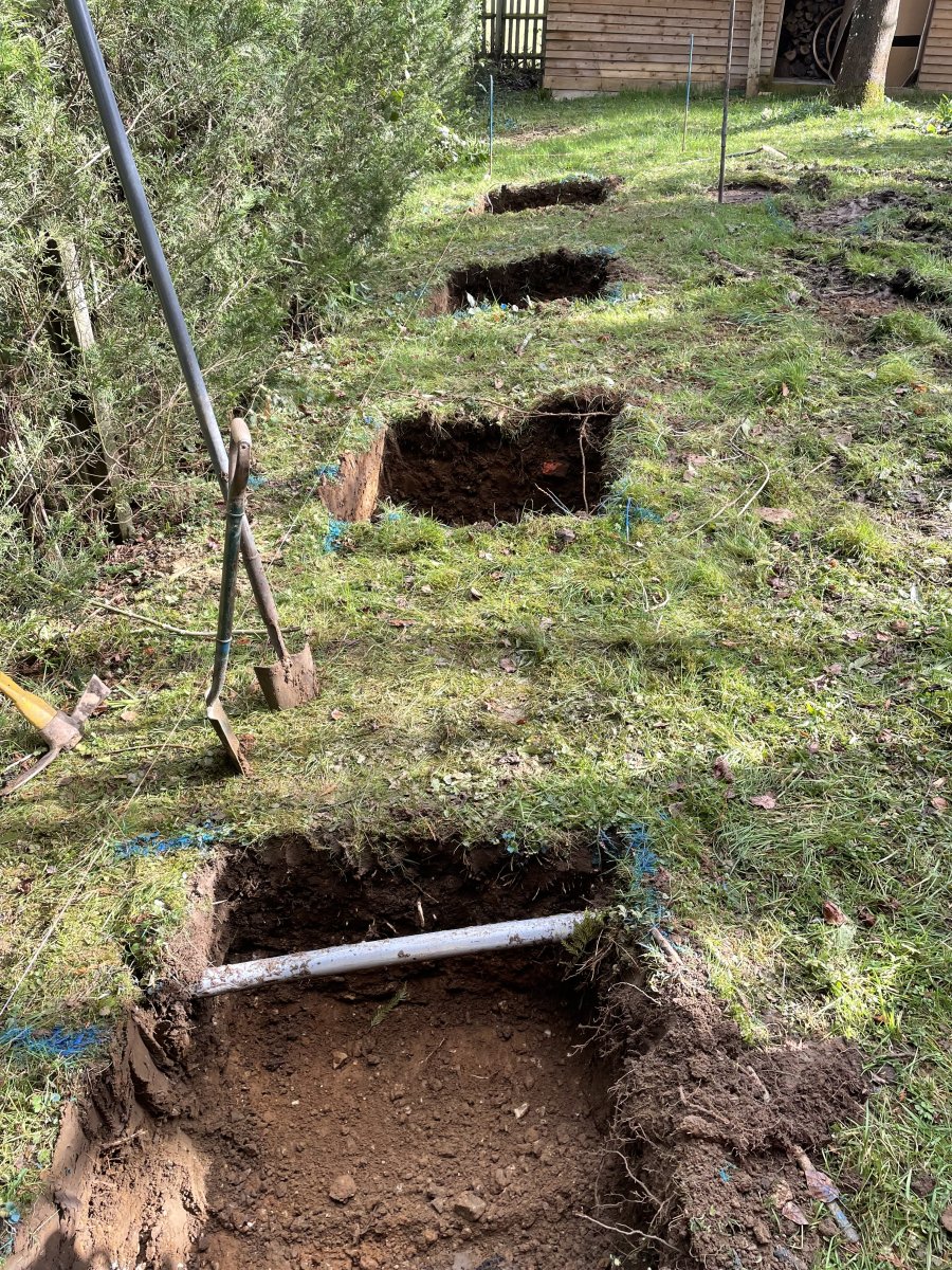

Topsoil off, then 100/150 mm of type1 with big wacker on it 👍🏼
D DaveDCB Well-known member Nov 14, 2024 #21 Topsoil off, then 100/150 mm of type1 with big wacker on it
V8Druid do it as well as you can,but learn to do it better Nov 15, 2024 #22 Jimoz said: What would you dig out below the conc to get a good bearing 600mm strip down to decent ground then fill and compact with stone? Click to expand... my tall plinths were sat on 6" of compacted planings on top of ground excavated down to a solid base ... and again, as said, ain't moved a mil in ten years

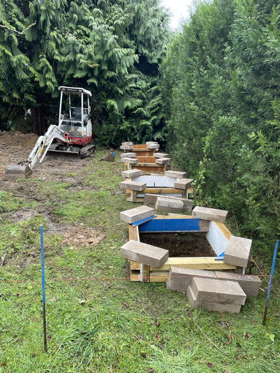

Giles Well-known member Nov 15, 2024 #23 Flat top concrete Lego block dug in to level/ height you want them 1 would bridge 2 x containers or go the hole hog and put 2 lines of them in?
